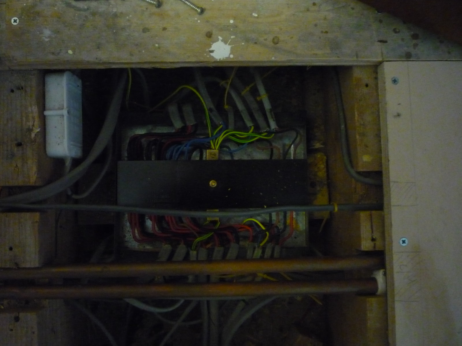

Due to Covid-19 my plans to get someone in to rewire the house have stalled, but I am continuing with moving a wall myself.
Currently this wall has one double on the ring, with the new wall in place this will become three or four.
Originally my plan was for the rewire to change the ring final to radials (one for kitchen, one for rest of downstairs) mainly due to the fact that most of the new sockets will be at the far end of the house.
Should I wire this wall as a ring final, or could I wire this as a spur in 4mm² without using an FCU? (It was going to end up as a spur anyway)
