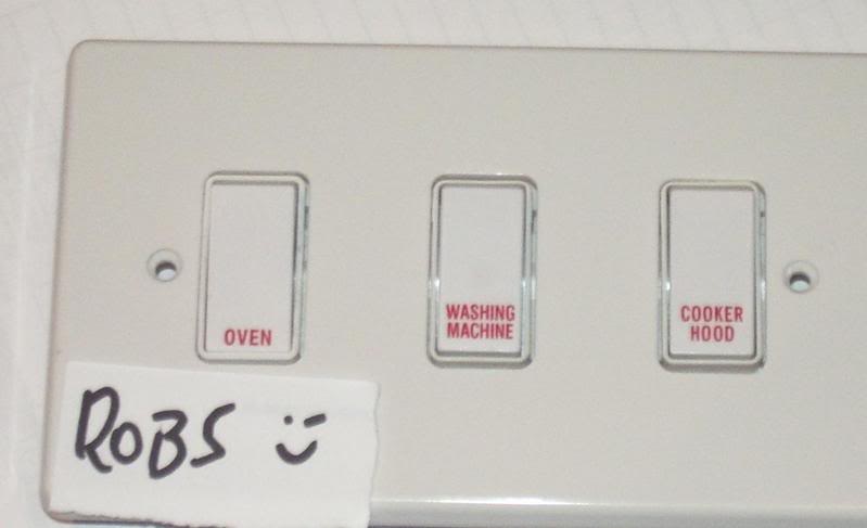

It is becoming normal practice (fashion) to have FCUs above the worktop for the appliances below.
However, if you don't want them you don't have to have them.
It may be a good idea for switches there to isolate the appliance in an emergency but the fuse isn't really necessary as there will be one in the plug.
I would suggest that kitchen fitters just follow one set of instructions and do the same everywhere without thinking or considering the customers' wishes.
Courtesy of RF Ligtings photobucket
Indeed - provided there is a plug. However, if my very limited exposure is anything to go by, another increasing fashion is not to have a plug/socket for the appliance but, rather, just some sort of flex outlet plate/box, with the appliance hard-wired into it. I personally can't really see any point or advantage in doing that, just a reduction in convenience (when the appliance needs to be moved, removed or replaced).
Kind Regards, John.
