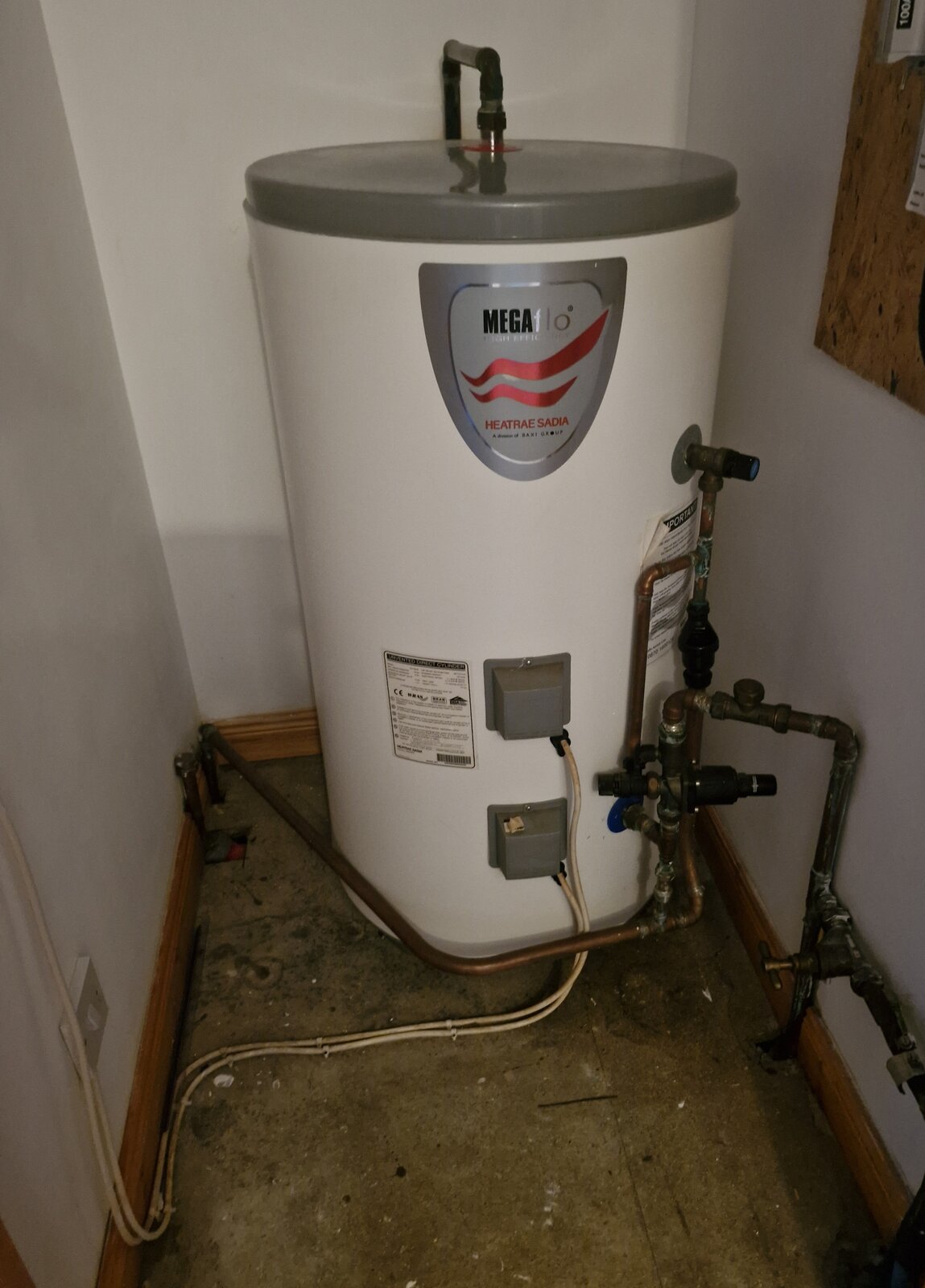

Hello.
I have the following meter-
Meter type: Smart (SMETS2)
Aclara: SGM1416B
The booster is a Electrisaver Electronic Timer; Horstmann
I was told by the engineer who was servicing my Heatrae Sadia Megaflow
tank that the booster Electrisaver Electronic Timer; Horstman is faulty and needs to be looked at.
The engineer also noticed an issue with the cabling - ' all consumer tails undersized other than
netural should be 25mm to match incoming 100A fire.' so in other words the lower gray cables should be a
22-24 thickness which is now standard.
I feel this may cause future issues and probably needs to be addressed?
Idealling I would like a working timer
I feel that the thermostate is in built into the heat tank where it regulates the temperature. A separate unit
where I can regulate the temperature would be ideal.
Before I contact electricians looking for quotes I am trying to educate myself on what I have and the restrictions
laid against me.
I have a strong feeling that I need to get the tails fixed/looked at?
I want a thermostat
I want a working timer
With the Heat Sadia Megaflow I am thinking is it best to go with one of their own products ie thermostate panel like timer or
go with whatever the engineer recommends?

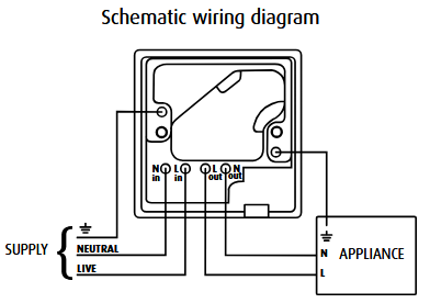

I found one of these
at nearly £50 second hand on an internet search, that seems well overpriced. The instructions show 1747127737943.pngrather a simple wiring diagram, it does not seem to have two supplies. However, no harm making sure first. It would seem we are looking at a pre-pay Economy 7 system, but the meter has a dual output, which does not seem to make sense with the switch shown, so asking for more information makes a lot of sense.

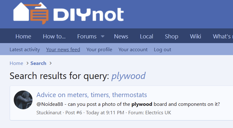

When you wrote this:
There had been no mention of a plywood board. Or indeed any type of board.
Yes, but when I look at the original image posted, there’s a plywood board next to the unvented cylinder. If I zoom in I can see what looks like a 100A fuse/carrier, so it’s me who mentioned the plywood board but the OP who posted the photo first.
My bad - I hadn't clicked on the image, and as you say there is a ply/OSB board there with a fuse.
Sincere apologies for my somewhat sarky post.
:oops:
I have no idea why @Noidea88 would post on two forums, then vanish? Been around since 2024 seems that tank is drained in the winter. So we must consider that the immersion heaters could be damaged.
Looking at the distance between the two immersion heaters, they seem too close to be a bath/sink arrangement. So would need to be a dual supply of some type, be it peak/off-peak, or some solar system, but since it seems in a flat, most likely is the peak/off-peak.
As to how this is controlled, the E15 in the part number seems to relate to time, so 15 minutes, ½ hour, and one hour as the E30 is ½ hour, 1 hour, and 2 hours. I will guess on around 150 litres, so around the 12 kWh mark to heat the whole tank. So looking at around 4 hours to heat the whole tank, so one hour seems rather a short time. Clearly hoping not starting with a cold tank.
