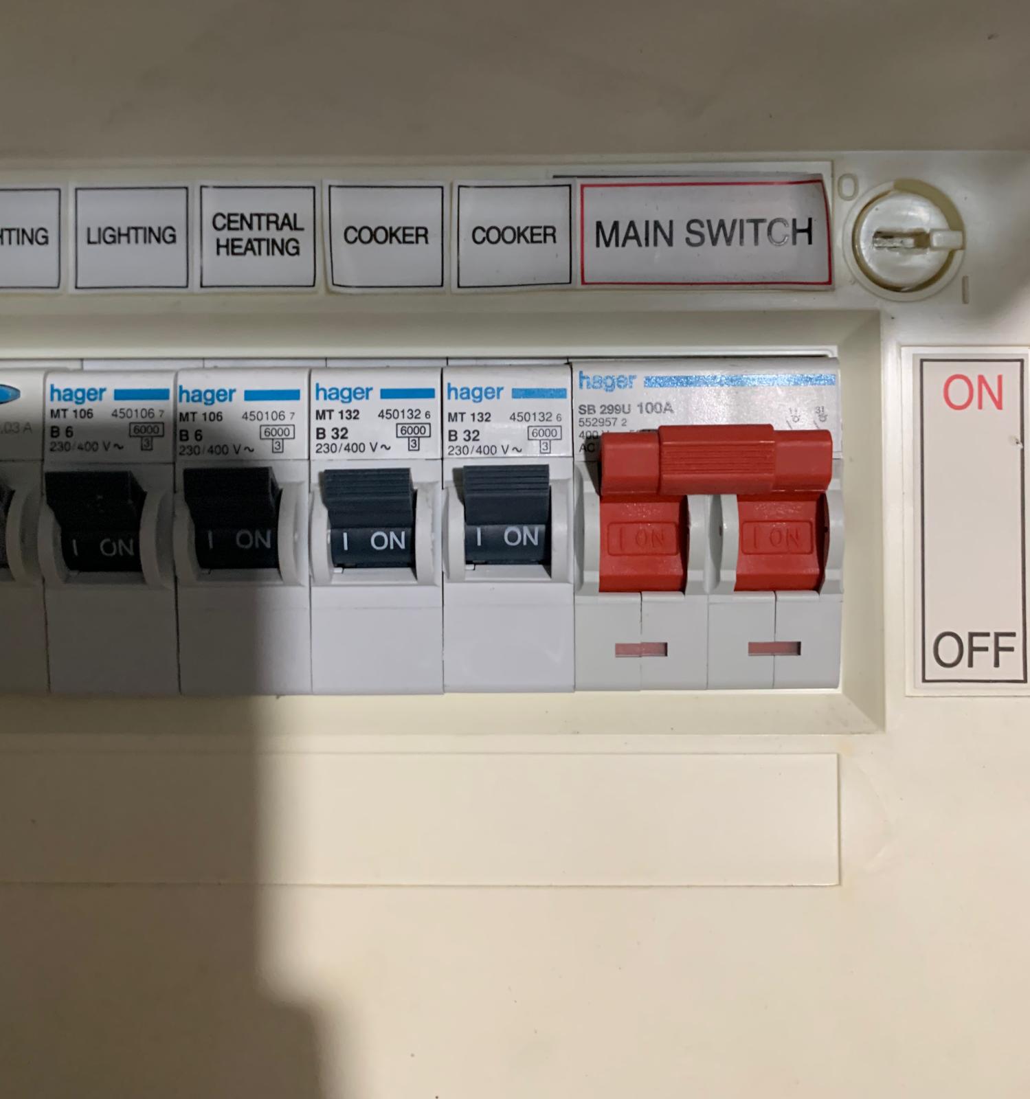

We currently have a single integrated oven and a separate induction hob. Each has its own red switch on the kitchen wall.
The consumer unit has 2 "cooker" parts both labelled as B32.

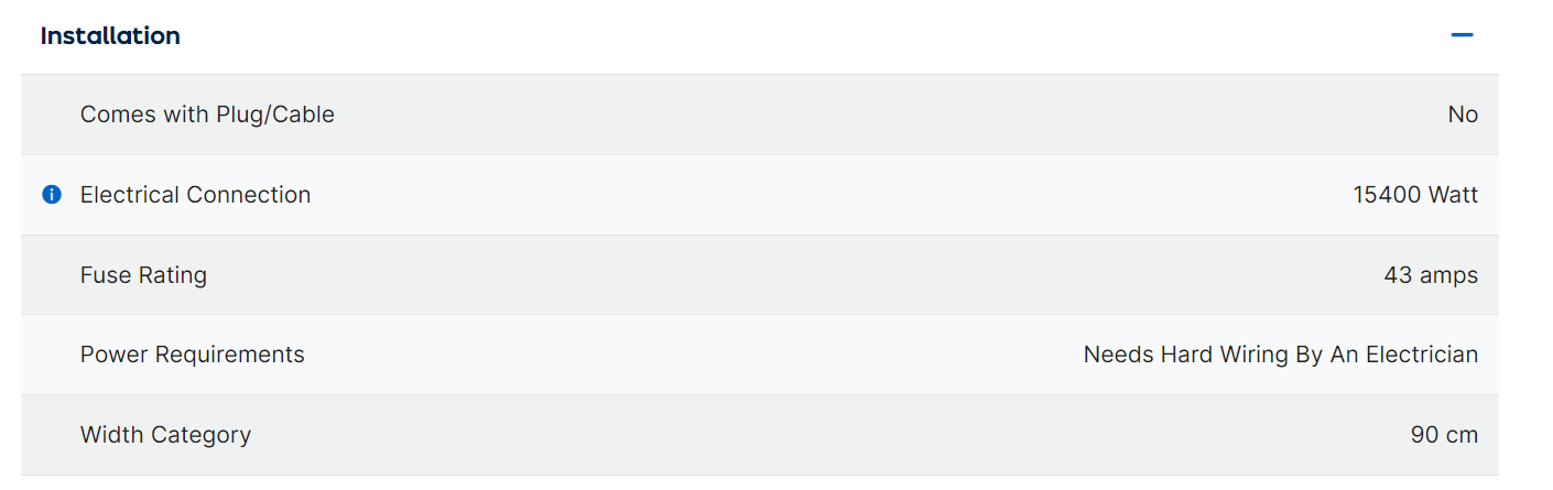

We are hoping to get a larger freestanding electric range style cooker with its own induction hob. The one we have been looking at has an "electrical connection" of 15400 watts, and a "fuse rating" of 43 amps.
Would we therefore need any additional work carrying out rather than a simple installation by the electrician such as new wiring etc?

No you don't need additional work, your new appliance could be run on one of the circuits; you did not need two in the first place.
It may work out to 64A adding all the elements but for cooking appliances we use what we call diversity because even if all switched on the elements cycle on and of all the time - more off that on.
The formula is the first 10A plus 30% of the remainder so 54 x 0.3 = 16.25 + 10 = 26.25A plus 5 if there is a socket on the switch so 32A is fine.

15,400W at what voltage I can hear us all thinking.
I think something has been missed in the translation 43A does seem to be a strange figure for a fuse rating.
I suppose a manufacturer could make there own diversity calculation that deviates from our own tried and tested approximation if they see fit to do so. But it does seem unlikely though

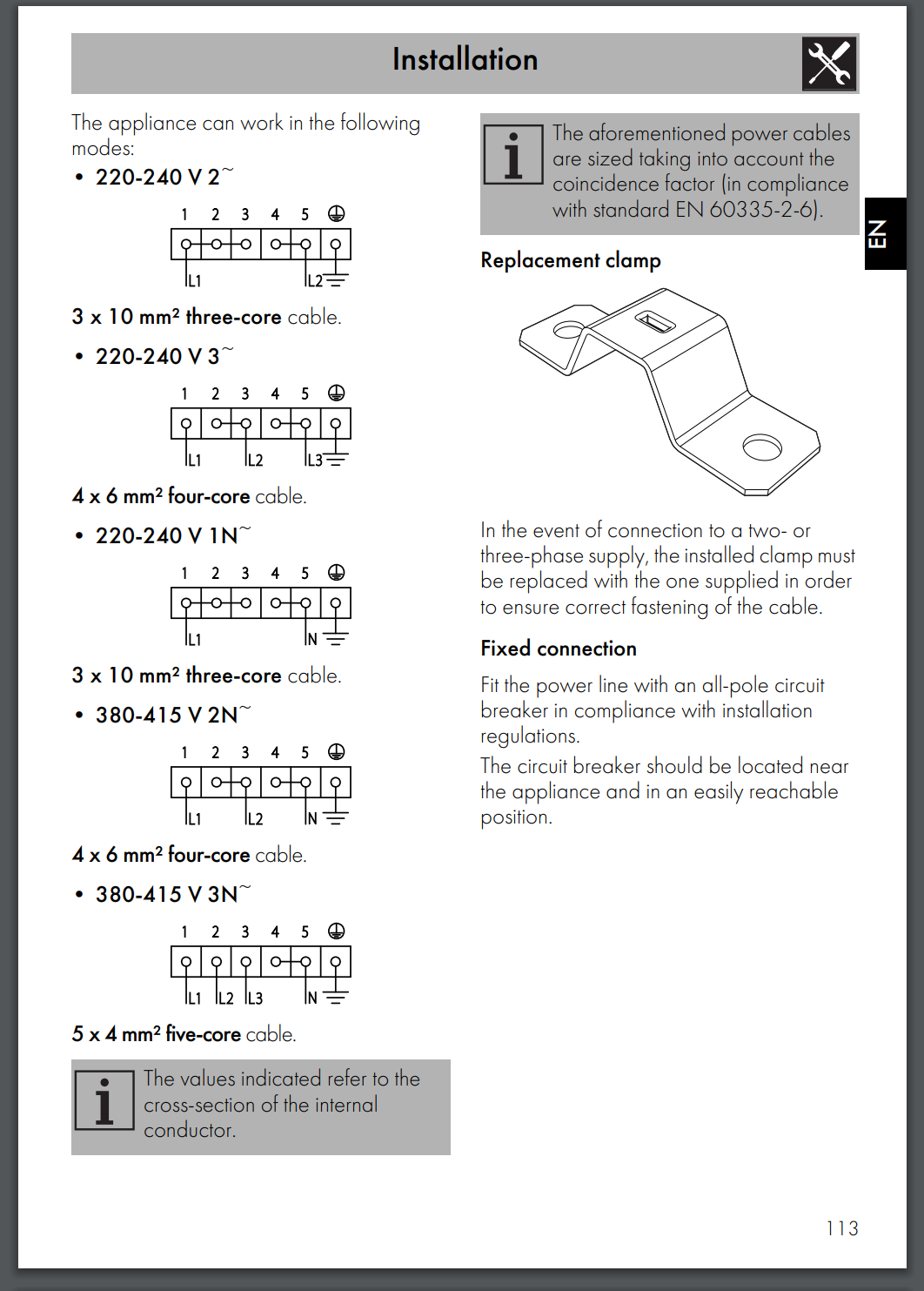

I suspect it may possibly be this Smeg.
They could be doing their own diversity, as it is a double oven with built-in induction hob?

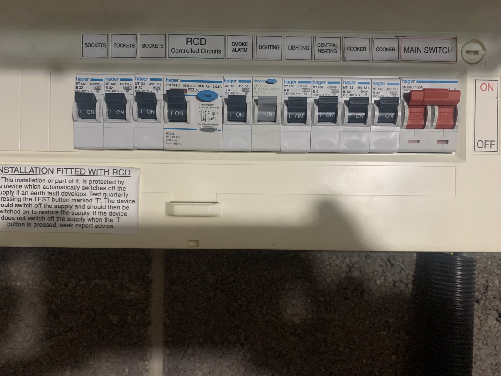

My concern in your case would be lack of RCD protection, didn't think anyone today had consumer units without RCD protection.
Well actually there are quite a few even today Eric but yes you would normally expect RCDs in most homes by now.

Yes it is the Smeg as described above! Is the consensus still that the current set up would be sufficient? Or would it require a higher amp breaker like this one …
Looks like there’s RCD but only lights?
