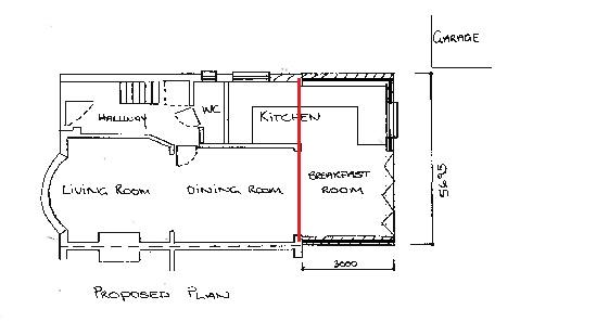

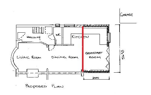

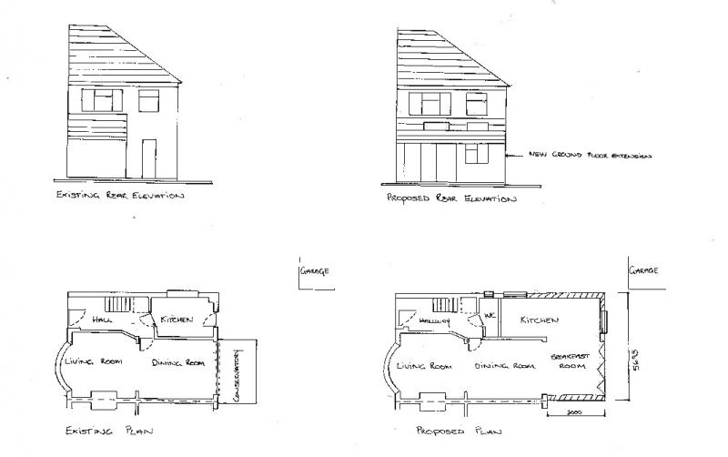

Hi All,
I still havent got to the bottom of this issue..
I have annotated some drawings and uploaded a view of the rear of the house to see if this changes anyones opinion on what is required.
I have sent some Structural Enginner companies emails with all the drawings etc but they are taking a while to respond with costs for the cals let alone the actual calcs...so everything is on hold until i know what i am doing with the steels and whether its plan 1 or plan 2.
Plan 1 is a single steel to open up the whole back of the existing house to the extension
Plan 2 is leave the existing house as is, but increase the kitchen opening.
Is it most likely that plan 1 will require a picture frame?
Is it most likely that plan 2 is easier and will require only the top steel and brick pillars..
Any thoughts on the predicted outcome of the SE report would be appreciated as this may help decide the final plan.
Jason

As FMT says you are by far better off phoning the local SE's and checking if they do this kinda work, how set they are for workload at the moment and if they can slot you in at short notice.. (when things get busy smaller jobs get sidelined for weeks/months).. and they should be able to quote a rough cost for site visit/building regs calcs/construction sketches..
As far as your two schemes go, well pick one and go from there.. if you want the SE to quote for 2x the design work then keep both options.. anything is possible structurally just the more complex the higher the cost to build..
Chances are for a 5.6m wide opening youll be needing on hella a steel something requiring a crane to get on site.. this will also need new foundations at each end with new rebuild piers or columns.. Either reduce the opening to around 4m max provide a column to break the span up a little.. be wary of possible party wall issues with the steel on the boundary with neighbour and factor the costs in..
