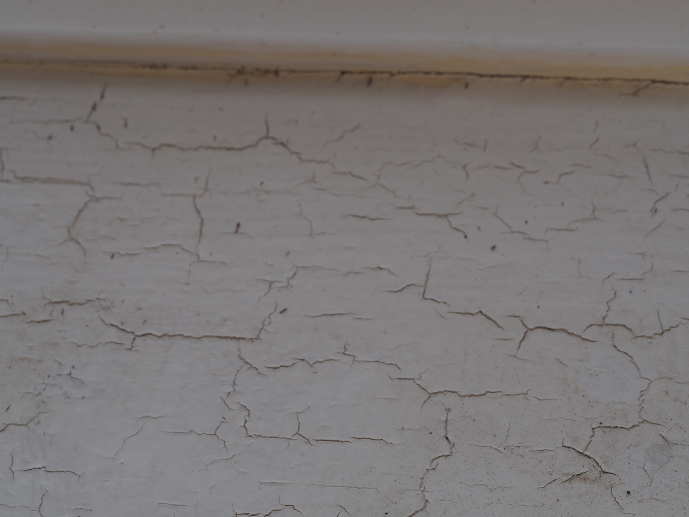

Thank you for your replies. These are internal sills in ply wood (I think). I'm not sure how much paint is on here but I suspect not much but old. I don't want to burn off as the windows are UPVC. Top of the picture is the edge. The pic shows the surface which I suspect is other than orange peel but I am not up on paint problems.

It is difficult to say why the paint has crazed like that.
If I had to guess... It may be the case that whoever first painted the sill used PVA as a primer.
I understand why you wouldn't want to use a heatgun but with a "window shield" on the gun you should be fine.
eg https://www.heamar.co.uk/heat-gun-n...-070410-window-nozzle-75mm-4007841070410.html
BTW I am not recommending the attachment above. Different guns have different diameters. Sometimes I use a very wide metal filling knife to protect surfaces form the heat.
Personally I would sand the area back to the wood but unless you buy a good trade quality random orbital sander, the heatgun might be faster.
