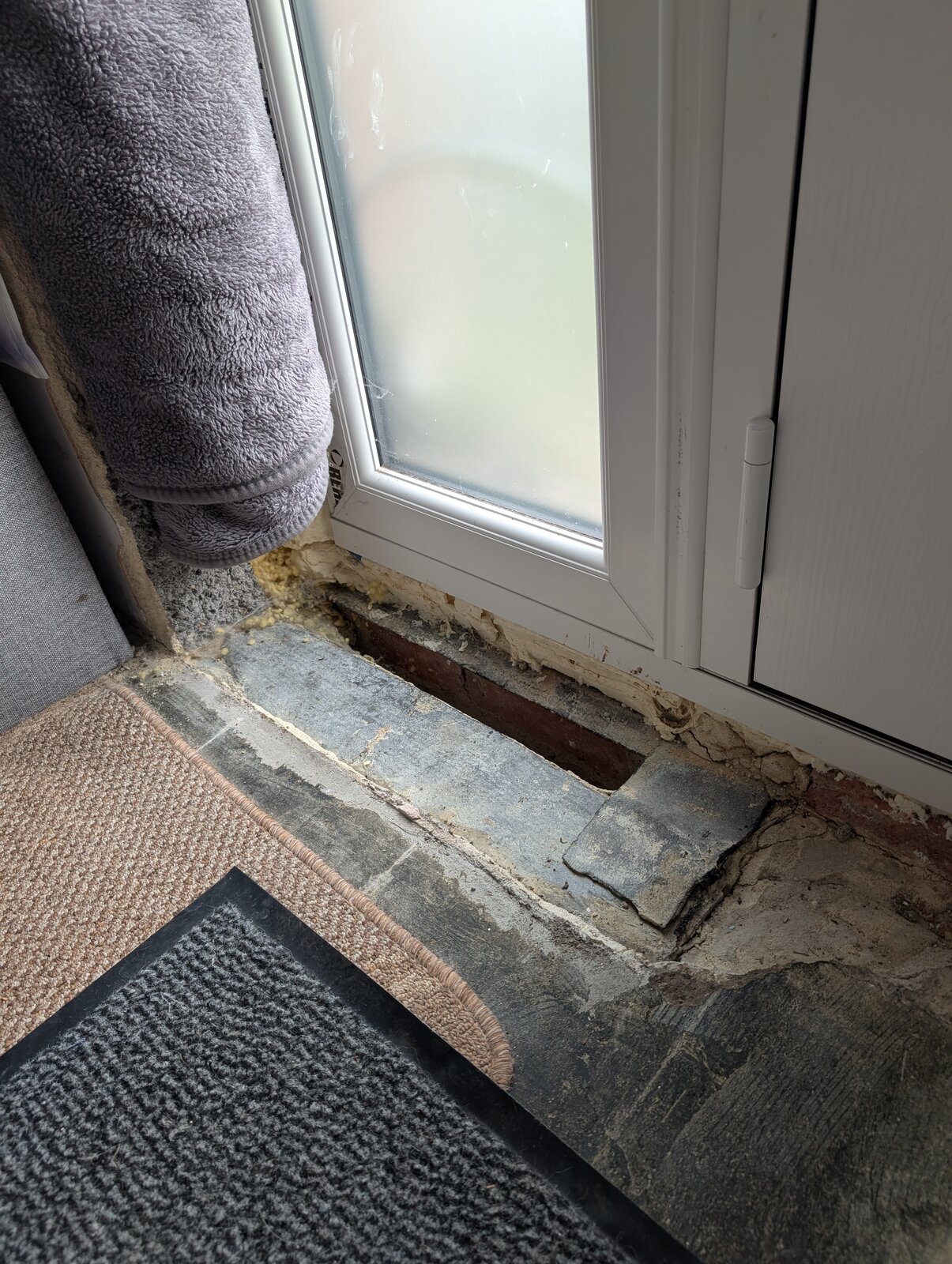

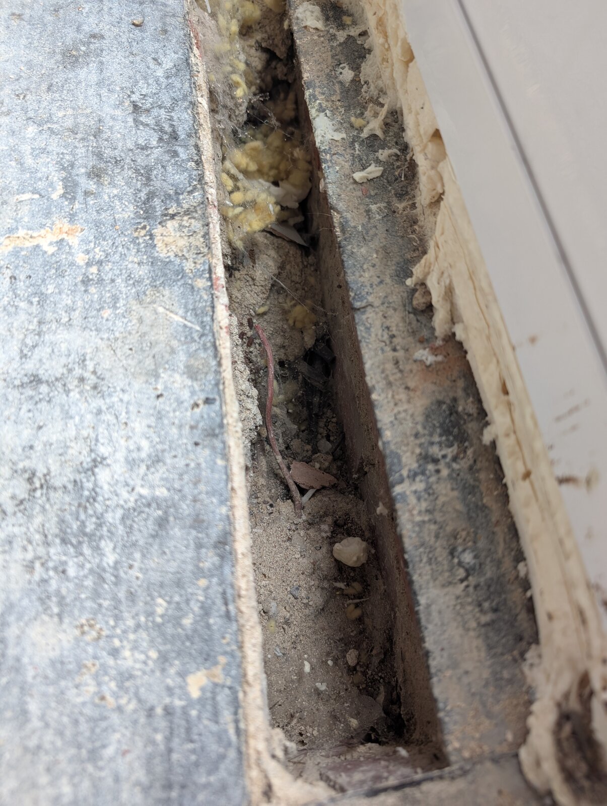

Hi, thanks in advance for any advice.
When we had a new front door installed, we also removed a low wall that previously sat beneath a window. This has left a hole in the floor, which is part of the cavity wall. I now need to fill this hole up to floor level in preparation for applying Mapei Latexplan No Ammonia self-levelling compound throughout the hallway before laying laminate flooring.

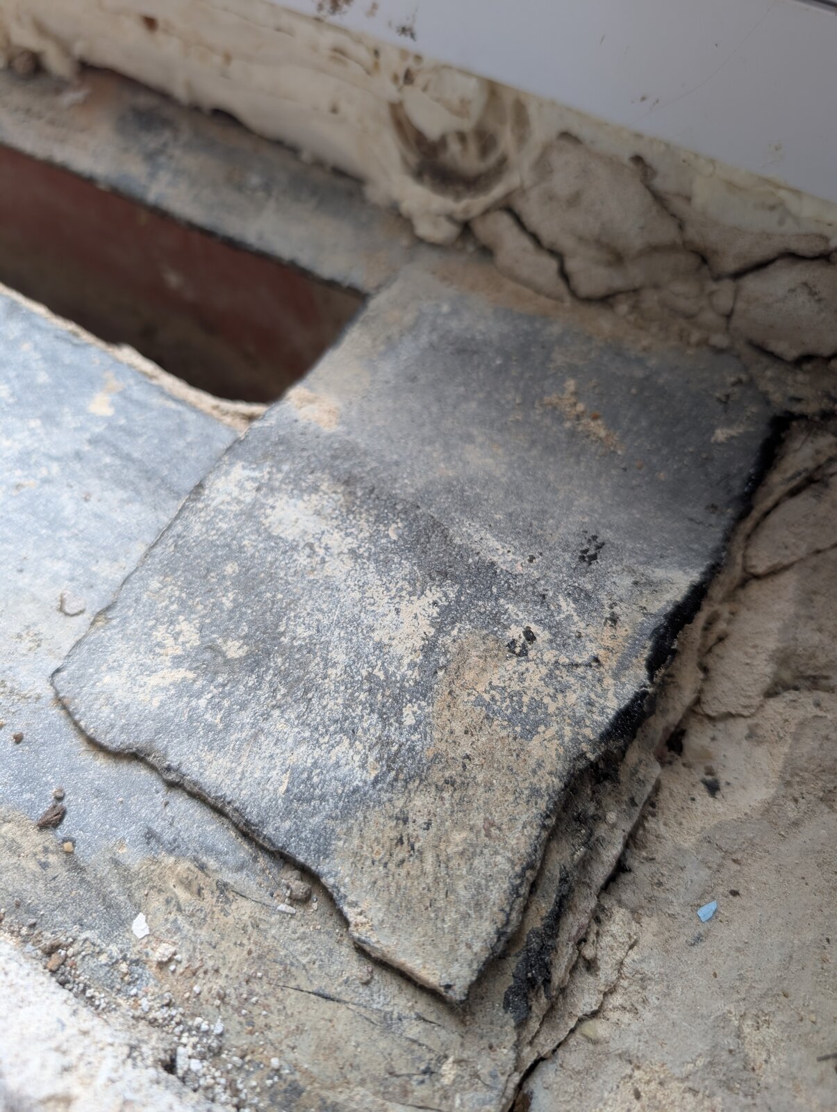

I’m using this compound because the hallway previously had asbestos floor tiles, which have now been removed, leaving bitumen behind and this compound I have used before and is suitable for that requirement.

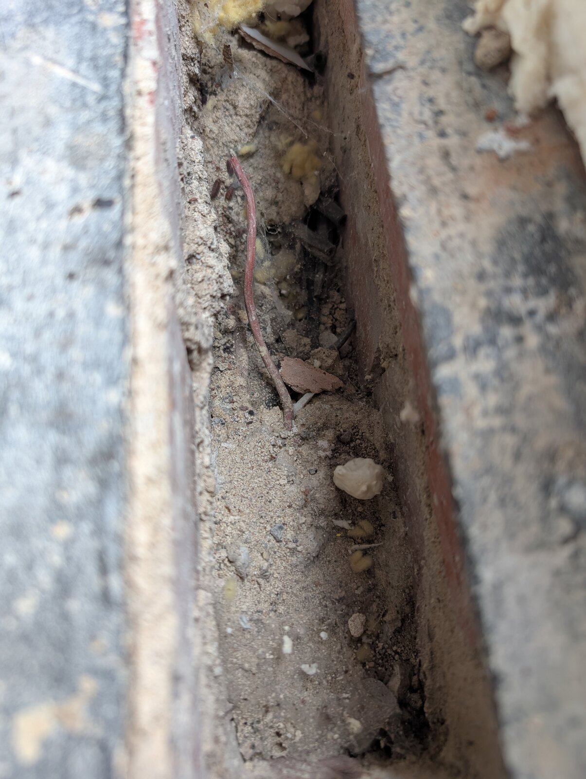

The hole measures approximately 14cm deep, 7cm wide, and 41cm long. It has a cement base at the bottom and brickwork towards the front. Around the top of the hole is a black plastic-type material, which I believe to be a damp-proof course (DPC). From the top of this DPC, there’s a further 2cm gap before reaching the main floor level.
Could anyone please advise on the best way to fill and prepare this hole so it’s ready for the self-levelling compound?
I am also concerned with the fact that this hole has no DPM and would like advice about if I should 1
Many thanks!

The dpc is the dpm, just overlap the new with the existing then apply the levelling compound.
Before doing the above obviously fill the cavity below first, Screwfix and Tool Station do a repair mortar product (Bostik cementone) that is workable but sets quickly.
The membrane appears to be what you describe as the dpc. The dpc runs under the brick and block work in the main walls. They should overlap.
Many thanks!
You cant put their floor leveling compound straight over a DPM, I have asked Mapei, I am considering filling the void with hardcore, tampered down, then adding sharp sand to level it out, adding a dpm to the surface as you say, over the hole and hardcore/sand, overlapping, then use a concrete repair mortar to fill the rest of it up to the main floor level, then the floor leveling compound can go over the whole lot, floor & concrete repair, once the concrete repair is primed
best way would be remove all that old Dpm
Then put some visqueen sheet in and lap it up the door. Then fill in with the Mapei na and granno chips.
I’d then Dpm over all that with an epoxy Dpm but you could just screed it all with the na then use a decent underlay with taped joints.

No there is no Visqueen DPM. I have not touched any of it yet or done anything with it, we just have a bare hole and the exposed DPC
I am not sure if there is any DPM under the concrete floor however I believe thaty the bitumen you can see acts as 1? I will be adding an underlay that has a DPM

Ok fill in concrete then.
Then the na over the whole floor at 3mm
Fball f77 3kg / ardex DPM1c 3kg
Then the underlay & laminate
