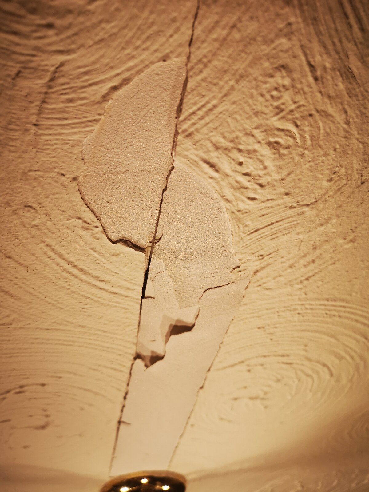

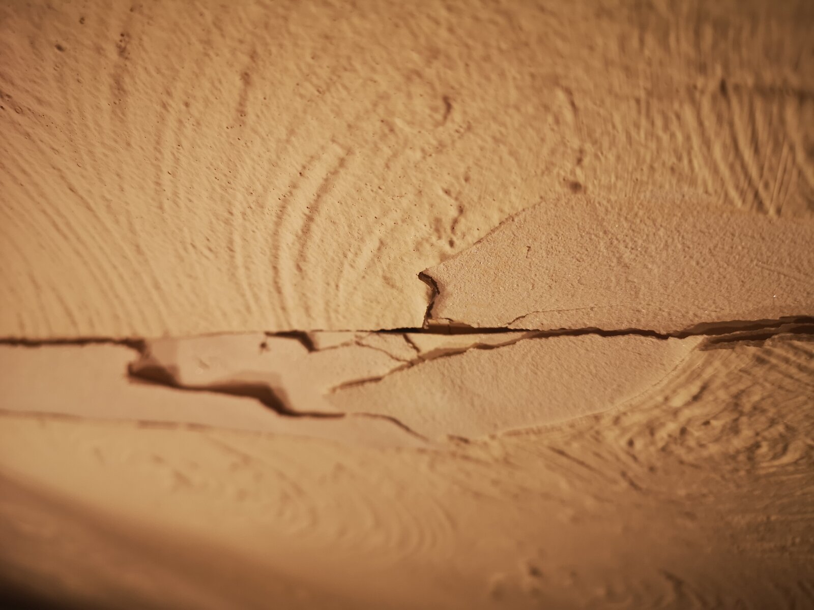

Hi all. Some advice please.
Have had a leak and damaged the ceiling which is I've come to realise textured and could possibly contain asbestos . ?artex
Built in the late 1980s.
Any opinions from the pics if it is or not
I know 100% way is testing.
But that's the risks and is it shedding as it is or do I need to do something in meanwhile to reduce risk....
Thanks in advance for any advice / help.

If it’s built in the late 80’s it won’t have asbestos in it.
Brown and blue asbestos was banned in Britain in 1985, however, white asbestos, (the least dangerous), wasn't banned until 1999
White asbestos was the type added to artex but it was only a small amount, around 1-3% Artex is perfectly safe if it is not disturbed and in good condition. If you plan to remove it then it is suggested you get a contractor to take a small sample for testing first. If it contains asbestos then you can plan preventative measures for it's removal.
If you are looking to repair the damage from the leak then I would suggest getting the whole ceiling skimmed with boar finish plaster. This will prevent and further damage to the artex and contain it all behind fresh plaster.

Even if positive for asbestos, it's the least hazardous type and in such low quantities it is often undetectable unless many samples are taken from many areas of the ceiling.
Spray it with water, pull the big pieces off and bag them.
Paint over the broken area until you decide what is to be done with the ceiling.
