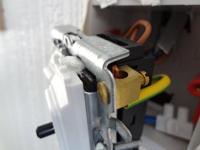

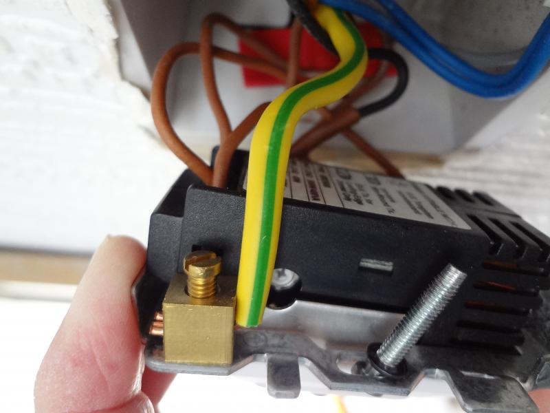

Now I've unscrewed the metal case (because I couldn't get the switch out) I can see that the switch was never going to simply pop out. It's way too big to come forward. See pics. The fan switch next to it is so much smaller.
I can now see it's a 500w dimmer.
I am happy swapping like for like when it's simply a case of connecting wires but not if I've got to start pulling stuff to bits. The box is only 2.5in by 2.5in
What do I do now. Call the electrician back??
How long are these dimmers guaranteed anyway? It's not even 3 years old.
Any help appreciated. Thanks

I think someone mentioned earlier they are bigger than the standard and you un nut the front and remove from the back

You will be fine with either a replacement richmond dimmer or a MK one for 3 of those lights.
Did you manage to remove the old dimmer? There is a shiny round nut with two notches in located in the recess where the dimmer knob goes.
The dimmer comes with a tool for doing this up, but if it's missing, you should be ble to undo it with a medium sized slotted screwdriver inserted into one of the notches.
If it is was working before then the simplest way forward is a like for like swop. I'm wondering if your lights are LED?
