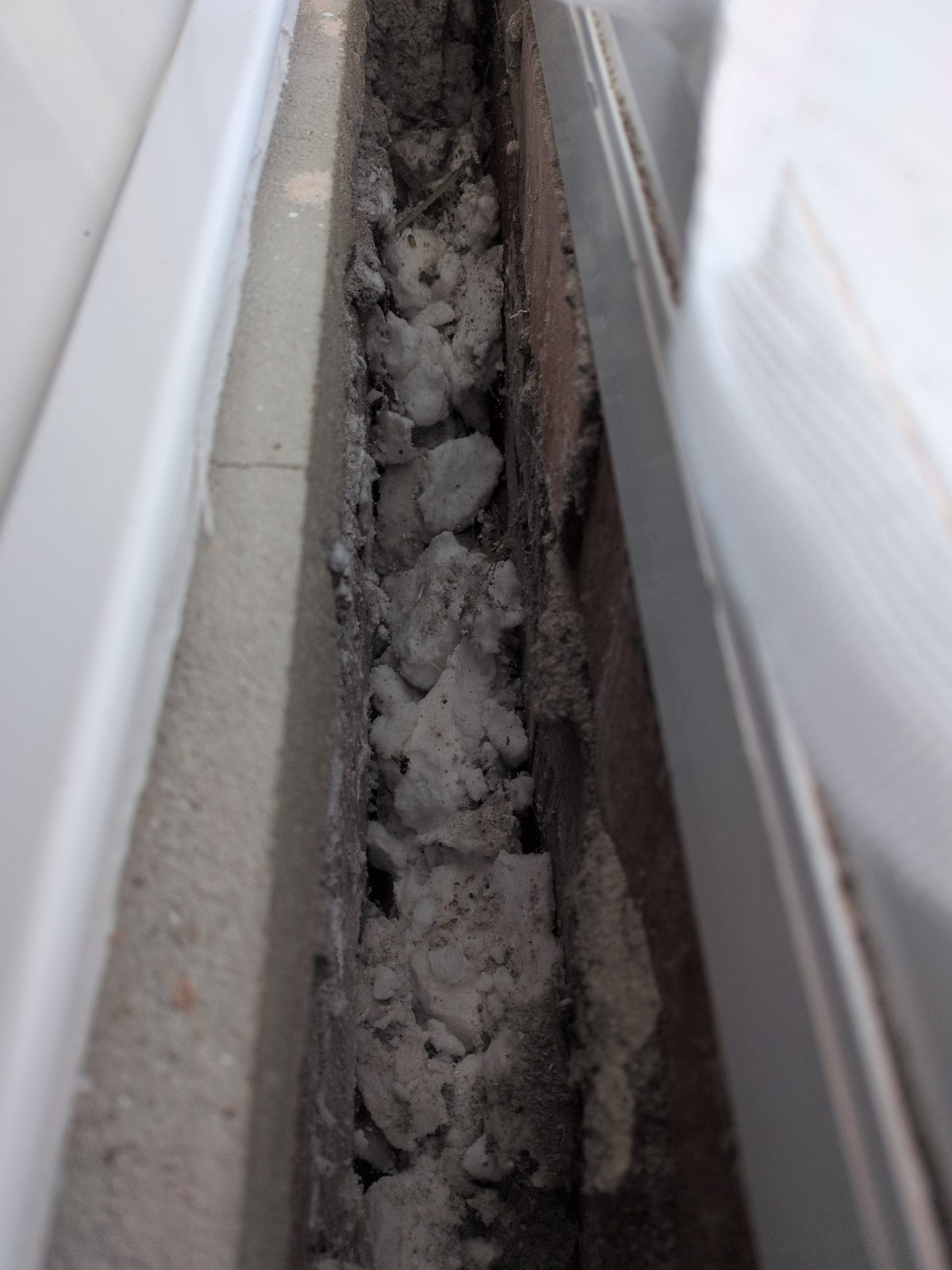

The external wall is getting saturated - the staining at high level. The bricks are soft clay and the unfinished recessed pointing is the wrong choice - it allows water to easily penetrate the joints and the bricks.
Its common, and likely that this saturation is then causing water to run down the back of the external bricks in the cavity and into any mortar snots on tie wires (the random wet circles) and across at the floor level (the larger damp patch).
The black mould may well be related to water cooling the wall, causing a condensation issue.
Remedy - have the cavity opened up (externally) at the damp spots to check for and remove and cavity bridging. Water saturation of the external leaf is not an issue, but cavity bridging is.
In extreme cases of blocked cavities (or poorly fitted insulation that can't be removed) then the external wall may need to be pointed up with a better weather-resistant joint, and maybe a water proofing coating applied.
If there are numerous locations of damp, then a borescope cavity survey may give a better idea of a course of action.

Regarding insulation, these pictures show the cavity under my living room window (window sill is loose at the moment!) with lots of broken down insulation that was presumably pumped into the walls at some point after the house was built. Could this be an issue as well contributing to the penetrating damp? I recall a local plasterer who I've used in the past mentioning that he had branched out into a business that went around removing this type of insulation, at a few grand a pop.
