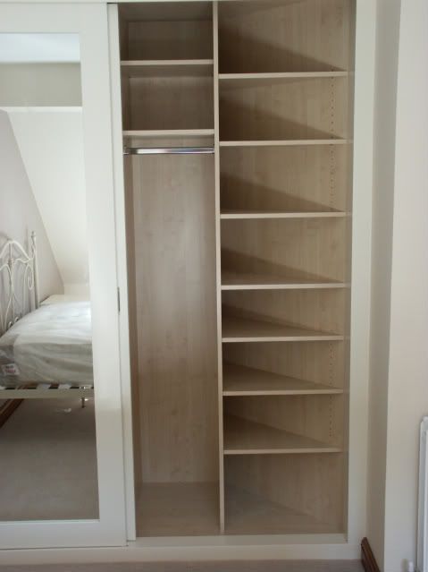

BA I meant to post these at the same time as my reply but couldn't find where I had them stored.
As you will see there are two doors virtually floor to ceiling and the recess is 2100mm wide. There is very little loss of access with two doors and what there is is taken up with a vertical divider. Internals are done in the wood grain MFC as I suggested except the draws which are solid maple. All the painted frame & doors are MR MDF, runners are Hendersons Husky 100's
