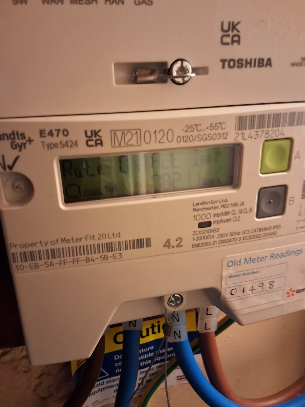

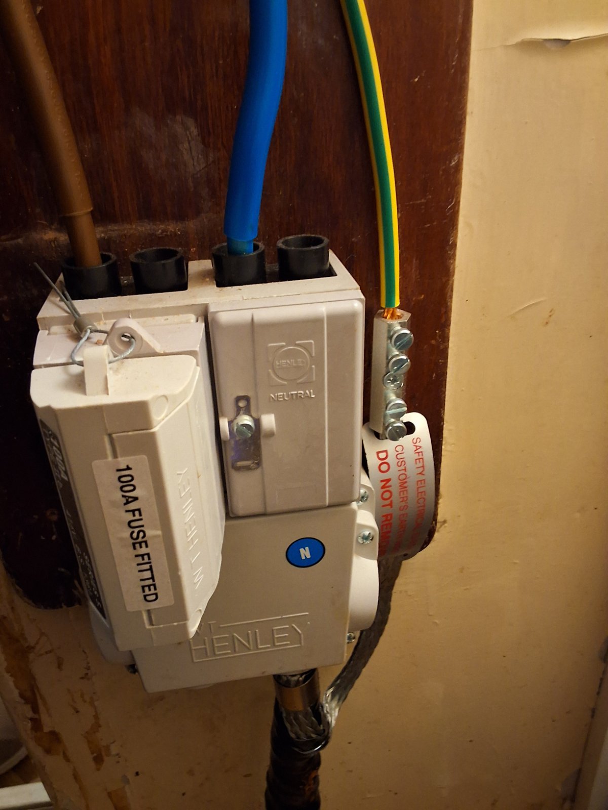

Can you post pictures of your electricty supply equipment (service head, meter, CU etc) and the surrounding wiring.
Cutout and meter
That does look like a TN supply.
At this point, I think you need to get it checked out by an electrician (or at least someone with the right test equipment).
