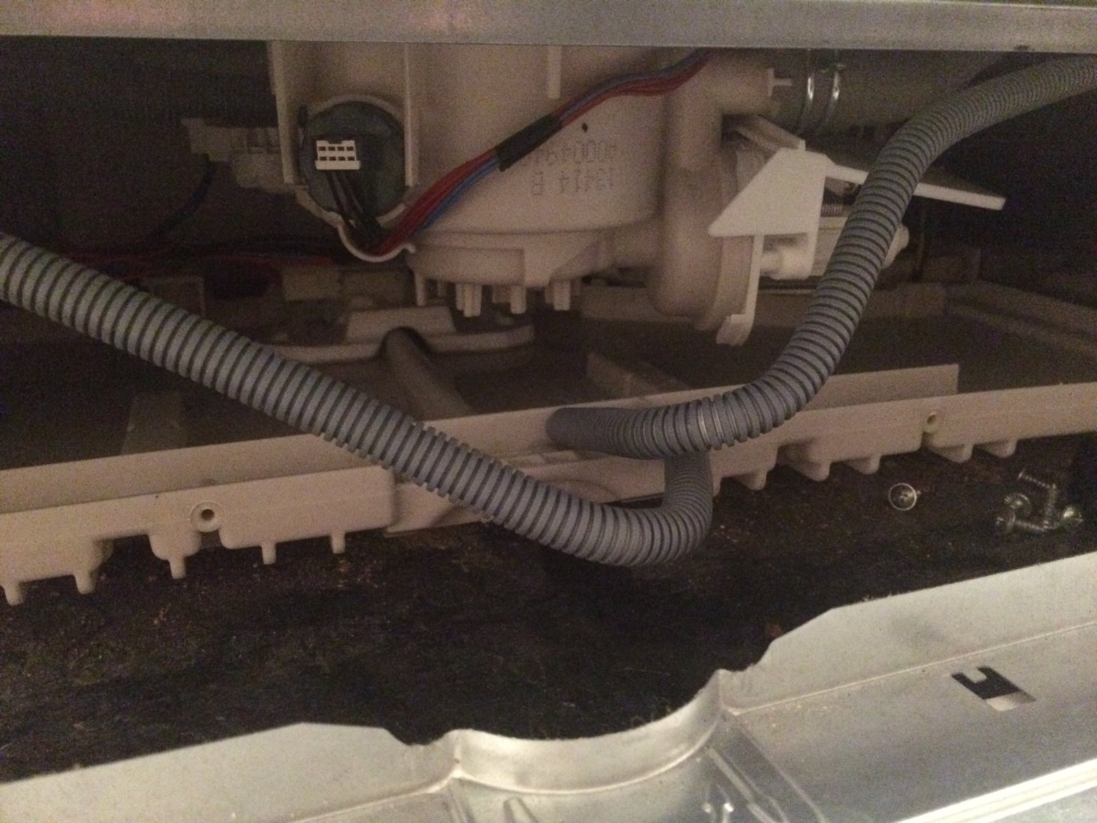

Hi. We have an AEG Favorite Pro Intensiv dishwasher.
A while ago, the anti-flood device operated. I removed the bottom front cover, dried it out and tried it again.
A few cycles later it happened again.
I have spotted that there are 2 small plastic pipes that carry excess water down to the sump.
The left hand side one is filling it up.
Can anyone tell me what causes this please?
Thanks in advance.
photo would really help here
are you sure its an inlet filling tube? by small pipe would indicate its connected to a pressure sensor if yours has one fitted
if its about 5 mm in diameter i would say pressure sensor pipe

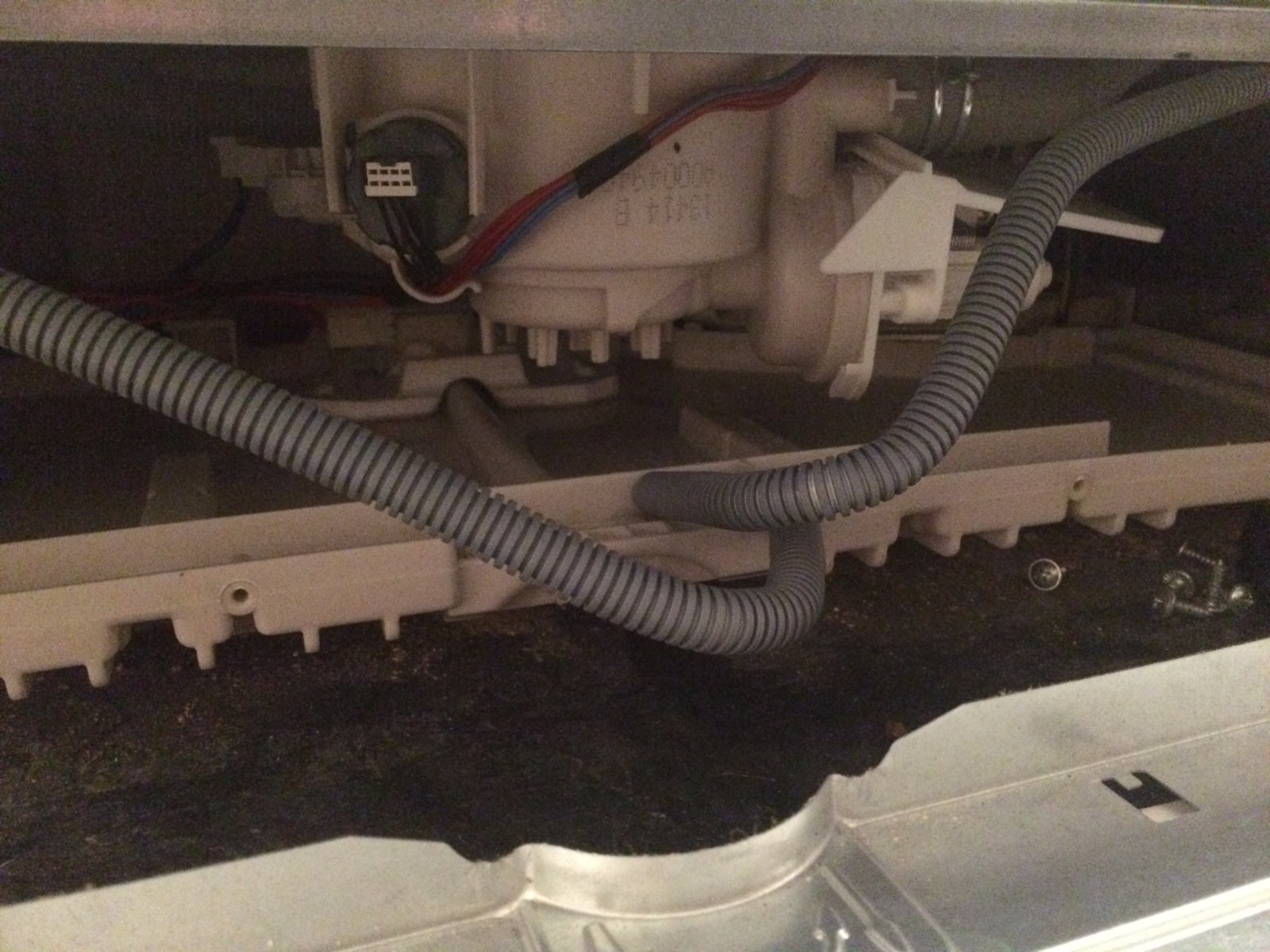

There are 2 grey plastic pipes coming from inside the wash chamber. Their only purpose appears to be to divert excess water into the sump and activate the anti-flood device. You can see these 2 pipes in the attached photo. One has a red arrow, the other has a blue arrow. They are both open ended.
It is the left hand side one (Red Arrow) that is filling the sump.
It appears that something is blocked elsewhere but without stripping the machine down I can't see where.

sure one of them will go to a pressure sensor, most likely the blue arrowed one
what do you mean by 'open ended'? do not connect to anything, surely not
Don't think so, as they are both open ended in the sump area and appear to be emergency drains, see first pic where I have dropped the open ends for clarity.

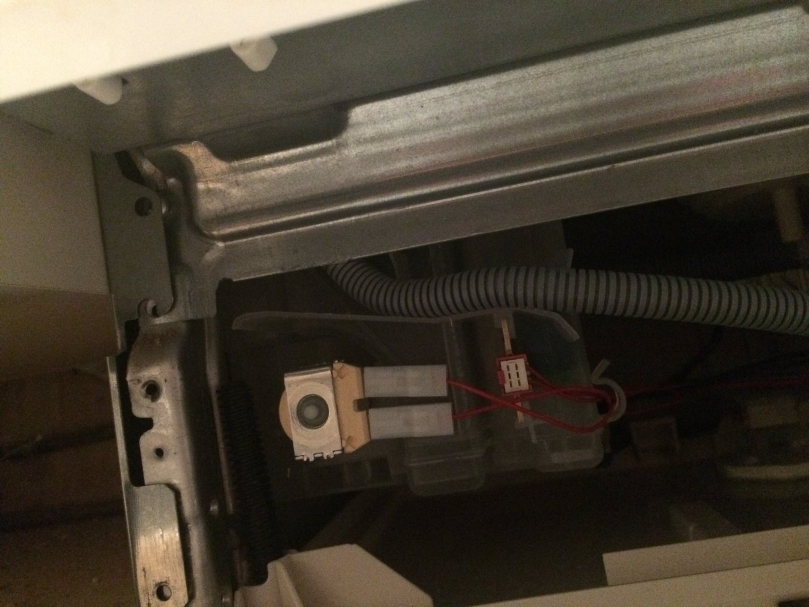

It disappears into wash chamber above a solenoid, See pic 2.

aha, open ended at sump.
i do think the blue one will connect to a pressure sensor at the other end.
If it helps Yardie, if I blow down them, they are both clear, indicating that there is nothing (like a switch or sensor) on the other end.
And it is the LHS one (red arrow in first pic) that fills the sump.
I think maybe something in the recirc piping is blocked somewhere, or the chamber is over filling - which could indicate a sensor not working correctly - but I don't think these pipes lead to sensors.
Any idea about getting exploded internal view of the dishwasher? I have done rudimentary internet search.
Paul.
the red one goes to the water inlet (filling) side by the looks of it.
you are going to have to strip it down to know for sure whats going on.
have you actually been able to identify where the water thats collected in the base activating the flood switch has come from?
I can clearly see it is coming from the LHS (red arrived) pipe.
Difficult to see where the other end of it goes.
