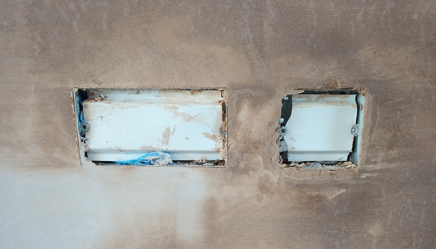

...I suddenly twigged that 38mm plastic capping makes an excellent plaster guard. To my mind, it's always better to be able to plaster right over accessory boxes than fiddle about trying to go round them:
Is there anything that you have discovered after years working as a spark that made you think, " This makes my life a little bit easier, I wish I'd thought of this earlier!"?

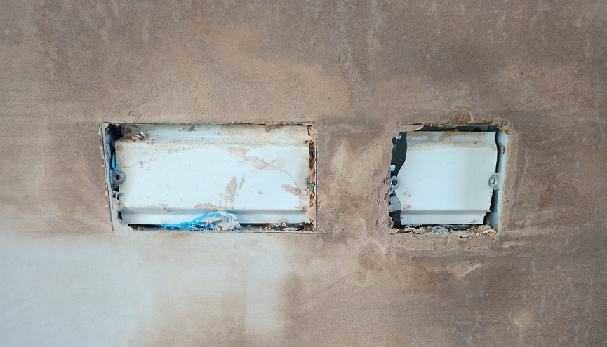

Great idea!
Usually i fill the box with newspaper and some seller tape, but this is better.

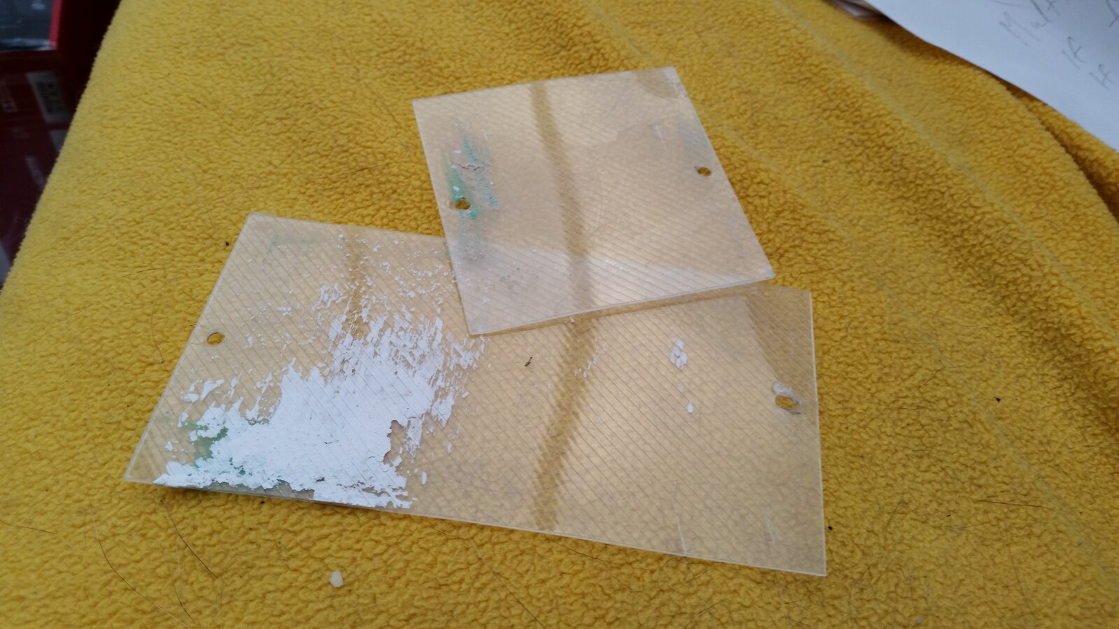

I probably have OCD. I cut dozens of these out of old plastic folders.
