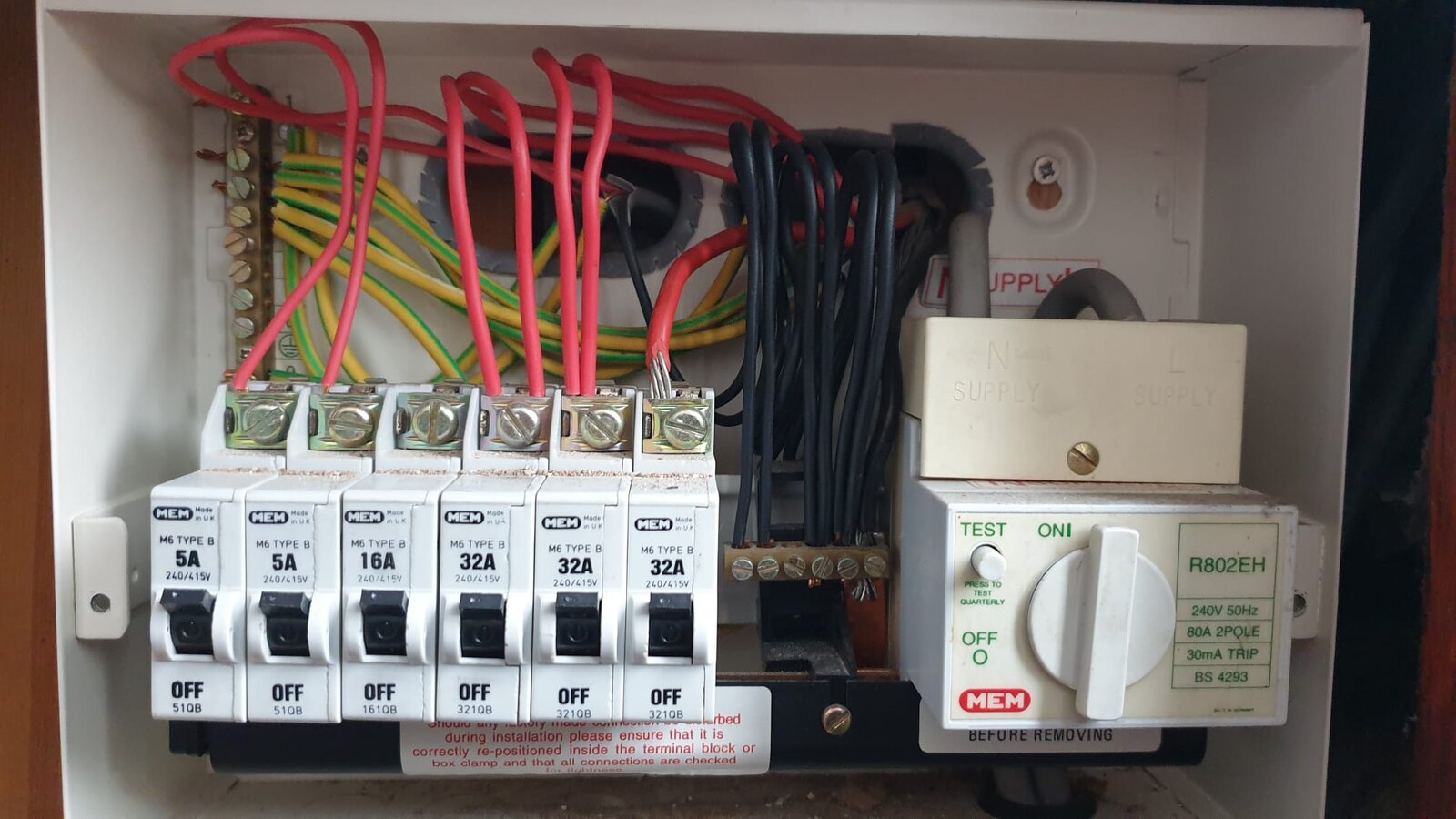

What year were these MEM boards installed?
I would think 30 years ago or more. Any thoughts

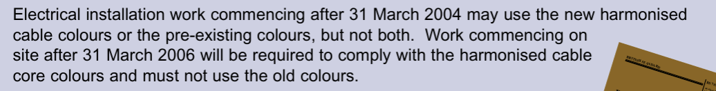

They lied then. The new cable colours (Brown & blue) came in to use from 2006, so the black/red wires mean they are 20+ years old.Interesting when someone implies that the house was recently rewired.
Actually Part P was 1 Jan 2005, and I'm sure at least 6 months before, red and black had all but disappeared.The new cable colours ... came in to use from 2006...
if the house is 500 years old, 40 years might be considered "recent"Interesting when someone implies that the house was recently rewired
As above, harmonisation of the the cable colours was nothing to do with Part Pee.Actually Part P was 1 Jan 2005, and I'm sure at least 6 months before, red and black had all but disappeared.
I would have to agree, but we have some landmarks when there were major changes.if the house is 500 years old, 40 years might be considered "recent"![]()
Harmonised colours for fixed wiring in the UK were introduced in 2004, with a two year transition period, so red/black was considered "acceptable"* until 2006.Actually Part P was 1 Jan 2005, and I'm sure at least 6 months before, red and black had all but disappeared.
2) Move from rubber to PVC, not sure of date, but also mid 60's.
It has to be 80s, well I think so anyway...I'm not sure that 6mm is tinned.
Anyway, it's metric cable, and green/yellow sleeve. So sometime after 1974
The fact is has 30ma, points to 80's
