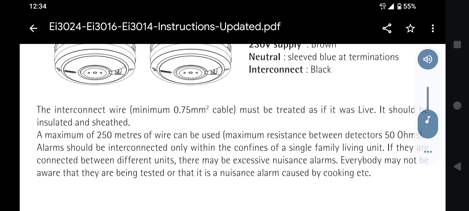

Surely it does though under 514.3 of BS7671:2018? I can't see any other get out clause.
It's also as per the manufacturers instructions
The manufacturers are free to say what they wish, provided it is compliant with BS7671 - which, as above, would be the case with brown identification (but also with Black, Red, Orange, Yellow, Violet, Grey, White, Pink or Turquoise).
