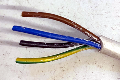

Aico alarm wiring instructions
I wouldn’t expect grey. That cable (well mine anyway) was around long before 2004
Annoyingly mine has twin blacks
I suspect yours is from the 80’s.
And mine from the 90s.
They used white black for zone valves in the 80s. ACL. Whwre now they use orange grey

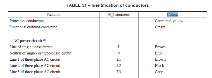

You may be right about its age. Mind you, the colours for at least some flexible cables (certainly 2-core and 3-core ones used for 'appliances') changed decades before 2004.
Today, grey would make a lot of sense - (Brown, Black, Grey) + Blue + G/Y
I suspect yours is from the 80’s. And mine from the 90s.
You may be right.
