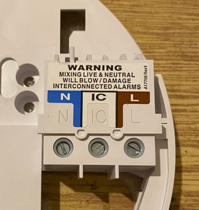

Who knows - I can see no non-destructive manner of seeing what's on the load side! However, I think it's pretty clear that they are talking about the supply cable. On the actual thing, the L & N are correctly indicated as brown and blue respectively, but no colour is indicated for the interconnect terminal. It looks like this (with the connector block cover removed) ...

I see a white sticker and a black outline, reading that as universally available for either market.
Fair enough but, if so, that's merely reflecting the table in the instructions - but doesn't answer my question of where one can find brown/blue/black or brown/blue/white cable (although pete has now found an example of the former :-)
