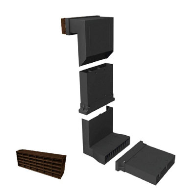

Hi ,
Just a quick question re air bricks… on my house they are just below the do I wondered if it’s possible to move them higher?
My garden runs towards the house and in heavy rain it Collects below the air brick due to the concrete path.
If the air brick can be moved higher how high can it move,
Internally it’s insulated and screed ontop

Various air ducts are available from Manthorpe.
You don't want to be inserting telescopic liners above DPC as it creates a cavity bridge (risking internal damp) and thermal bridge (risking internal condensation). They are intended for use below DPC and floor level where there are no risks.

Firstly, is there actually a problem. If it is surface water, then deal with that.
Drain channels can be useful where paving is higher than air bricks - not for drainage as such, but for venting the air brick. You cut a slot in the back of the channel to vent the air brick and cut a hole in the bottom to drain the channel. But if lots of water is running towards the house, you need to properly drain the channel away from the foundations.
