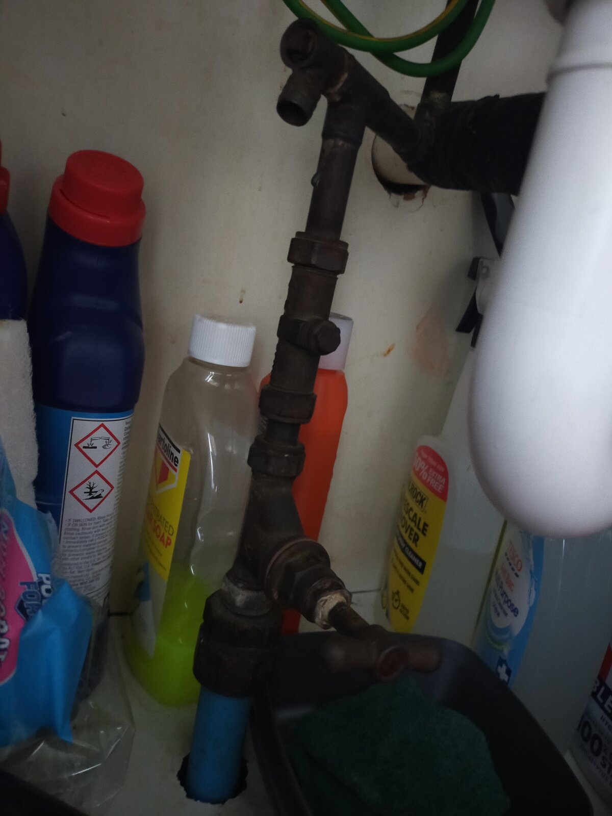

Can someone tell me please if this is my actual drain valve for the system (didn't even know it was there until this evening)

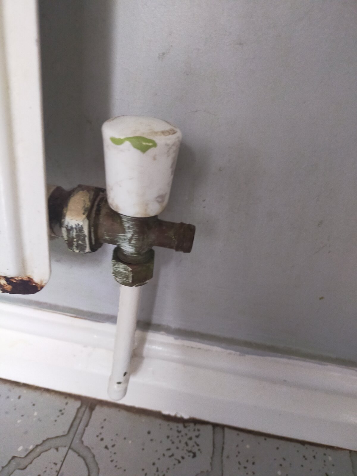

As apposed to this one which is on every radiator in the house.
if so have I been draining/backfilling wrong all the time (although the back fill still went up the vent pipe to F&E tank)
If the blue pipe is emerging from underground it appears be your mains supply fitted with a drain above the mains stop tap.
yes thats my mains feed into the house but the valve above is that the drain valve i should be using to drain the system down or would that empty everything include the immersion cylinder ?? im basically at a loss now seem to be going round in circles.

I’m interested to know how your radiator valves operate, how do you open the drain off / hose connector in order to feed the mains into the system?

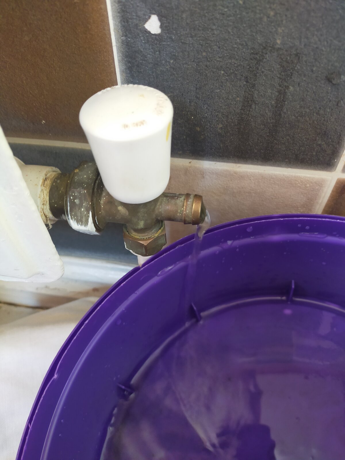

ive been doing it by unscrewing the valve i n the second picture above (#52) on each downstairs radiator and open the bleed valves to speed it up, then to backfill ive been using the same valve on the radiator closest to the backdoor.

What do you mean by that statement. When i got home this evening the rads had no water a couple had some air in but not as much as last night. I connected a hose to the downstairs radiator and connected that to outside tap and cranked it open, went into loft and waited for about 10mins for the water to start coming out of the feed pipe. (the one that loops over the tank) i then blocked it with my hand as per #50 suggestion and then let it flow, once the water started going out of the overflow i ran downstairs and turned the water off at the tap. i then waited whilst he hose drained down and disconnected it from the radiator and put the valve back in and tightened it up. I then went around every radiator in the house 9 downstairs and 6 upstairs, no water in any of them when bleeding and only some had a little air in. I haven't opened the drain valves on the radiators down stairs as in this picture
As it didn't produce any water or air from the radiator bleed vavle.
