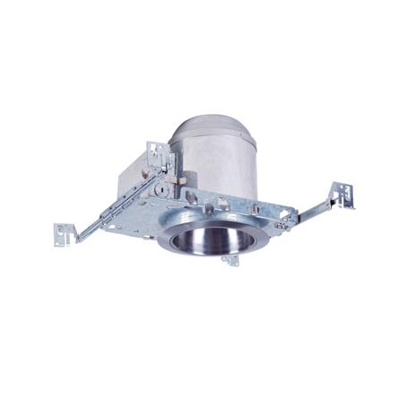

Any ideas? This is the same case with insulated airtight recessed lights (suitable for covering with insulation). They are widely available in the US, but don't seem to exist in the UK

You can get airtight downlights, but you'll probably need to look for bathroom fittings designed to prevent the passage of moisture into the loft space.
Just spent a little time looking at the spec and unfortunately seems not, which is a damn shame as they look like they could do the job!
