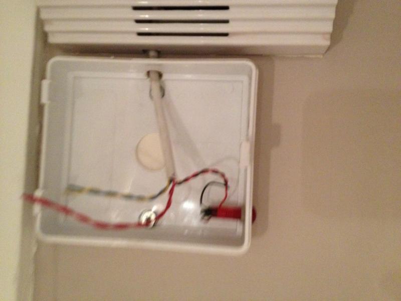

Hi there,

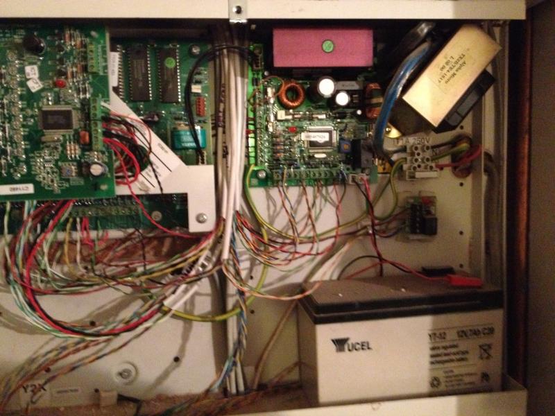

There is a single white wire/lead coming into the internal sounder, this then has three twisted wires coming out of it - a black/red one that goes to a red LED, as well as a red/red and a blue/yellow which are the disconnected wires, I have got the case off the control panel (grey box) to unveil a whole world of wires as well as access to multiple setting units.

galaxy 500 has an ouput next to the a/b line normally number 1 is the bell trip ( connect to high or low depending on volume required ) + to 12+ and tamper to a zone with a 1k resistor or across the tamper loop. post a picture of the control panel pcb.
Apologies for being inept but that just went over my head, I will get pics up tomorrow which may be of further help cheers

Hi there I have had partial success, the red light in the sounder is coming on, do the setting sounds also come out of the handset panels?
