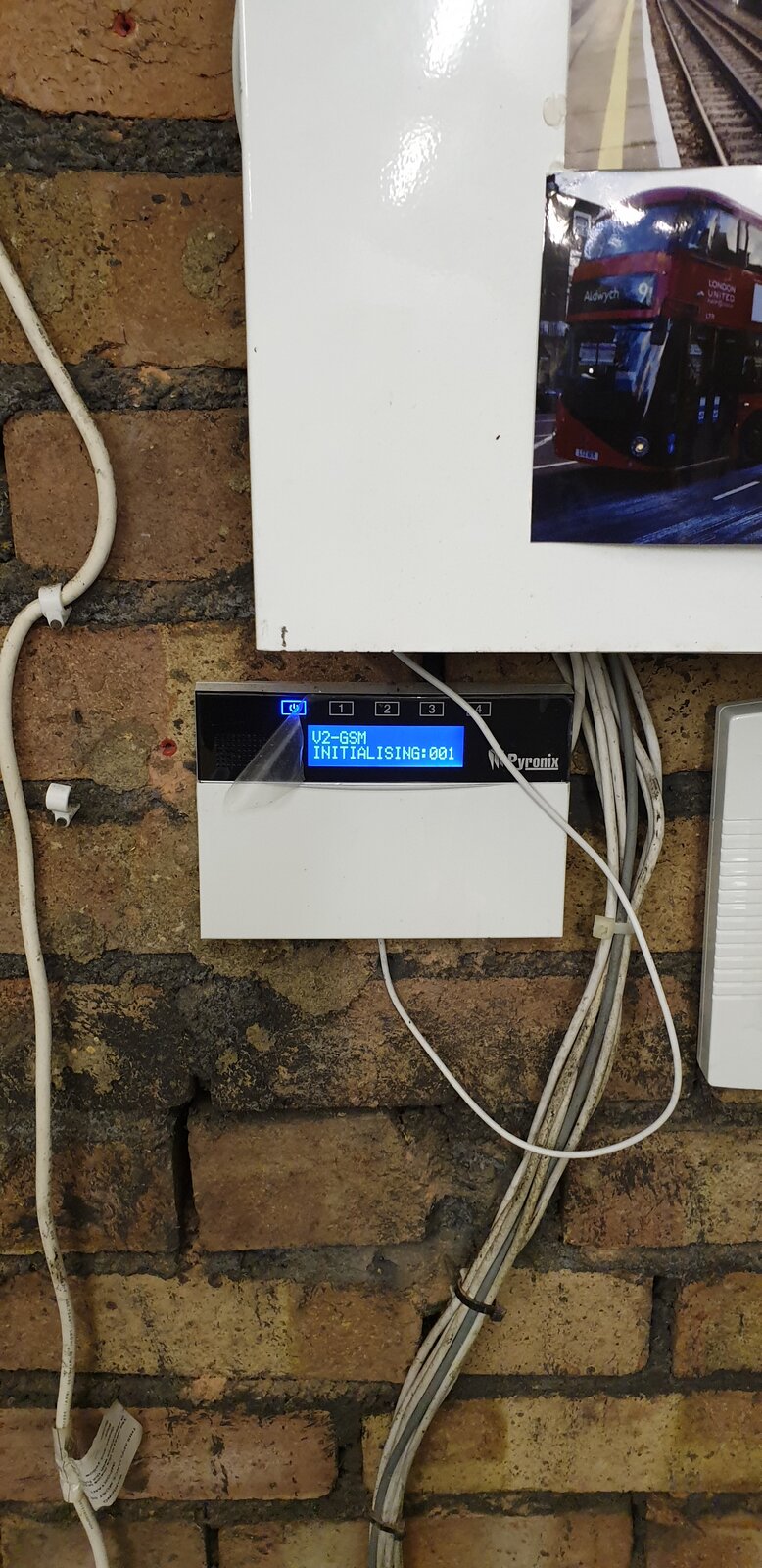

Previously the alarm had a MODEM connected to the landline, for whatever reason the new engineer decided to fit a 3G MODEM. Every time that I happen to be working in the loft, it just says "initialising... 001". That is all it has said for the last 3+ years. Does that mean that it isn't actually connected to the cell service.

It seems to be a Pyronix V2 GSM Speech Dialler
I watched it for a while last night, it says "initiating 001", followed by "initiating 002", then "initiating 003", and then repeats the process. AFAIK, it has done that since it was installed 2(?) years ago. Looking at the product link above, it looks like it should show things like the time and signal strength. It also suggests that it should have been supplied with an external aerial.. The attic has foil backed bubble wrap insulation, I don't think it blocks phone signals though.

Does it have a SIM card installed ? Is it live ? Is It inserted the correct way ? Is it a 2G compatible sim ( as most of these type of units use these ) 3 network sims tend not to work ...

I don't know the answers. Given that the engineer was paid to install the GSM unit, I would assume that his fee would have included the cost of the SIM card. It would be unfair of me to suggest that the MODEM never worked properly. I cannot remember when I first went up to the loft after he fitted it.
If I check the SIM card, will there be an anti-tamper device in play. We don't have the engineer code. He didn't even leave us with entry/exit codes, just 3 fobs. Ages ago I did ask the GF to ask him for the entry/exit codes, he did text her back- it is a 6 digit code...

I am not convinced that will help. A while back I was in the loft doing some re-wiring and turned of the ring. Thanks for the suggestion though, I will try it again.
As I mentioned previously, I don't have a lot of confidence in the guy. He was supposed to return to re-activate the sensors in our garage (which has its own entry keypad) but never did. The key pad is still just dangling there, I suspect that he didn't know how to deal with two different key pads that were initially set up to act "independently" of each other. By that I mean the garage was originally programmed so that you could enter the garage without un-setting the whole house, or by using a different code you could unset both areas (garage and house).
