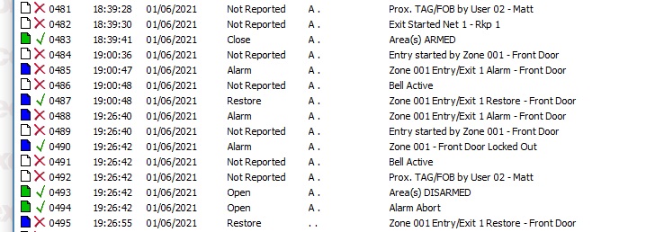

I have a fully wired Texecom system that is about 7 years old. Over the past couple of months, the alarm has sounded twice for zone 001, the front door contact. The magnet is mounted within the door frame so it's all hidden and cable runs inside the wall, it is wired EOL.
When the alarm sounds, I don't get a text alert. When I get home and open the door, the alarm sounds again and only then do I get a text which says REARM LOCK 001.
Attached is the log from Wintex. I had a quick read up on re-arm but I don't fully understand.
Any help would be greatly appreciated.
at default rearm lock is set to 3.
a zone that goes active 3 times during a set is then locked out (doesnt activate a 4th time during that set period) as it is considered dodgy and would continue to trigger the alarm and be a real nuisance.
I would look at replacing the contact.
Making sure the magnet is lined up properly.
short term you could change your PIR facing the door to e/e, program the contact off and change your arming mode to timed.
this way you still have an alarm until its repaired properly

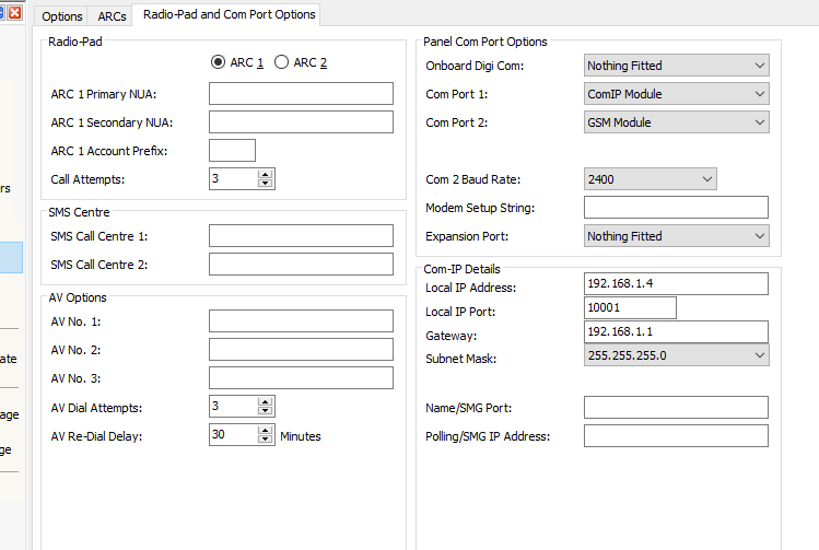

Firstly its an entry exit zone that has timed out, it has activated the bell so it should be seeing an alarm condition.
The panel version I don't know and I don't know the programming of the system and I don't know what coms module you have connected or how and how that is or isn't programmed.

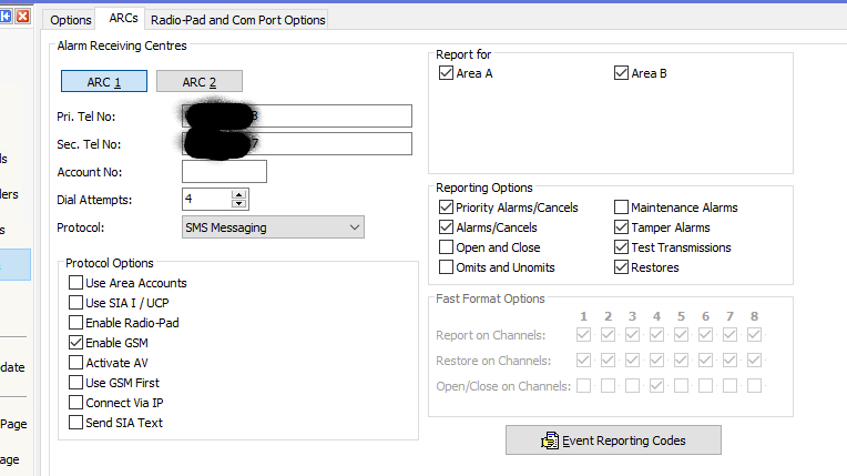

Fair enough. I have the GSM connected. Texting works, it texts when the wife forgets to unarm the shed (seperate area) and it dropped me a text when I got home after it had gone off with this issue but no text at the point it was triggered.
