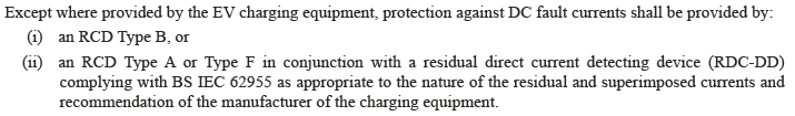

I have seen just two items which state what what type of RCD should be fitted, EV charging points, which often have a detection device to auto disconnect if the DC exceeds 6 mA so can be used with type A, and Worcester Bosch boiler installation instructions which also stipulated type A.
I know some early EV charging points asked for type B, but in the main it seems the 6 mA detection units have got around the problem, and that could be used with other equipment, so the jury is still out as to if you will every need better than type A.

.... two items which state what what type of RCD should be fitted, EV charging points, which often have a detection device to auto disconnect if the DC exceeds 6 mA so can be used with type A, and Worcester Bosch boiler installation instructions which also stipulated type A. ...... I know some early EV charging points asked for type B, but in the main it seems the 6 mA detection units have got around the problem, and that could be used with other equipment, so the jury is still out as to if you will every need better than type A. .... so what we need is a way to measure, so reading this we have the ability to measure and auto switch off the supply when it exceeds 6 mA, so maybe we can include this into the RCBO rather than making it type F or B?
I'm getting increasing confused by all this. What you say above, and what Amd1 of BS7671:2018 says (as below) all seem to be talking about DC residual currents ('due to a fault) ...
Faults resulting in DC residual currents (L-N imbalances, due to DC current leakage to earth) are obviously one potential issue. However, I thought (perhaps wrongly) that the main/major issue was that a DC component of current flowing during 'normal operation' (equally in L and N, hence no imbalance/residual current) could (perhaps by 'magnetic saturation' or a similar mechanism) impair the ability of the device to operate as it should in the event of a residual (L-N imbalance) AC current due to leakage to earth.
Is that not the case? Can someone help me understand?
Kind Regards, John
