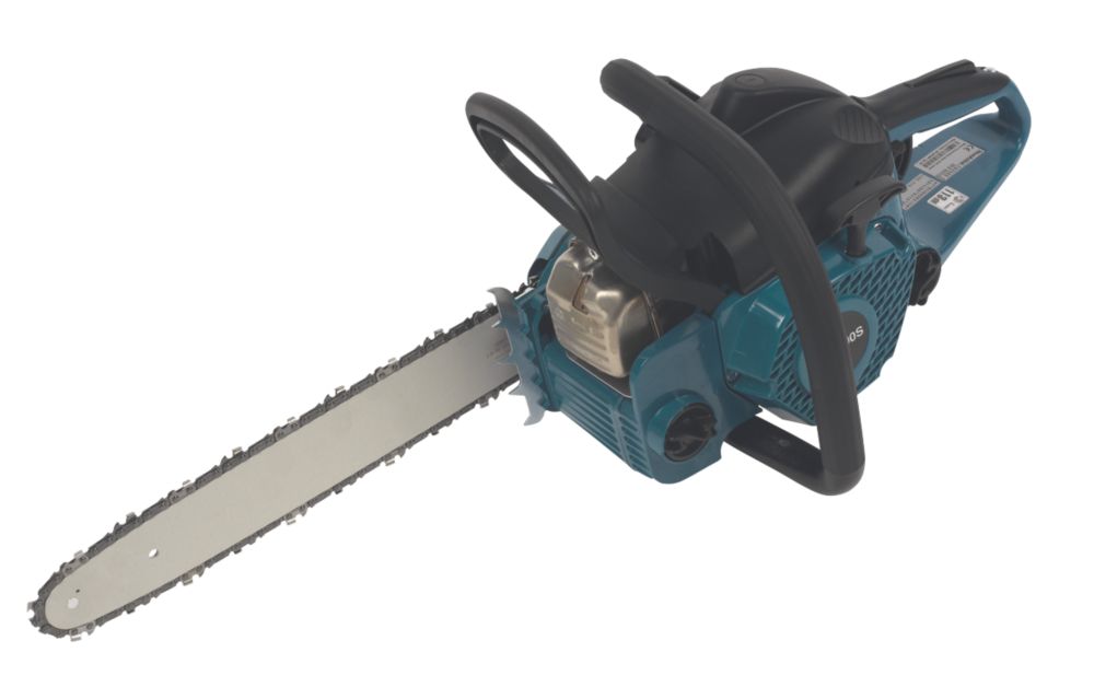

Lol, I dont think they quite used a chain saw!
No, but I have long suspected that they're taught to achieve an effect which is a perfect facsimile of the chain saw approach with axwide variety of other tools. Just based on a few decades of crappy flooring repairs by "certain trades"
