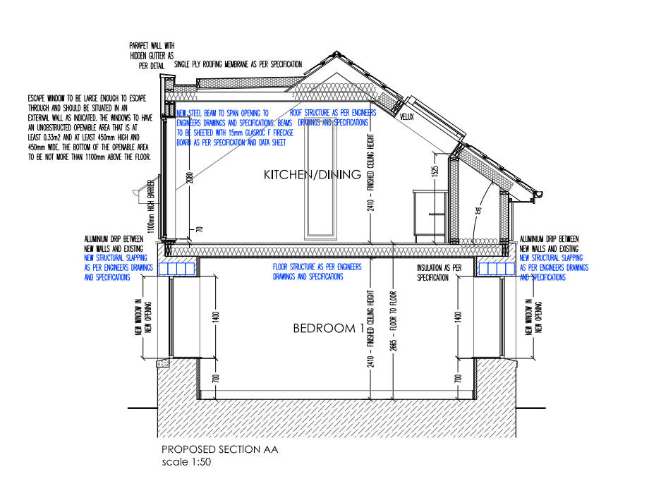

Aluminium Drip ????
14 May 2009
799
14
Dundee
Anyone have any idea where I can get this? See drawing below, he says aluminium drip between new timber frame and brickwork. I am not finding anything online, maybe using the wrong words, anyone know of this stuff and what it is called?

It will probably be bespoke and ordered from a local metal fabricating workshop.
3 Sep 2006
36,495
5,149
West Mids
The plan drawer has copped out, with just adding a few words and leaving it to others to work out.
It looks like a cill cover piece common on retrospective aluminium frame installs, so try such a frame supplier.
Or use lead.

This was my thinking, thank you will have a hunt around, do people till use lead :) lol
