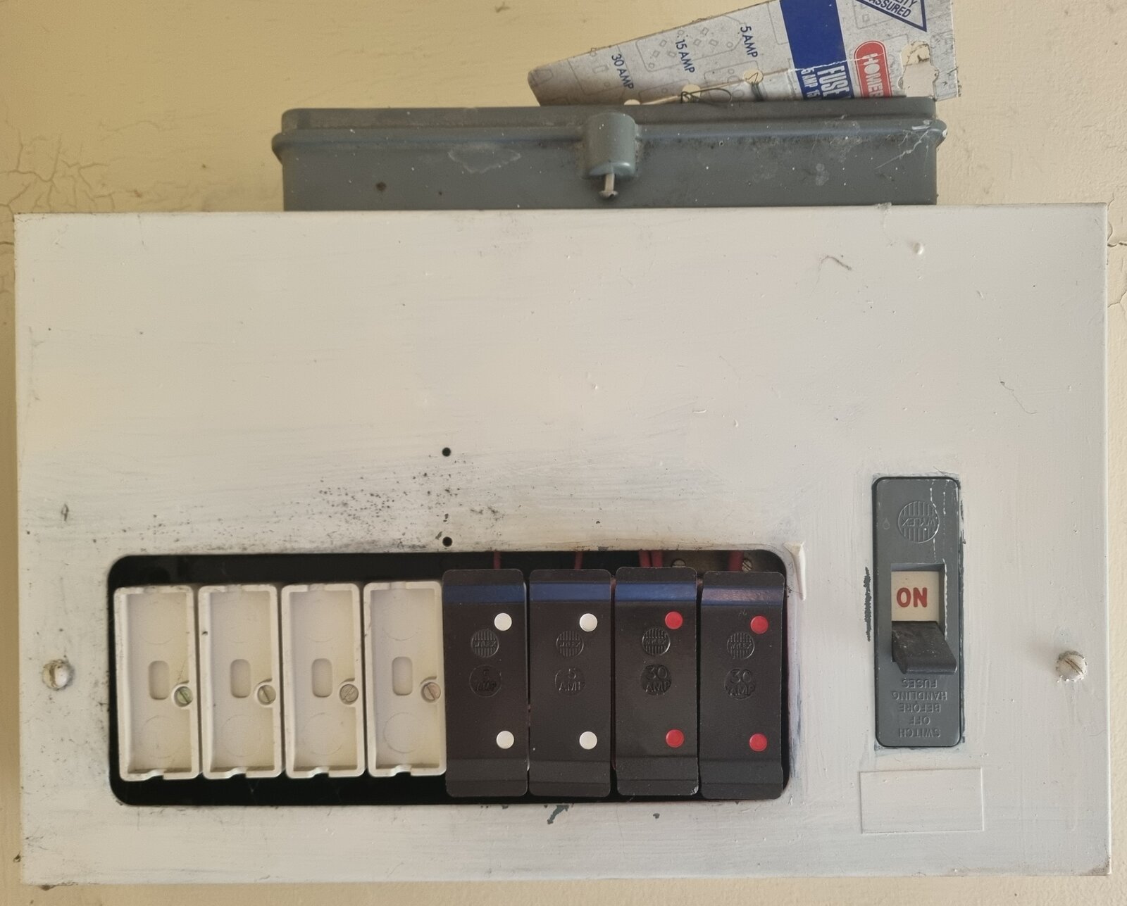

We've seen it, and you don't need the quote marks - it really IS a fuse box![]()
Most people, call them 'consumer units', these days!
True, although (as we often see here) a good few call (modernish) consuner units "fuse boxes", tooMost people, call them 'consumer units', these days!

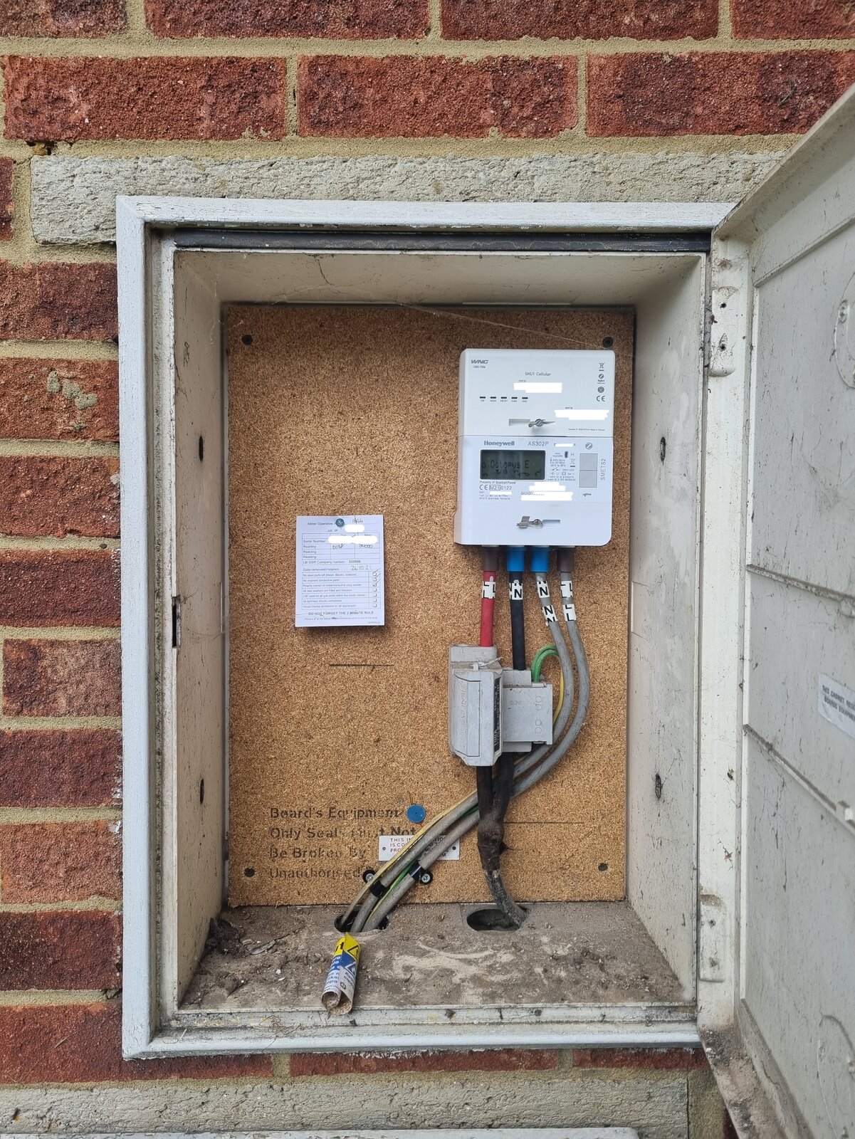

I'm not keen on drilling below the meter box because that's obviously where the incoming supply and fusebox tails run and the concrete lintel visible at the bottom of the picture is the Gas supply and meter cabinet.

What exactly do you want this thing for?Got a free Shelly Pro 3EM
They already have a smart meter.
If you want to see energy use in real time, just get one of these: https://octopus.energy/blog/octopus-home-mini/
Photo of the meter has 'Octopus E' on the display.Maybe the OP is not on Octopus,
I'm surprised there aren't more wireless/battery CT-clamps..
Yes, might turn out to be an expensive or useless freebie. .... Got a link for this Owl device? I'm surprised there aren't more wireless/battery CT-clamps..
Other than perhaps in some relatively new houses (with situations like yours), the meter tails are usually very accessible, so there is rarely a need for a non-cabled connection to the CT clamp.I did look for battery powered clamps but only found some sketchy information about a chameleon CaT-clamp
I have the home-mini, but it's not realtime in that the data is collected from the meter and uploaded to octopus and then made available to the API and not available for 1-2 minutes depending on api rate limits (100 requests per hour)If you want to see energy use in real time, just get one of these: https://octopus.energy/blog/octopus-home-mini/
I want energy import and export in realtime. The shelly is part of a DIY plug-in Solar setup. With this, I can automatically maximise self-consumption/storage and minimise unpaid export.What exactly do you want this thing for?
