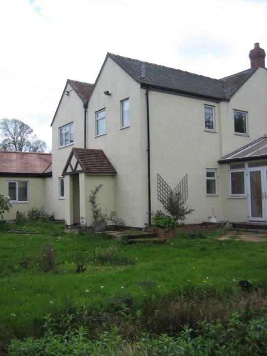

Currently have an external meter box fitted to our property, which, to be honest, is pretty darned ugly. Its of the recessed type.
Smarten it up, then. Replace the door? Clean it & paint it?
I am looking to get this changed to TNCS with a 100Amp supply....I need to install a 60A fused isolator (plus associated 2 pole henley blocks) and a second meter for a submain and there is insufficient space.

Looks as if I am chasing out then doesnt it! :wink: Seems bl00dy ludicrous to route 25mm cable UP the same wall that 25mm incomer cable routes DOWN from...
So the overhead cables arrive at the building at eaves height, and then run down the wall to the meter box?
Yep,
If you look on the pic, the insulators are above the left hand windows above the first floor. The cupboard I was hoping to move the meter to would have the wire entering the property level with the base of the window, between the window and the downpipe. From there it would run straight to the meter and service fuse. The meter box is behind the (ugly) porch, so, in effect, I would have 1 wire down, to the meter+ tail back up to the window, which is quite difficult as I understand 3 metres is all you get as far as tail length goes...
