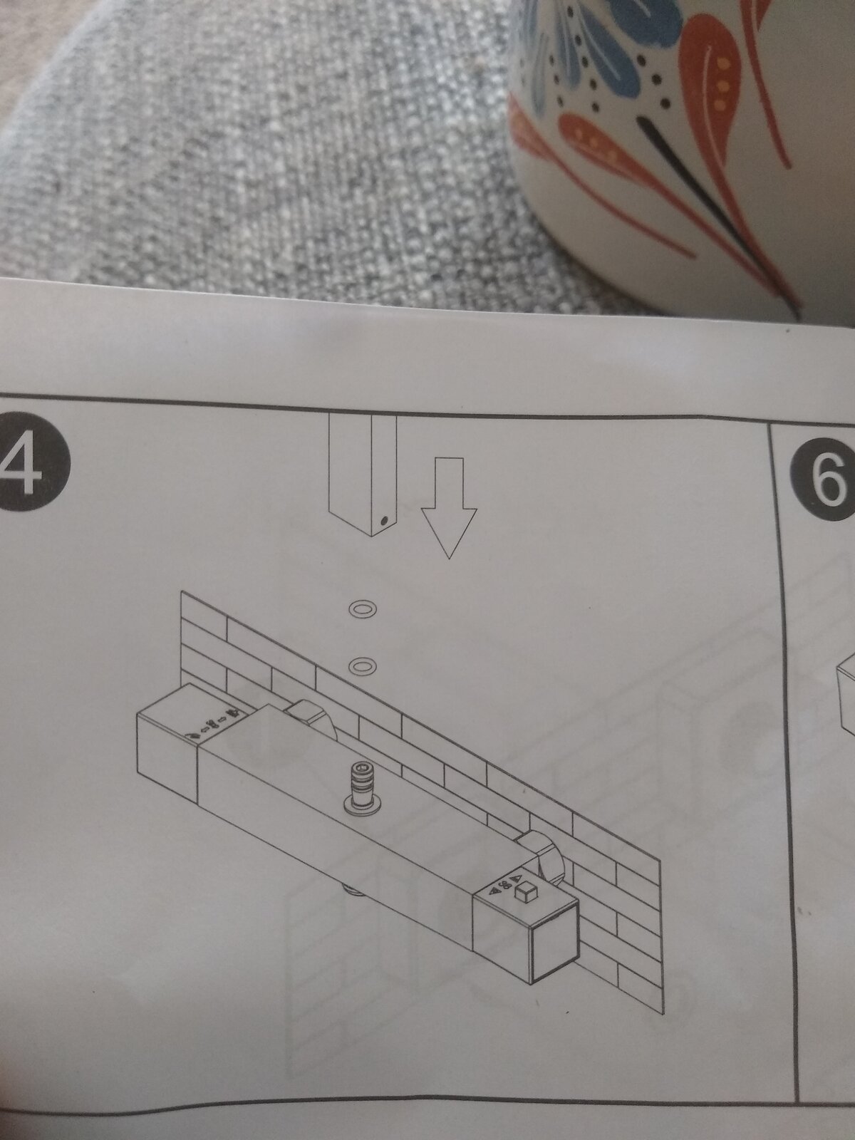

Where the shower rail connects onto the mixer the instructions say there should be 2 rubber seals that it sits on.

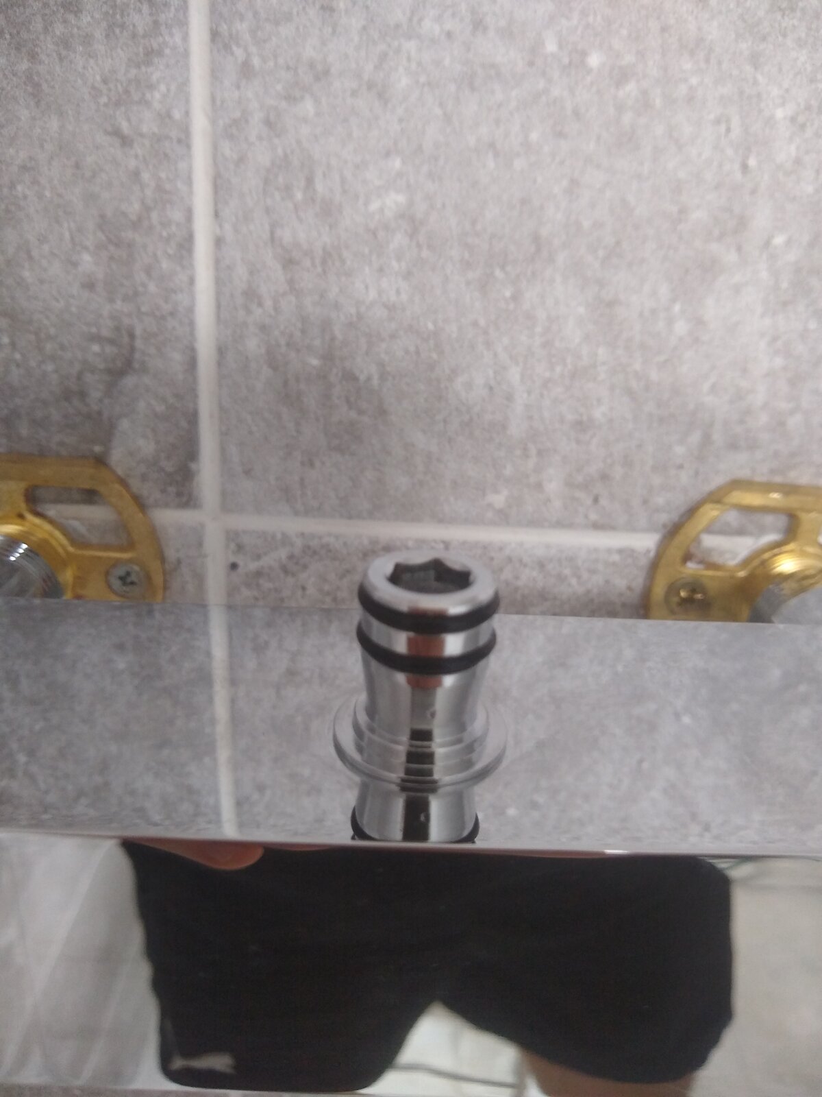

There is no rubber seal in the packaging, just these 2 rings on the mixer bar
p.s. I know I'm missing the caps they're going on after
Yup, just the 2 o-rings that are already on the spigot. A little silicone grease, if none on already, and you're away.
Ah right, so does it literally sit on it?,
It looks like there should be another one at the bottom but obviously not
A lot of MI's do that. Think it helps them to show you that such items are subject to wear and tear and can be "replaced".
