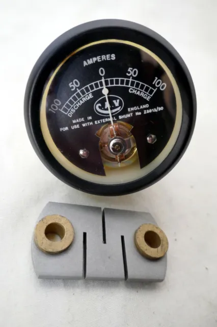

I showed this picture View attachment 307693the current goes through the large terminals and at the top the small plug has the very small voltage that goes to the meter, the old CAV used the same shunt to work ammeter and alternator control View attachment 307695 The metal lump shown below turned current into voltage, it could be trimmed with a hack saw.

as I mentioned, if you introduce a 0.1 ohms resistance and measure the voltage across it with a cheap multimeter for example then for every amp of current or thereabouts you would actually see a voltage of ten volts.
Your accuracy of measuring that 0.1 ohms in the first place, the accuracy of the voltmeter and the relative temperature range you go thru will all effect your measurements.
If you have a bit of copper plate (say an old Busbar) and measure the resistance, then calculate the length you need to produce a certain resistance then you are well on your way.
Your initial 0.1 (or whatever you decide to use) does not need to be deadly accurate, aim at it then measure it and say for instance its measuring at 0.136 ohms then you can still use it and do the equations accordingly.

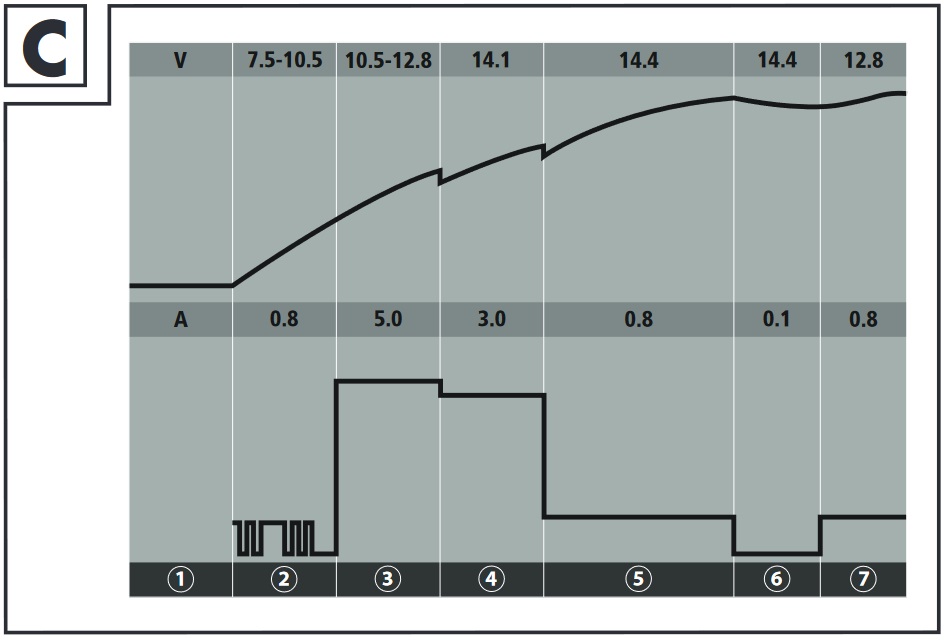

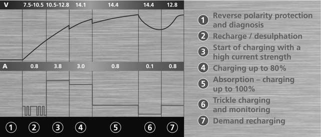

The ammeter will tell you very little, same with a volt meter, if I look at my battery chargers they have a chart
from this chart you can see the battery is considered fully charged when the current drops below 0.8 amp.
Same with the latter model, to know it has reached fully charged state number 6 on both charts the rate has dropped from 0.8 amp to 0.1 amp,
I have recorded this with a energy monitor and even when fully charged it will keep topping up, and the amount of time and energy slowly reduces.
So in real terms you would not want to run a generator long enough to fully charge the battery, this is the problem with narrow boats, they only run the engine for maybe 8 hours, so they want to cram as much as they can into the battery in the 8 hours they have, Sterling Power do special alternator to battery chargers designed to try and cram in as much energy as they can, the DC out of the alternator is turned to AC and then transformed to voltage required then back to DC and the alternator voltage is kept low enough to ensure the alternators own voltage regulator keeps the alternator producing max output.
These are very expensive, so the alternative is a shore supply once a month for at least 24 hours to top up the batteries, many canal side pubs offer charge points. Today the solar panels and wind chargers have changed what is required, but a panel ammeter or volt meter are not really going to help.

The ammeter will tell you very little, same with a volt meter, if I look at my battery chargers they have a chart View attachment 307803 from this chart you can see the battery is considered fully charged when the current drops below 0.8 amp.
I am very confused by this!
there are two diffarent chars showing nealy the same amps going in, but completely the opposite resalts
So as from your last chart; are you saying its more efficient to charge the batteries upto a certain point and less efficient to fully charge them. But is needed to do so to prolong the life of the batteries evey now and again with a trickle charge?

As I think has been said, or at least implied, if they were suitable (and if yuou didn't have your problem with eBay!) there are always plenty of 'vintage' 30A-0-30A, 50A-0-50A and 60A-0-60A ones available, quite cheaply on eBay.
Kind Regards, John
Good idea plenty of second hand junk on ebay, some a scam some not, but I think something like this would be OK

8.3 amp is enough, with a stage charge the first stage at high amps is quite short, the problem with the lead acid battery is it will only absorb the charge slowly, the time taken is variable and depends in the main how long it has been discharged rather than by how much, the sulphur hardens on the plates, so left discharged for 6 months it could take a couple of weeks to charge, but it also means a battery discharged for a day takes longer to recharge than one left discharged for an hour.
If the battery is not fully recharged then you have some sulphur left on the plates to harden, so going back to the 50's with dynamos, we would put on an equalising charge over night once a month. But back then we had flooded batteries so we could top them back up, the early sealed batteries were in fact still flooded, they just had a vent system designed to recycle the water, latter we went to absorbed glass mat, (AGM) but both need a battery charger that will not over charge them, looking after fork lift batteries it was not unknown to use a gallon of water to top them up, same charger with AGM would kill them.
So if we take the 5 amp charger as an example, as the chart shows there are in real terms 4 stages 5 amp, 3 amp, 0.8 amp and 0.1 amp, the switch between stages is triggered by voltage, so we have looking at basics 12.8 as lower limit and 14.4 as upper limit, and if the lower limit is reached the charger steps up a stage, and if upper limit reached it steps down a stage, and when it steps down to 0.1 amp it is considered charged, it will continue to take charge after that point, but very little.
So with a non stage charger just a fixed voltage we can use the current instead, how much depends on battery size and condition, so if it were me I would fully charge with the stage charger first so I can measure the amps when fully charged, I would think likely 0.1 to 0.2 amp, this would present a problem, to measure 10 amp, and be able to see when down to 0.1 is too much of a range. So it would need a by-pass so it only measures up to 1 amp but is not damaged sending 10 amp through it. Likely a large diode would do this, the 0.6 threshold voltage would be enough to work the meter.

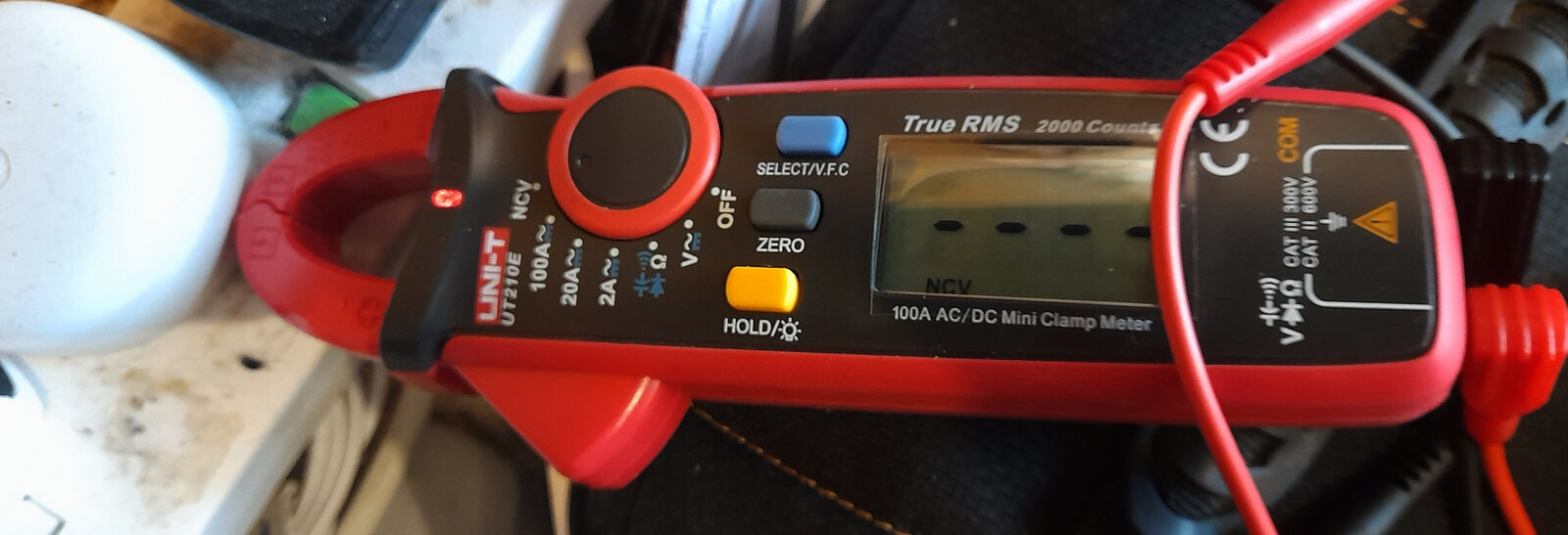

The cheapest tool station multi-meter will measure 10 amp, cost £20 and is digital so can also measure 0.1 amp on same scale, it does not say much about the meter, but I note separate terminal for amps, so likely a shunt built into the meter, so seems likely it will let current flow even if meter switched off, and mA range uses the other terminal, so seems likely switching through the mA ranges will cause no problem.
Personally I would use my meter, Testing for live.jpg and leave a loop of wire on dash to clamp it onto when I want to measure, I get so much more by paying the extra £15, but tool station version is £123, this is the cost of having upset ebay.
