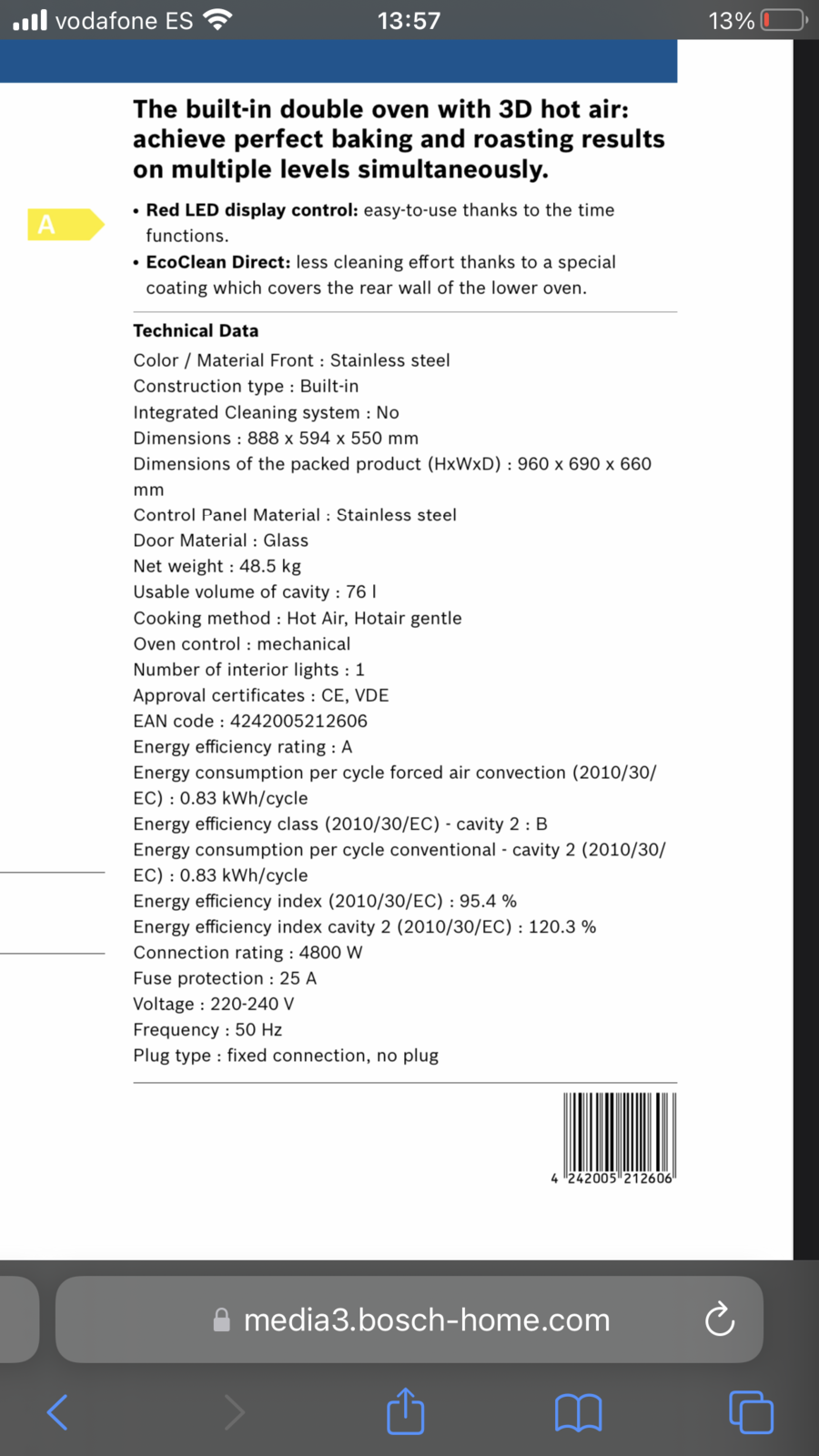

This oven states 32amp rating but further down, states 4.8kw as total load. Doesn’t 4.8kw equate to 20amp?
Trying to determine the breaker size for this.
I’ve got a massively oversized 10mm cable!
The breaker is to protect the 10mm cable. The oven on the end of it is irreverent.

That is true for items which are portable, and plug in, the MCB/Fuse/RCBO is to protect the cable. But for equipment which is installed, the manufacturer can, and often does stipulate the protective device to be used, I have had machines with solid state relays stipulate must be protected with a semi-conductor fuse, a MCB is no good.
And the oven is installed, not simply plugged in, so you should follow manufacturers instructions, or at least take them into consideration, however the link is an advert not manufacturers instructions.

Can't see there being much of an inrush with an oven, but elements can draw more when cold then when hot, so I would follow the manufacturers instructions unless you can see it is one of those times when manufacturers have issued blanket instructions for all products which clearly don't apply in this case. I have seen instructions on fitting a plug with battery powered equipment, so need to use some common sense.

If you were starting from scratch for the minimum requirements, yes - load/design current, equal or next higher rating MCB then equal or next higher rating cable.
20A oven, 20A MCB, 1.5mm² T&E.
However, you already have 10mm² cable in place so (if method C) you could have a 63A MCB.
The cable should be at least the rating of the Protective Device.
Yes.

If I had a 63A MCB in the current situation, won’t that be wrong for the oven I have in place? If my oven develops a fault and starts to draw more current (than the suggested 32amp), the breaker won’t trip until it reaches 63A.

It won’t trip at 63 amp either.
I have already told you that the breaker is to protect the cable not the oven on the end of it.
The oven should be internally protected if required.
Ovens cannot draw more than their design current.

I conclude that I could have anything higher than 32amp (minimum based on oven) and lower than 63amp (max supported by the 10mm cable).
I think @winston1 initial response left me with the impression that just because the cable is 10mm, I should have an equivalent breaker. This may not have been his intention.
Assuming the summary above is correct and I have the choice, are there any pros and cons for a 32a v 63a breaker in this situation?
