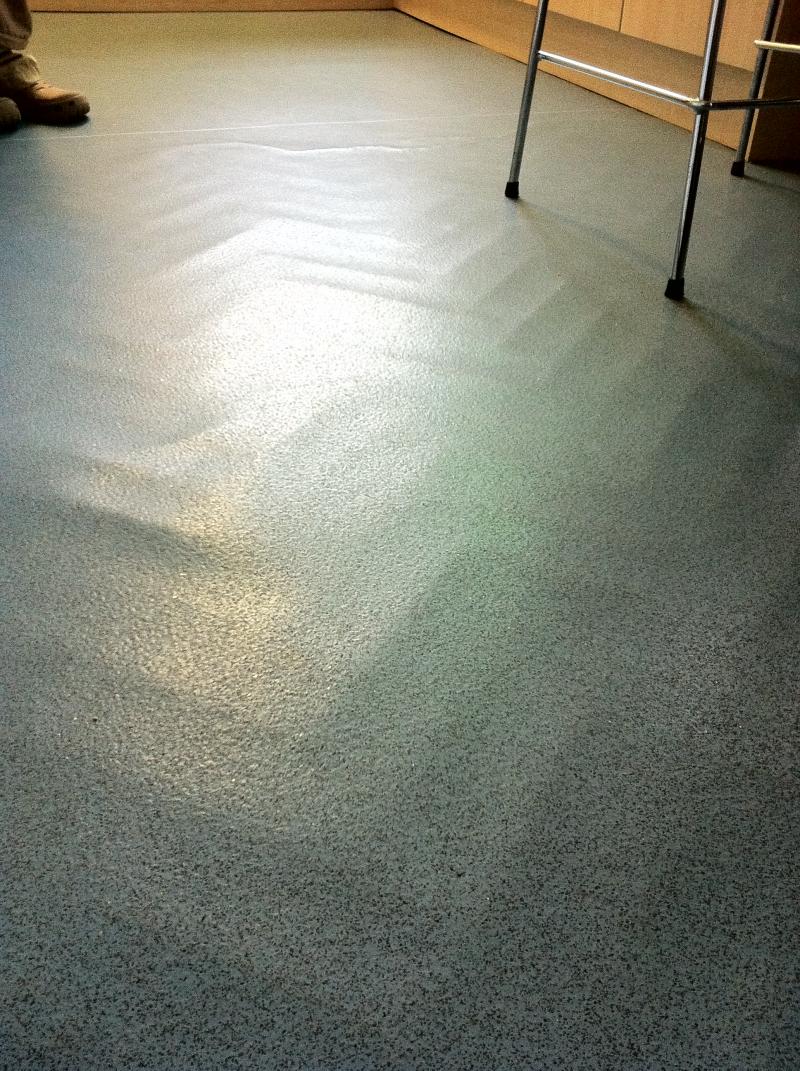

The new concrete floor dries at 1mm a day for the first 50mm then longer for thicker screeds.... so say a 6" screed it could take a year. so that will need a dpm
The old concrete floor dont have a dpm so it needs one to have amtico down, now if you take a reading now the floor could read dry as its breathing. But once amtico is laid its not breathing so any raising moisture will be trapped under the amtico and bingo it will come up.
You can take a risk mate and if you do good look but i'm trying to tell you the right way.
This is what can happen

EXAMPLE - new concrete 40mm deep should take 40 days to dry. But if RH above is say 85% rh then the concrete will never dry low enough to have a floorcovering.
The above is the reason why our BS says use a hygrometer on EVERY subfloor.
