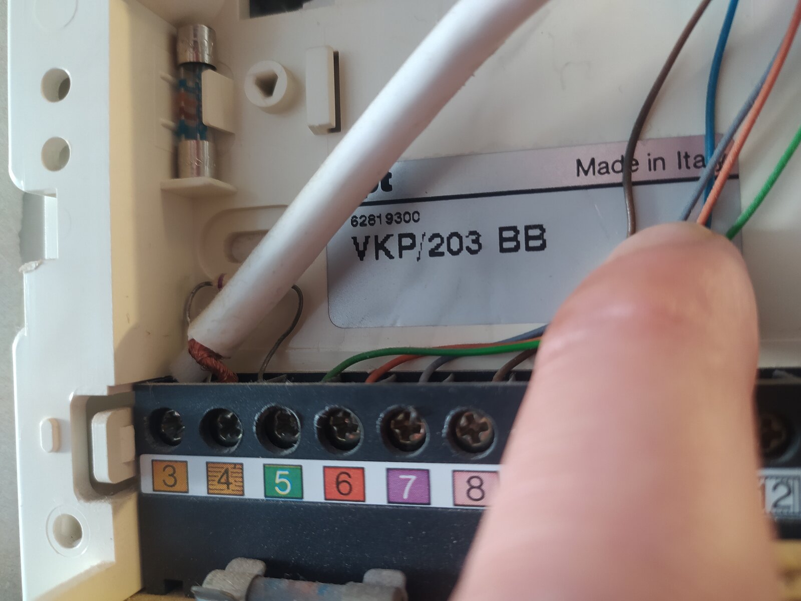

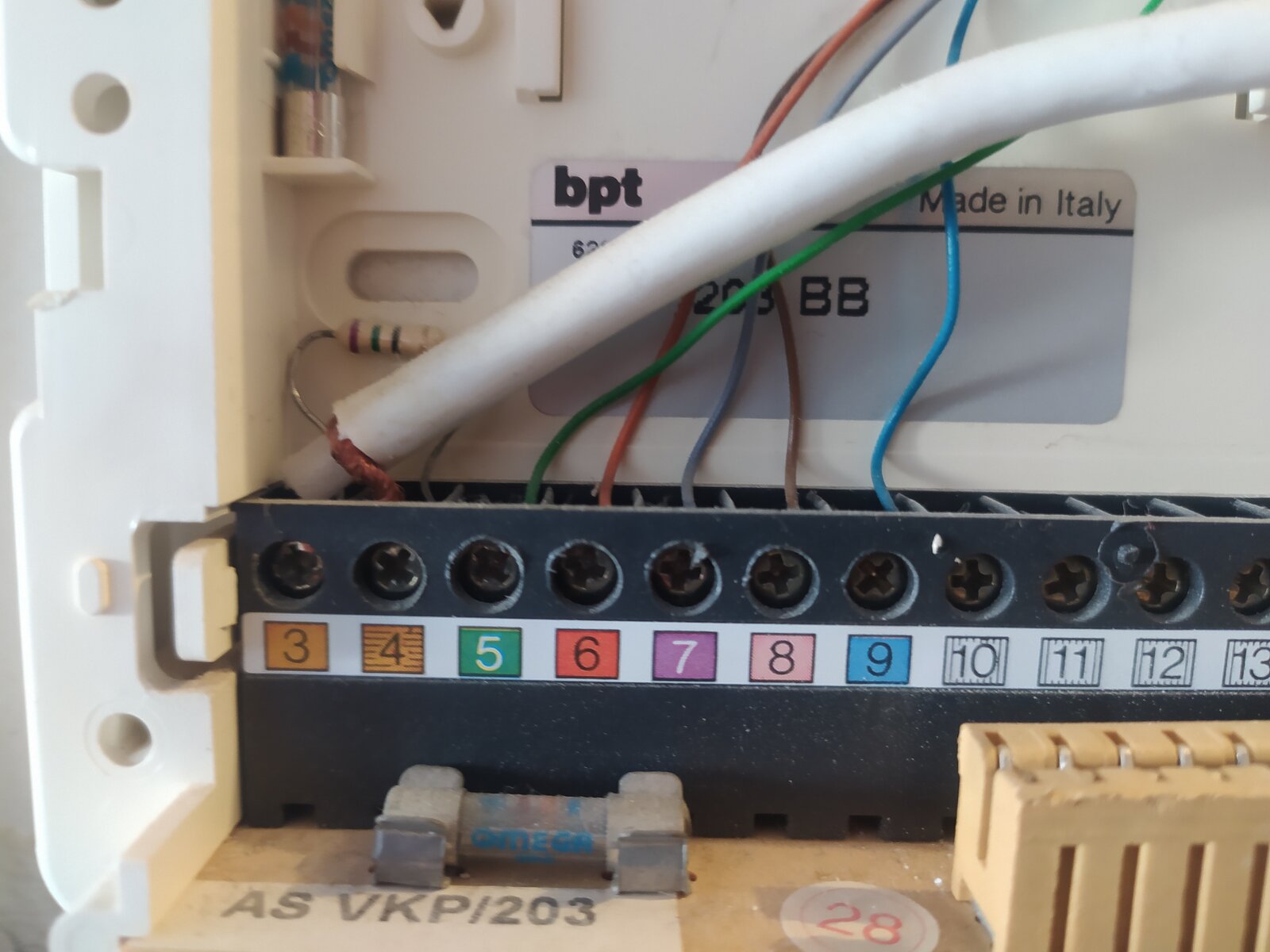

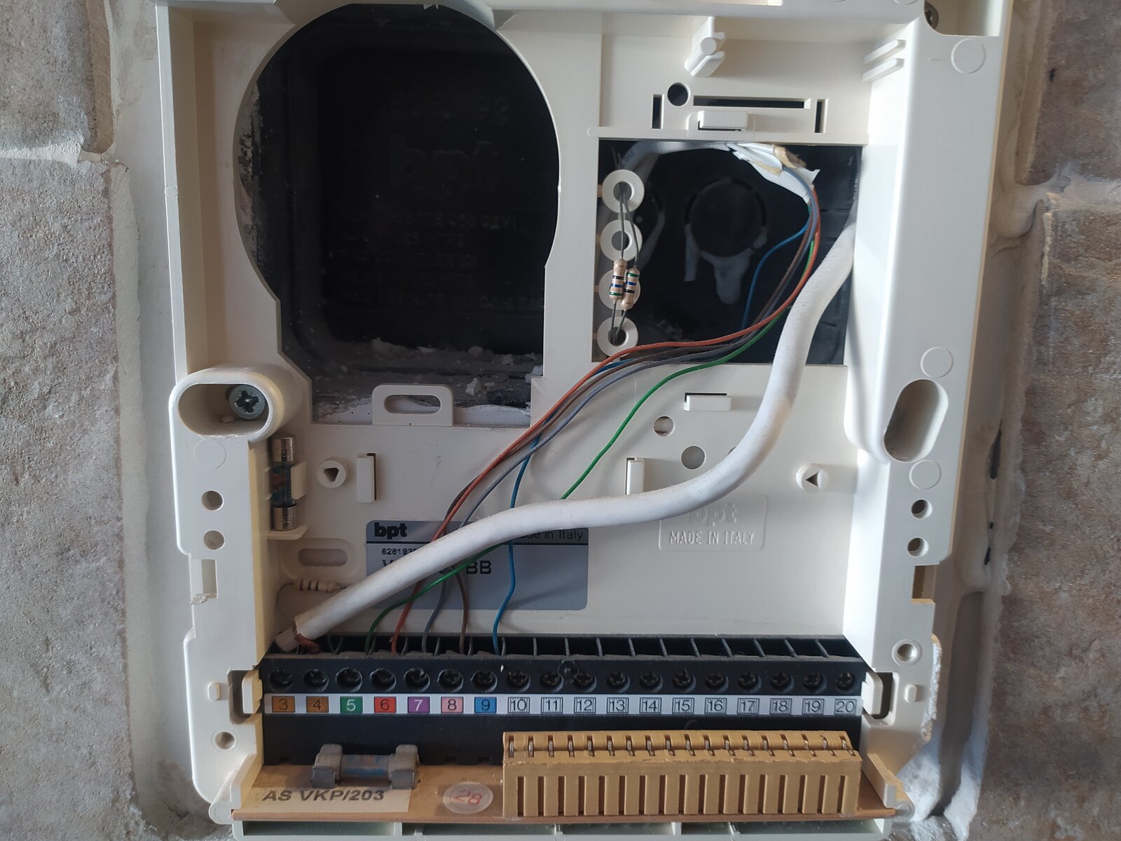

Hi all. I just moved to new apartment and want to upgrade the entry handset+monitor. As i know it is analog and very old. Found in AliExpress analog intercom with touch screen but don't know how to wire it. Also thinking to buy analog to digital converter. I attached some pictures of my old intercom wiring.

Ok so you have a bpt intercom system ….is it just your apartment or is a multiple block ? I wouldn’t buy anything of Ali express as most of it is rubbish …
Thanks for replying.
We have 15 apartments in the same building.
Not everyone agree to change all the system so i want to change my apartment indoor monitor
You can’t do it then it won’t work and you may damage the other peoples intercoms
BPT…..MIGHT ….do a more modern compatible monitor/ intercom unit , you would be better emailing BPT tech support
