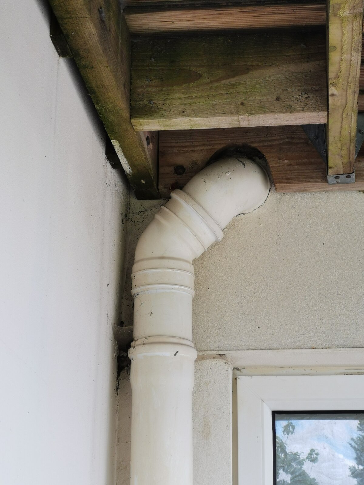

Well that didn't work......this is the soil pipe was thinking maybe adding a junction which would mean cutting some of the decking above into a reducer and venting above the gutters or possibly squeezing an air valve just under decking level, would this be ok?
Is there a ventilating stack on your property or nearby?
All soil pipes/sewers need to be vented both positive and negative. You mention that is decking? Is that elevated and was a later addition? That piece of stack may have been a normal vertical vented stack and then to cater for the decking, the branch and vertical was removed and then the horizontal run was just connected directly to what was left of the stack. As it is it sounds like the drain/sewer is vented by another stack so that's great, that means that stack specifically may be restricted or somewhere further upstream closer to the shower and basin waste pipes.
