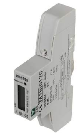

It costs me £1000 per year to have an annex, if I remove the doors and fit a garage door I will not need to pay it. So council tax alone it costs £20 a week, then I have electric, water and oil costs, so likely looking at £40 per week to have it as a flat rather than a garage. Plus it would make a rather good workshop.

This would ensure the main house did not loose a supply due to over load, but would mean my daughter would not be able to use the shower, only the bath could be used, and using more than one ring on the cooker could also trip the supply. To date the DNO fuse has never blown, and we have no good reason to limit the power to the flat, but once we do have problems, then we would need to consider do we want any more than a double socket in what after all was designed to be just a garage.
