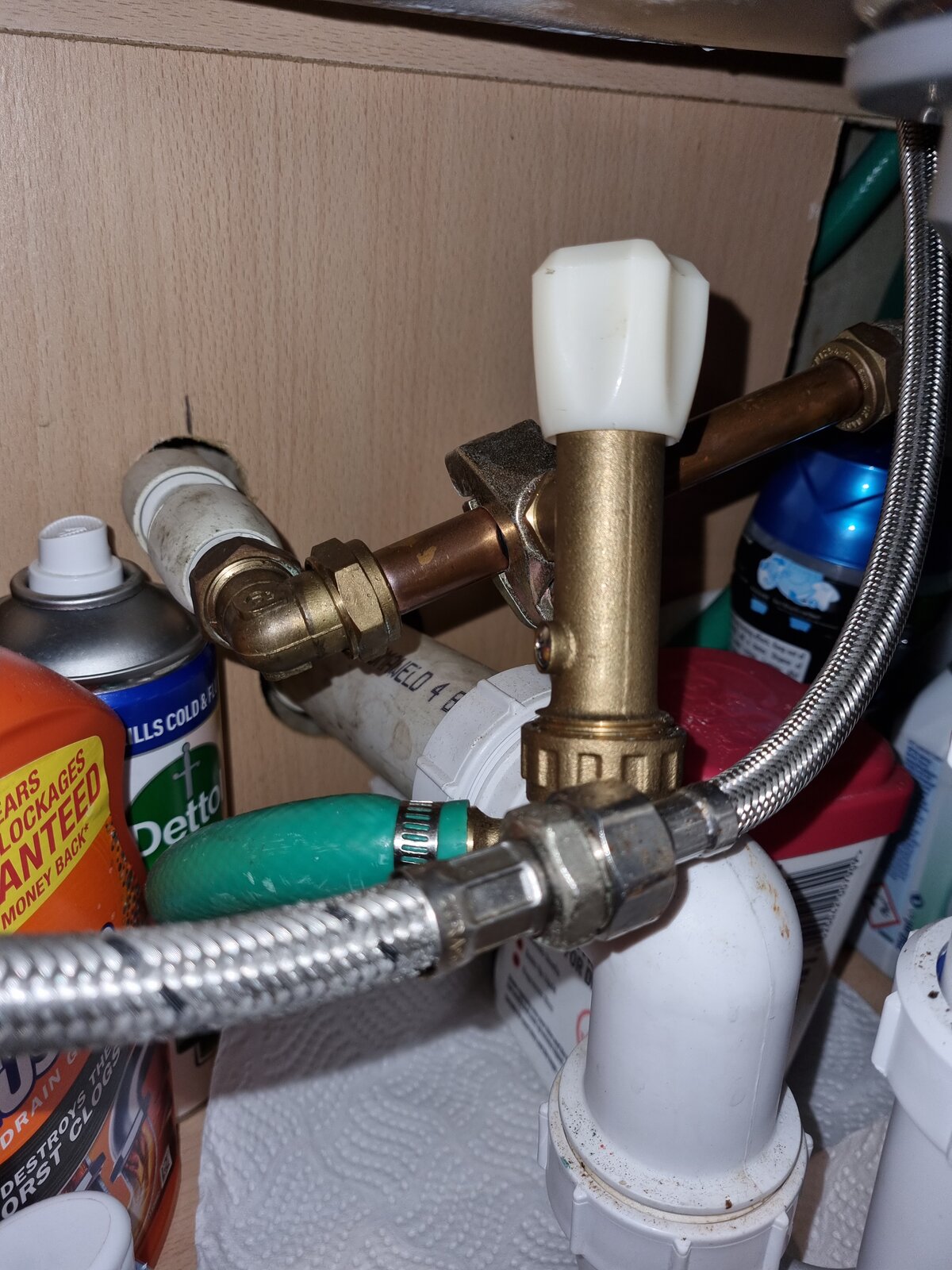

Thanks for that. Above is what I'm working with, anything here as a drain point?
If the white handled valve is the supply to tap ,close it. Then undo the nut at the bottom where the feed to outside tap goes. With outside tap open( turned on) , water will drain ,have a bowl or a towel handy where you undo the nut.

Yeah white handle is supply to tap.

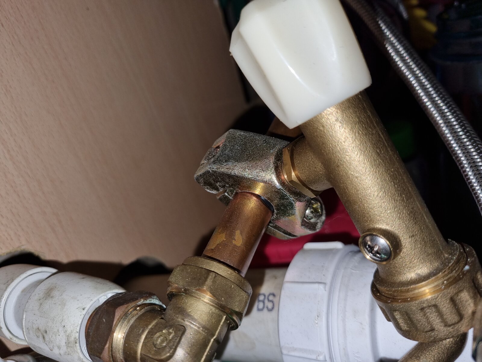

Also, any idea what the screw on the side is? I wondered if it was to allow air in
Screw on side is for the non return valve ,leave that alone.

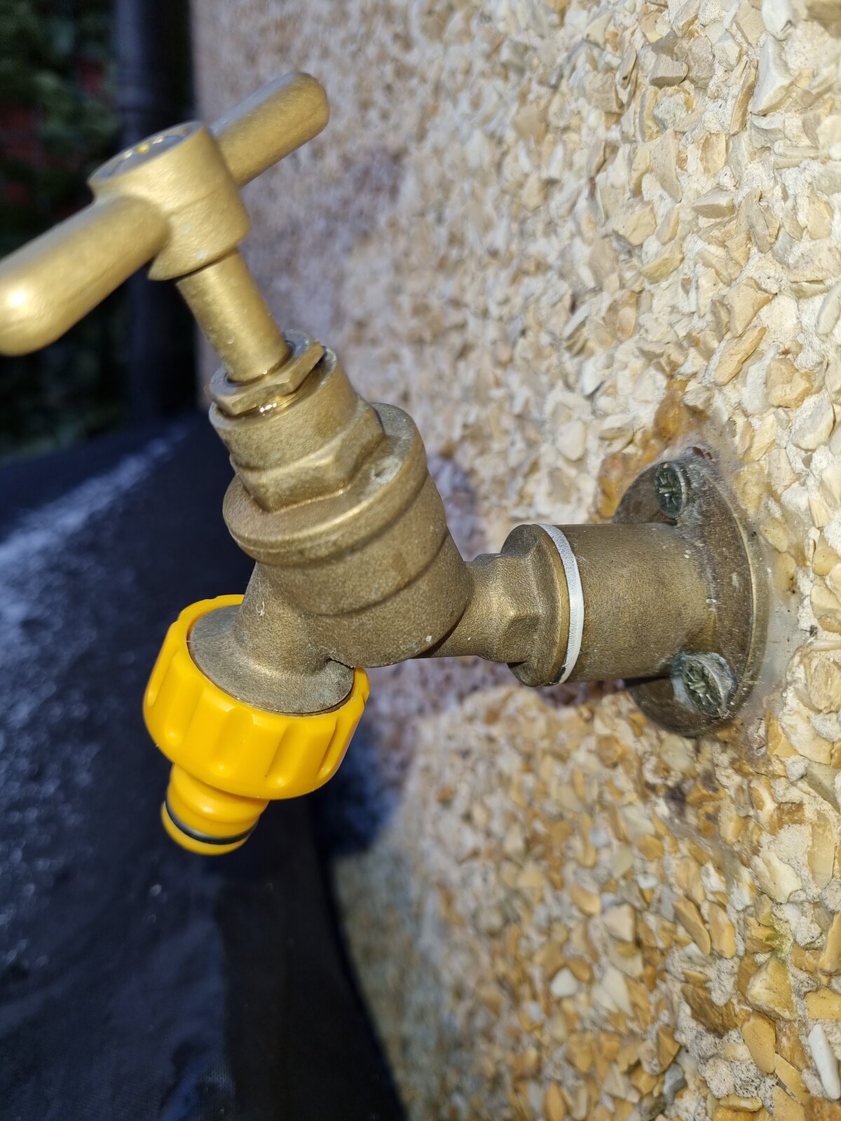

You could of course undo the jubilee clip and pull off the hose ,show us a pic of tap outside.

Tap is below. Just in case there is any ice in the pipework (been -8 here for a few days) I've left the white handle isolated and the tap very slightly open. Once we've thawed out a bit I'll open the fitting to allow to drain, will likely wait till after Xmas though just in case anything goes wrong and I need a plumber, any particular issue with doing this?
