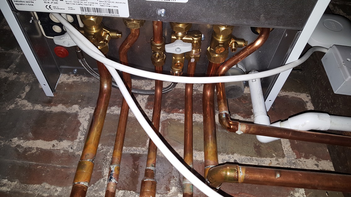

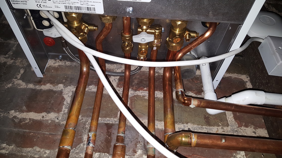

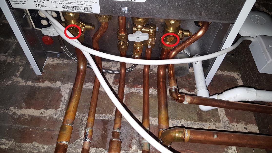

Chaps, what do you make to the pic below? You can see the two valves on the filling loop but I was hoping there was going to be a pipe to the left of the left hand valve. There isn't. Now I'm confused.
I'm also concerned that I seem to have a plastic pipe as my pressure release? Is that right?
The valve probably connects directly to the heating iso valve.
The plastic pipe on the right is the condensate drain which must be plastic.
The expansion relief is the one that comes out in copper in front and goes around the trap.

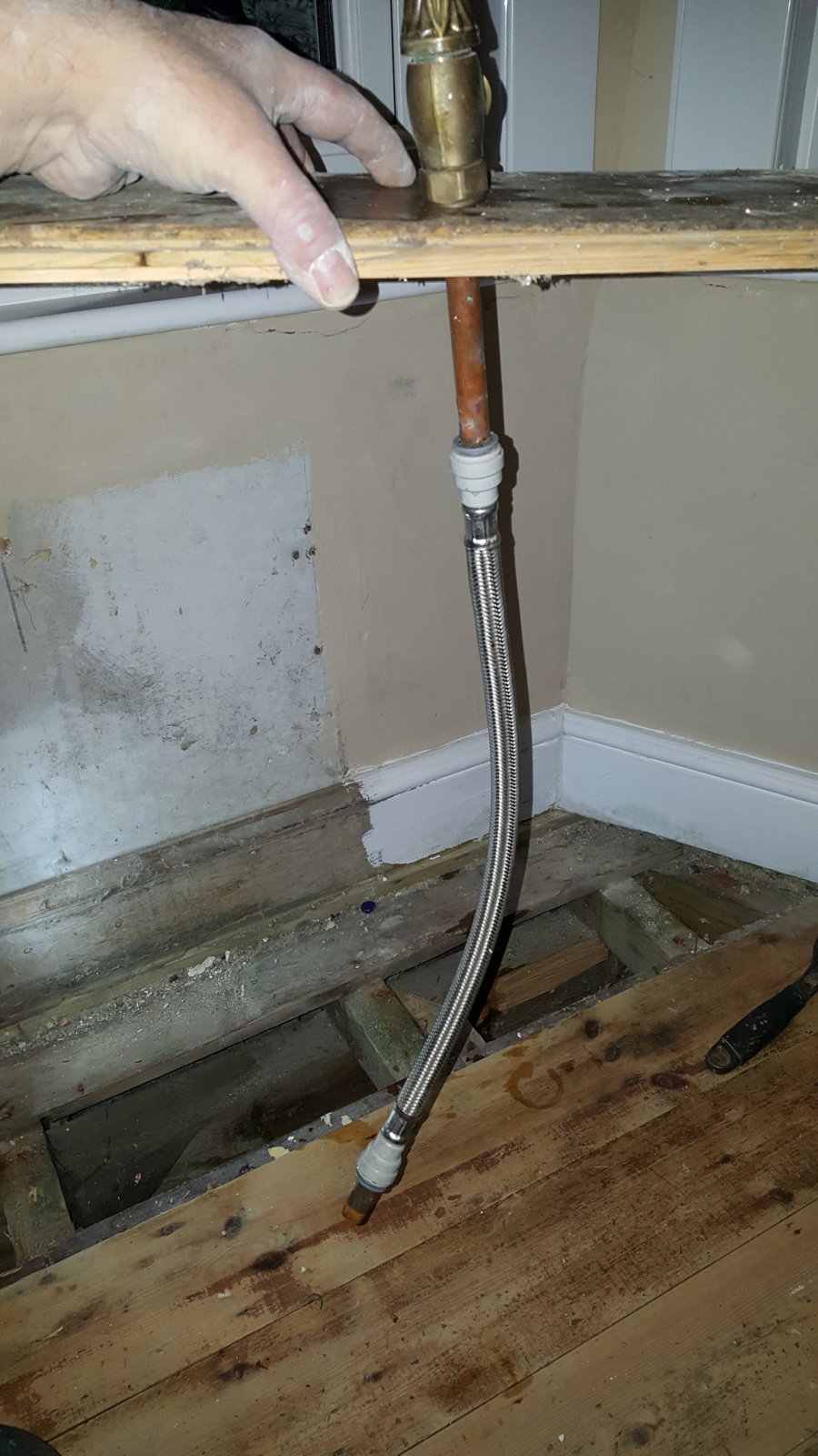

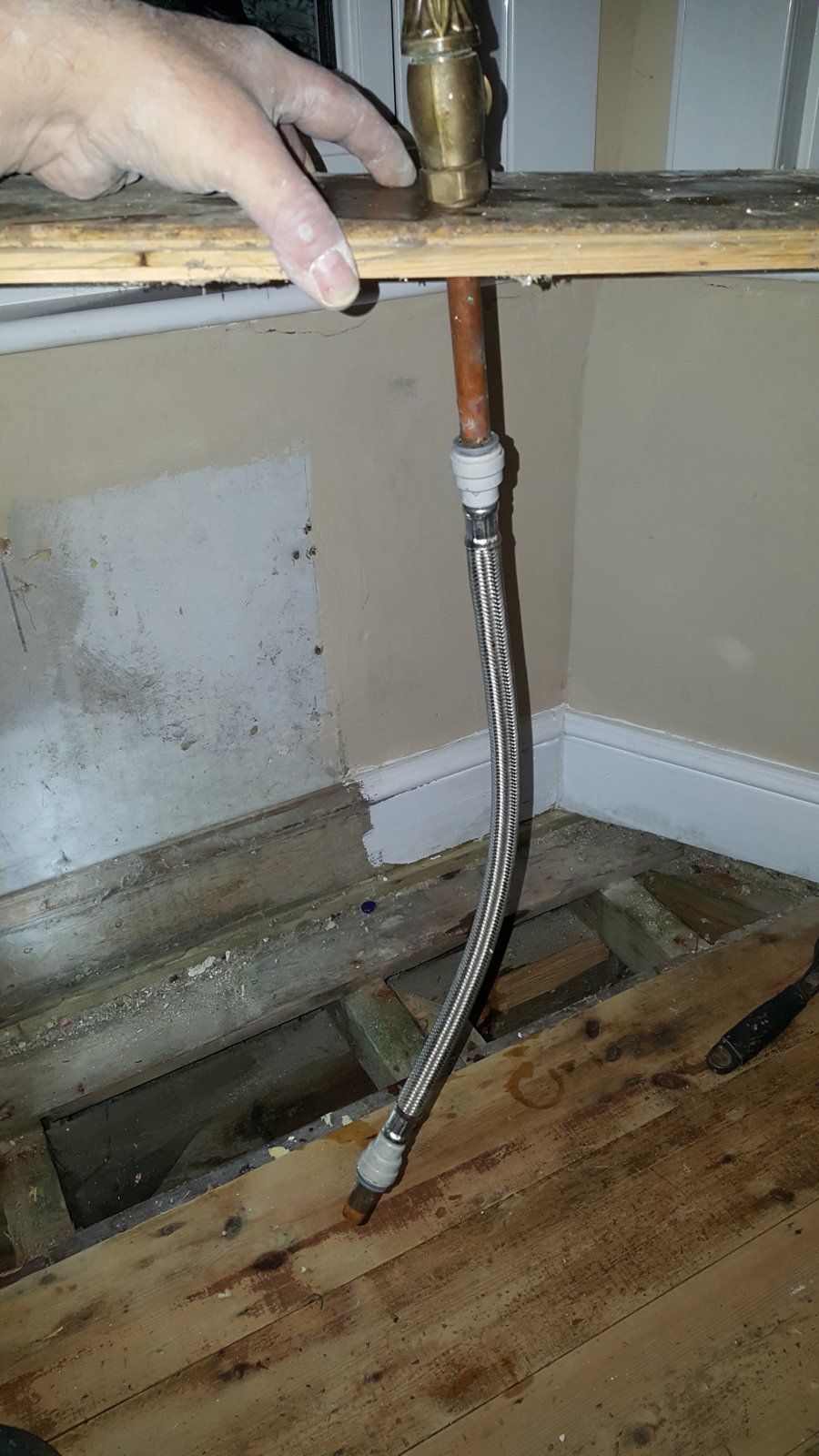

Another update: Plumber/builder came round and took up the boards near the rad. Both flow and return had flexible metal pipe installed under them and they'd both burst. Presumably because of the recent bout of cold weather (and the fact they shouldn't have been used in the first place). Two hours later with some new copper everything was put back to normal. This morning we woke up to a warm house and hot water. Happy days. I've put a mixture of inhibitor and leak seal into the Magnaclean so fingers crossed the pressure will hold. I will check tonight.
In hindsight this was not a job I could have done myself so glad I didn't tackle it though I have learnt a fair bit regarding our CH system in the process. I am also quite proficient in draining and filling the Magnaclean :)
