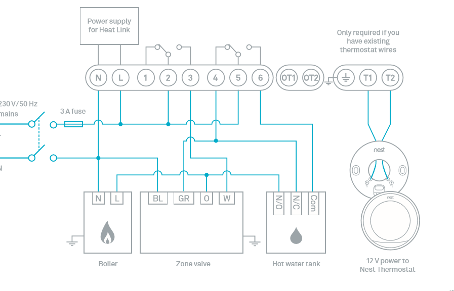

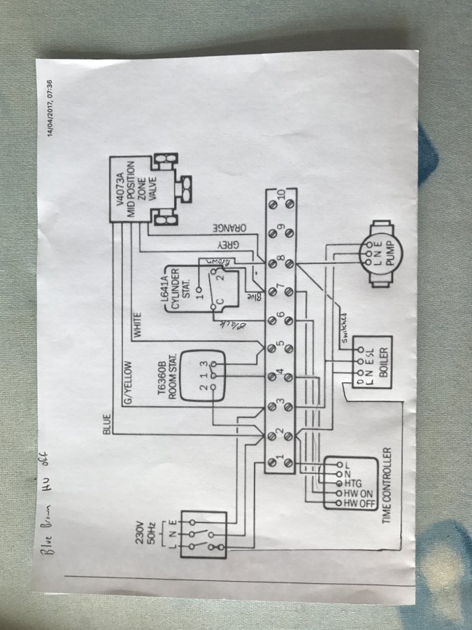

Hi all,
Literally on the brink of divorce I have spent so much time in the cupboard this weekend.
System is y plan, boiler is a potterton netaheat with a live & switched live.
This diagram best shows my set up now.
On the nest
L - main live
N- main neutral
1-
2-jumper from main live
3- 5 (white)
4- 7 (blue/grey)
5- jumper from 2
6- 6 c on cylinder stat
The instructions on the nest conflict this y plan diagram so as it stands I have only had combinations working but not 2 independent controls.
For example
hot water/no heating
Heating/no hot water
Hot water only with heating.
Can someone please tell me how to wire the diagram here to the nest properly.
Sorry for the repetitive thread!
Follow the nest instructions.
AAAAAAAAAAAAAAAAAAARRRRRRRRRRRRRRRRRRRRRRRRRRRRRRRRRRRRRRGGGGGGGGGGGGGGGGGGGGGGGGGGGGGGGGGGGGGGHHHHHHHHHHHHHHHHHHHHHHHHHHHHHHHHHHHHHHHHHHHHHHHHHHHHHHHHHHHHHHHHHHHHHHHHHHHHHHHHHHHHHHHHHHHHHHHHHHHHHHHHHHHHHHHHHHHHHHHHHHHHHHHH
depends on what model of netaheat but most had pump wired directly to the boiler, if not wire the pump live to the boiler switched live.
Providing the connections to the cly stat really are correct, remember the boiler L shown on the diagram is SL to your boiler.
