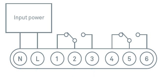

Most programmers contain two* 'change over' switches. One for central heating and one for hot water. Like the example below.
The Nest Heatlink has the same two switches inside:
Meaning that the programmer is removed and the wires from it are connected to the Heatlink terminals that provide the same function.

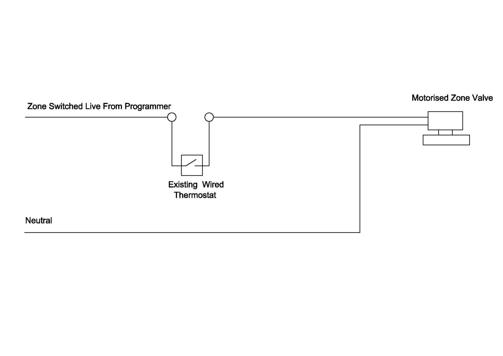

If you have a wired thermostat presently, they are wired to their respective Zone Valve like this:

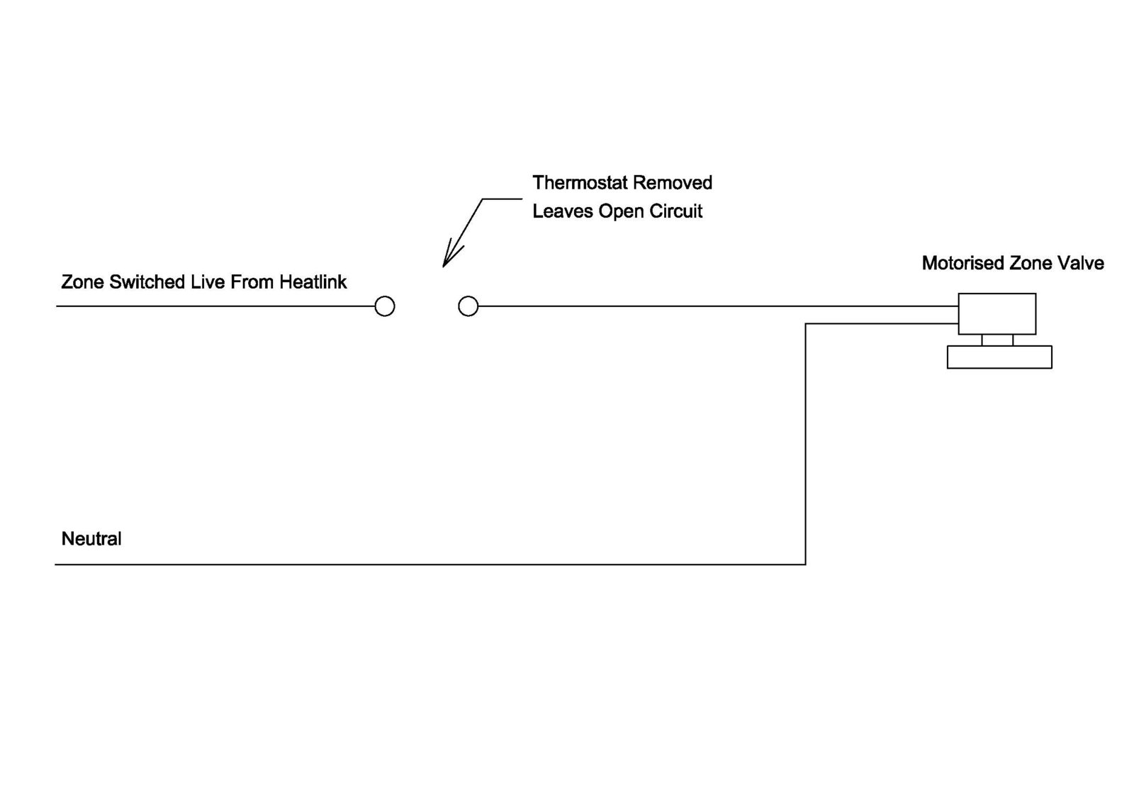

When the Heatlink replaces the existing programmer and the wired thermostat is removed it leaves the wiring 'open circuit' like this:

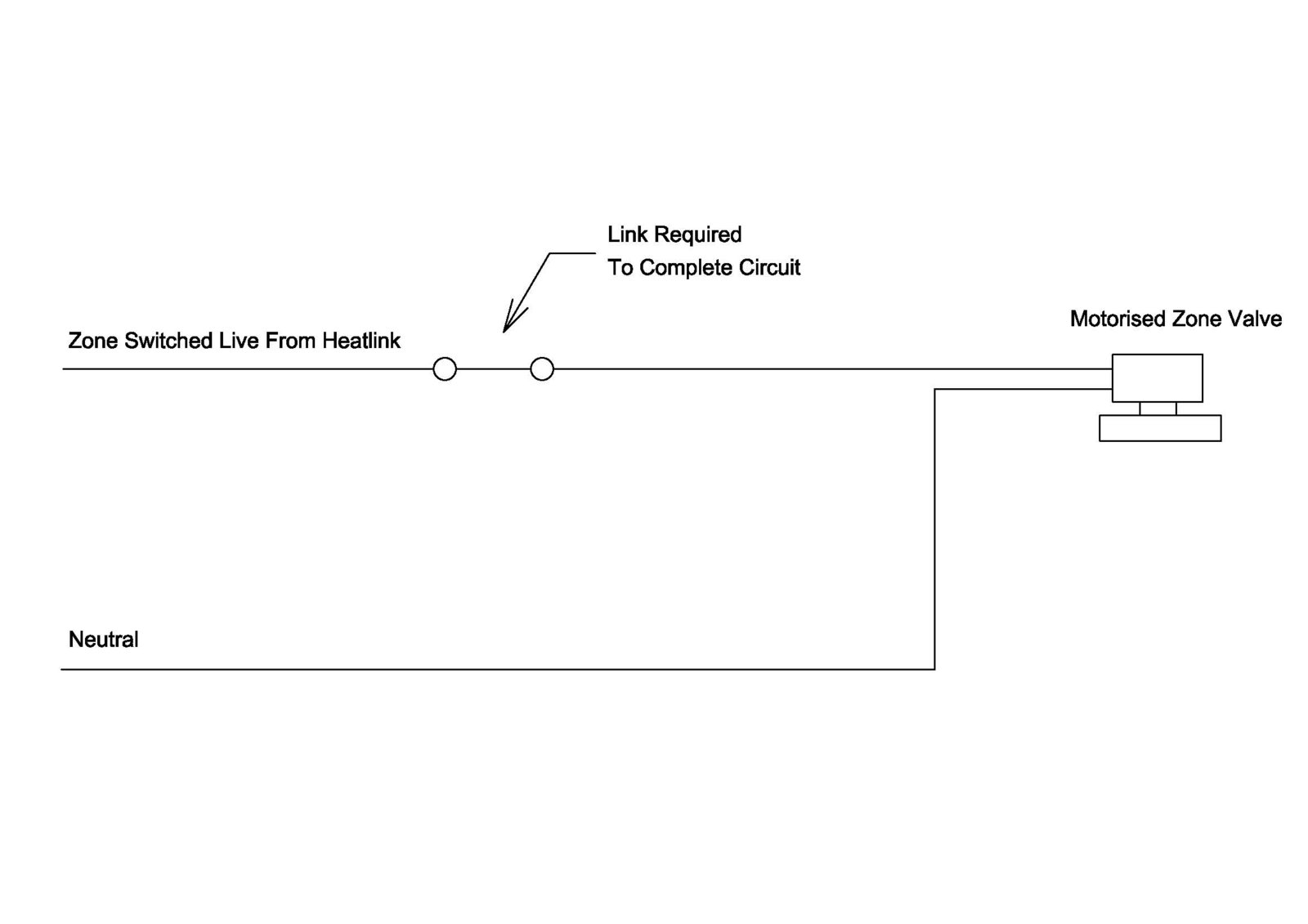

So a link is added to complete the circuit:
