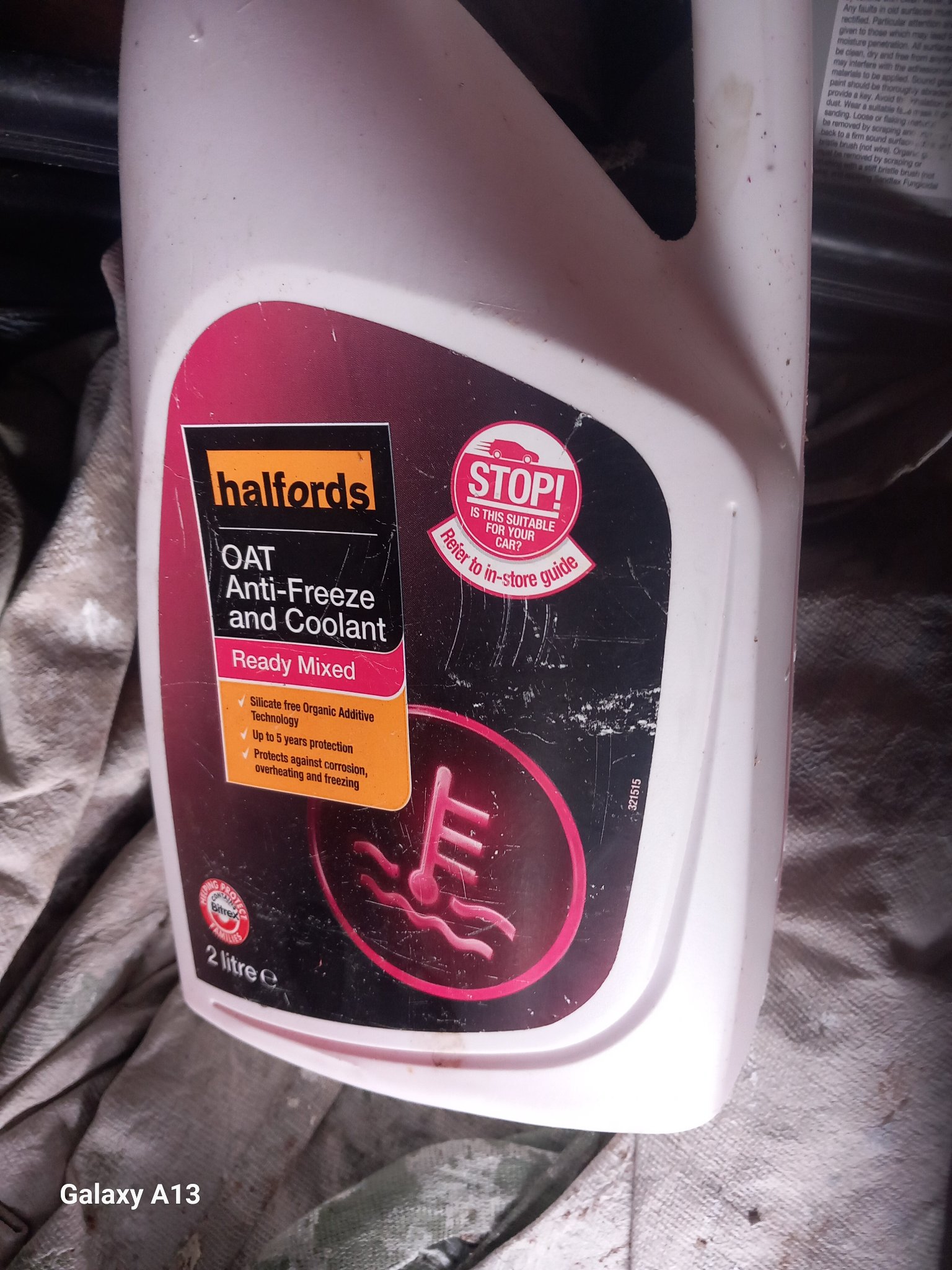

I have topped up header tank with mineral water which I guess should've been distilled or with some anti freeze. Most of water was put in when garage changed the clutch lastcyear. Guess they put in right stuff.
If they put in antifreeze there's a good chance it will be listed on the invoice. Always best to check it's up to strength yourself though before each winter. You can buy a tester.

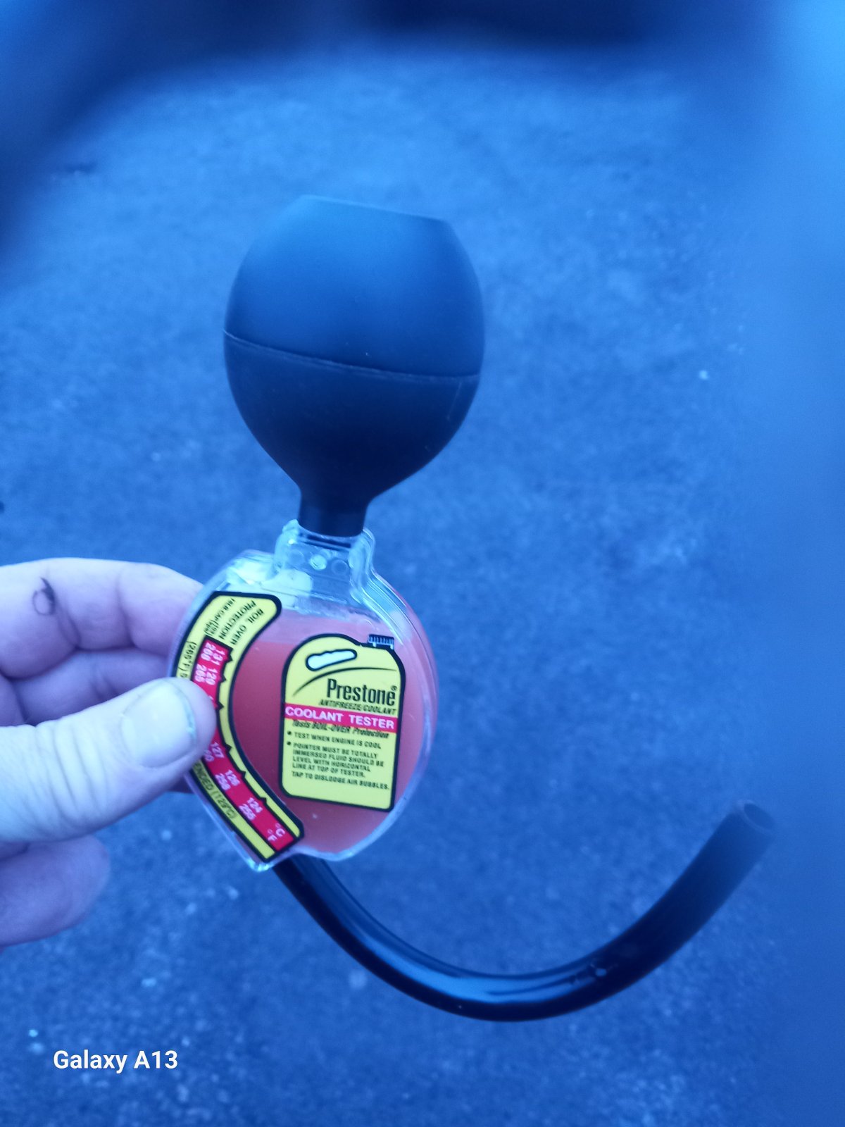

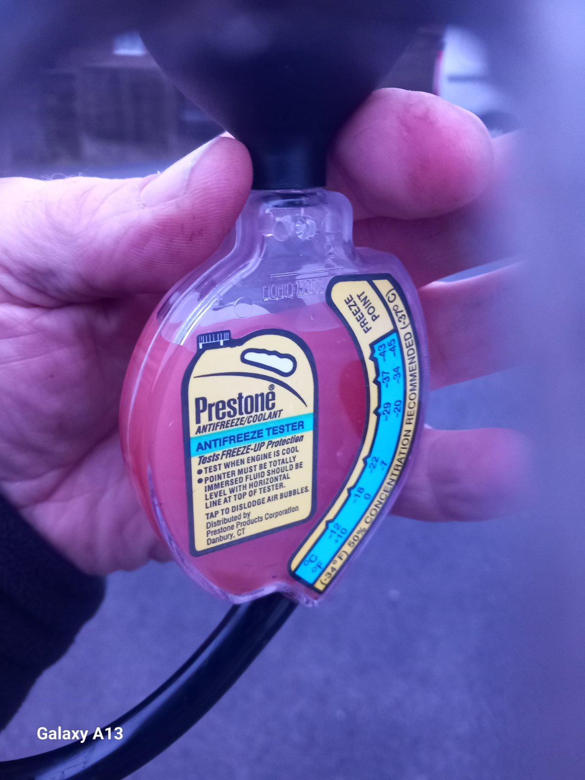

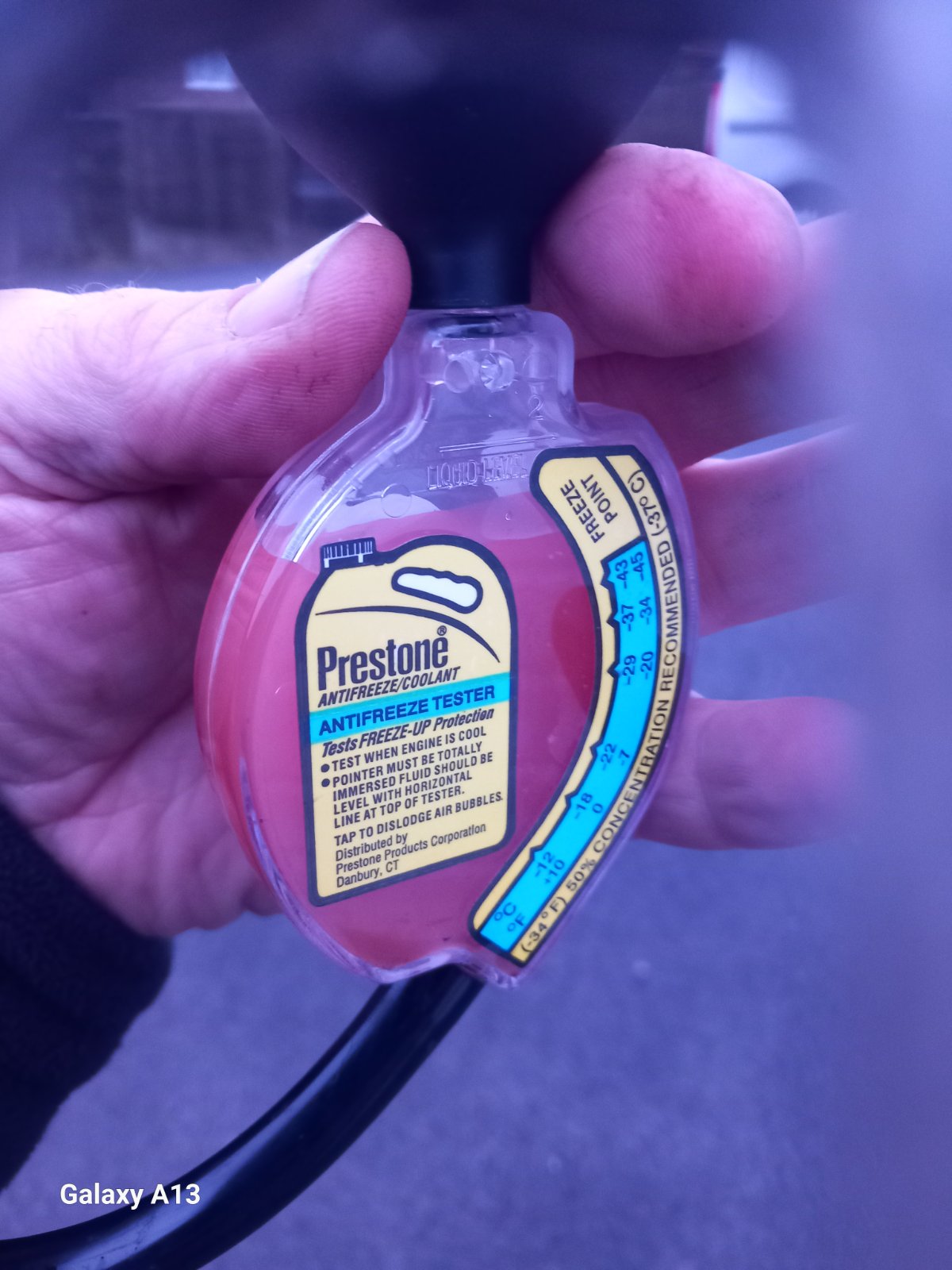

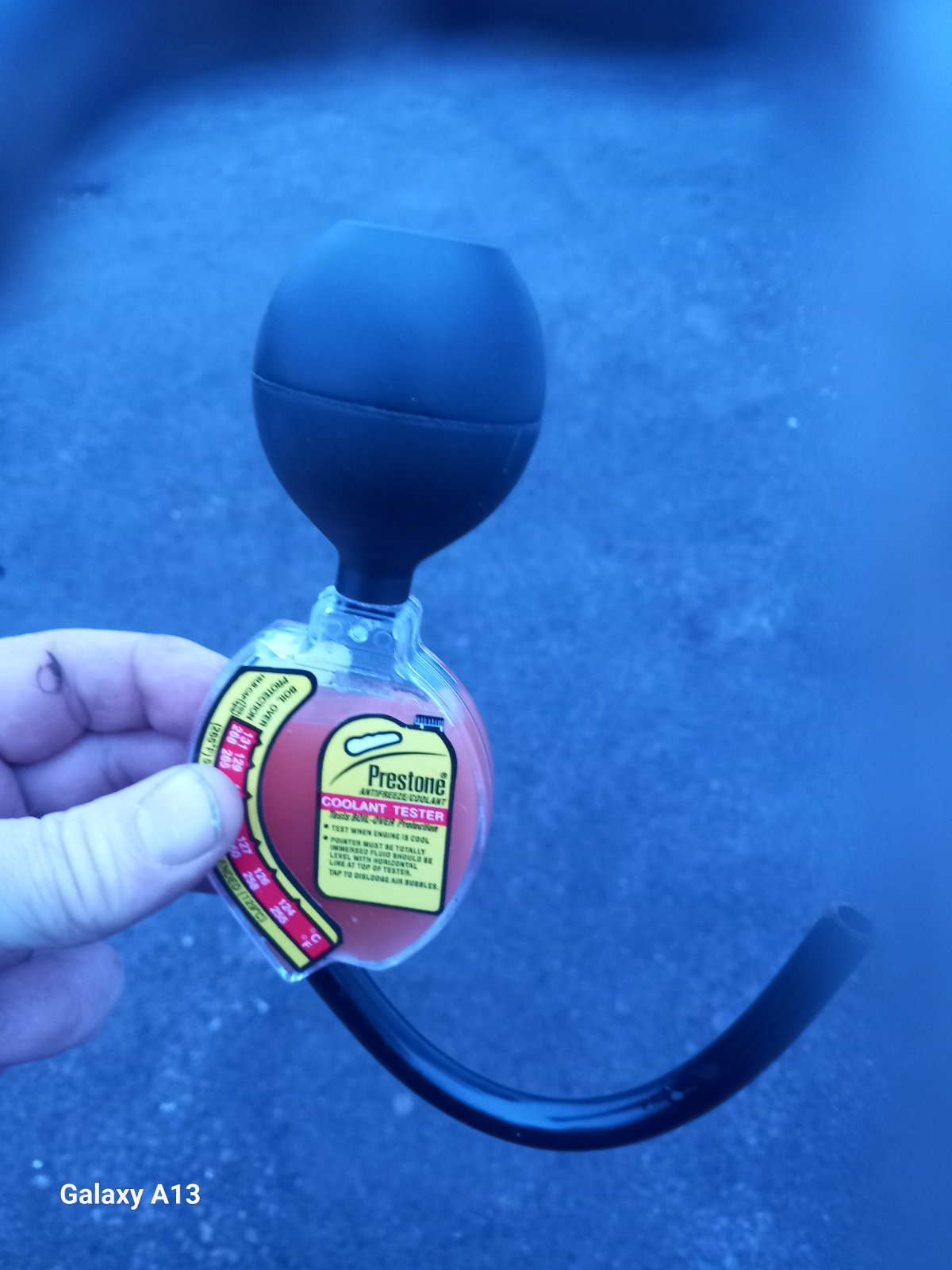

These are cheap:
or abut a tenner in Halfords.
Always best to remember, like oil, antifreeze is cheap. Engines are expensive!!
The fluid taken from header tank is so red can't see the arrow!
