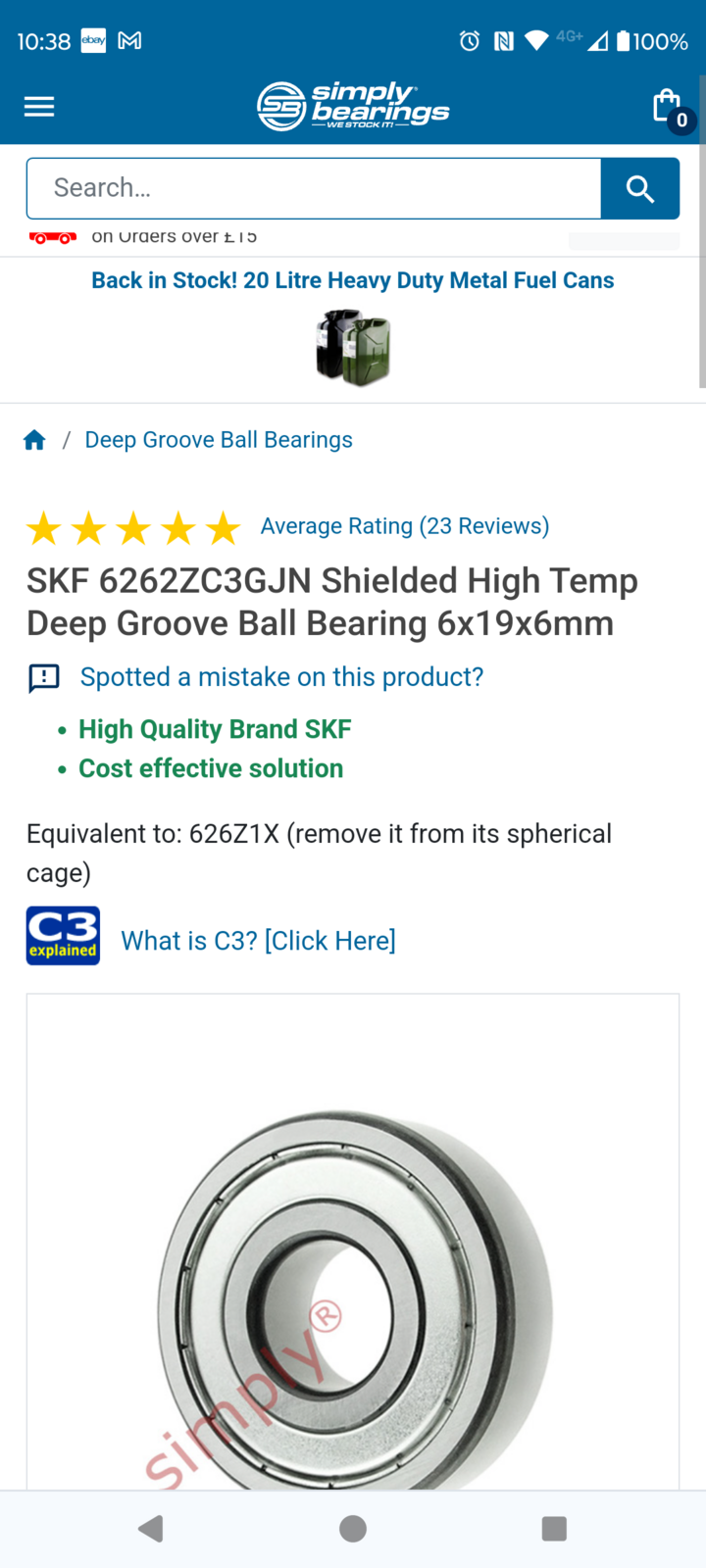

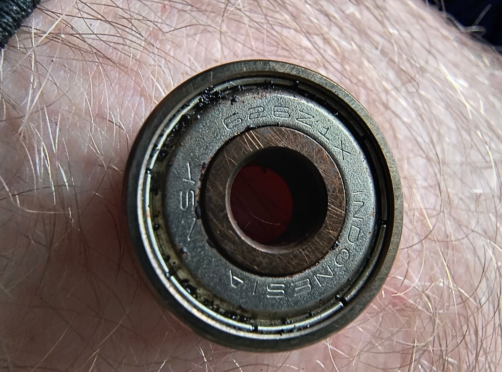

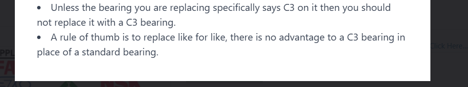

Looking for an equivalent or better replacement for an NSK 626z1x.
For info, it's from an ideal classic boiler fan and they fail due to excessive heat (the fan lives above the heat exchanger).
I use simplybearings.co.uk
Plenty of choice, quick delivery.
That is a quality bearing you have here, but I’d go for a ZZ type which is metal sealed on both sides.....it runs in a pretty inhospitable environment so go for the best one.
John

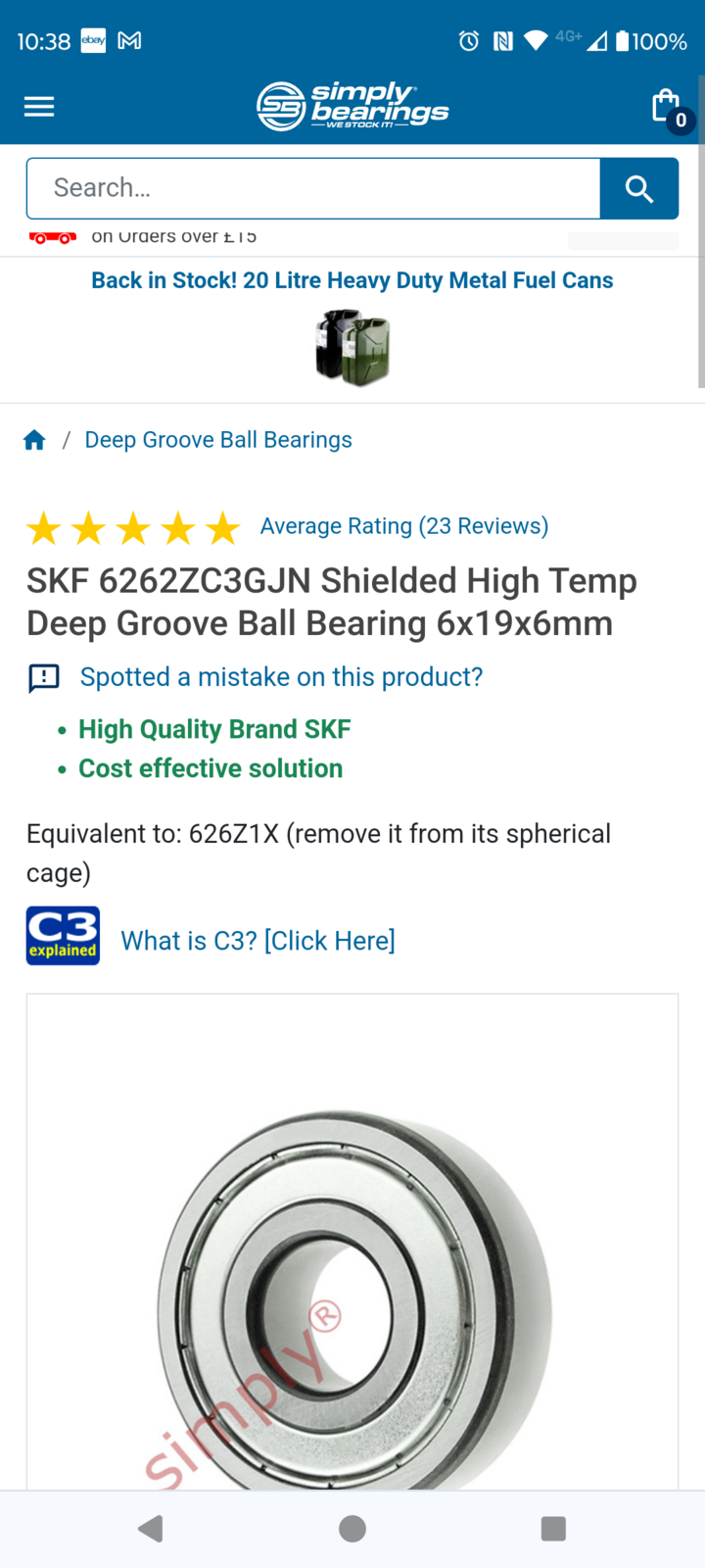

Thanks John, think I'll go for this one:
Not cheap but the fans are hard to get hold of and seriously expensive.

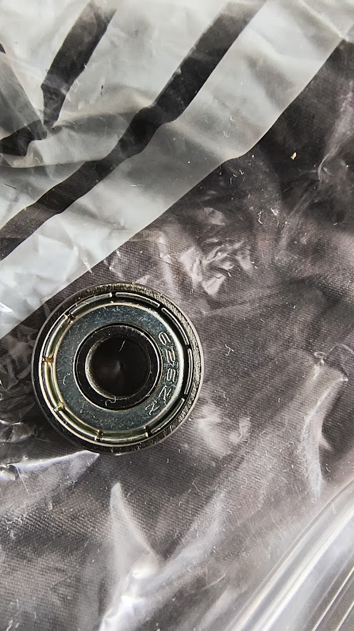

Interesting, info gives the following Last time I replaced bearing in 2016 I used 626ZZ, don't know what make but still running
