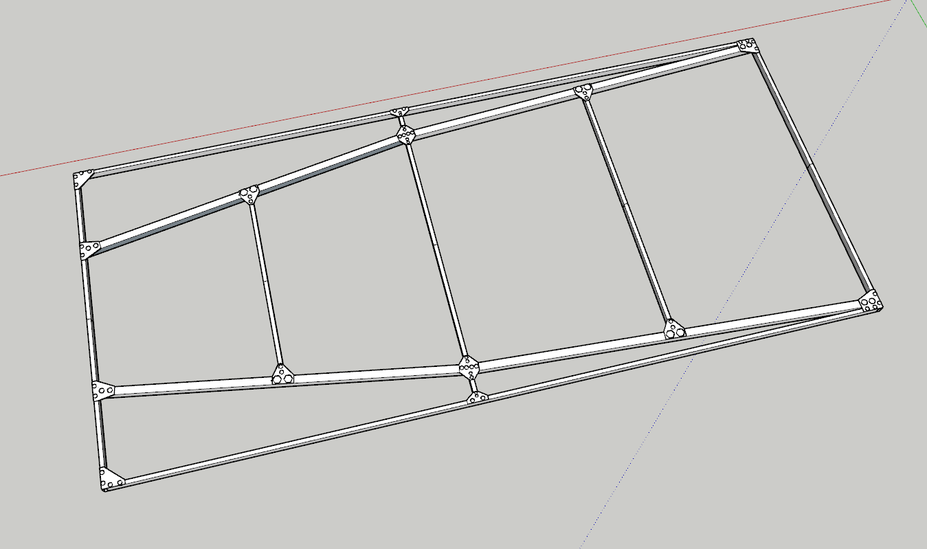

My theory was to use this "bed" to take all the supporting of the car's weight and just to evenly spread the load throughout.
I was also going to use 8ft loading ramps which are self supporting and use "legs" to hold up the rear of the trailer while loading

Using a modern Alko chassis, is I think a really bad idea. They are very lightweight, intended to have some support from the box of the caravan, and because of the light design - Alko prohibit any welding or drilling of the chassis at all, anywhere. To even jack a caravan up with an Alko, special brackets have to be bought and clamped to the chassis, otherwise the chassis will simply bend.
I thought the same when designing the bed, I went through many design considerations before choosing the most simple one (see pic below). but came to the thought of if the bed is able to support the weight of the car +a few 100kg more it should be deemed acceptable enough to be 'safe' and not send a car rolling down the m5 at 60mph
Tow limit is 3500Kg, so seems OK.
The main risk is the max weight the single axle can hold I believe, which is 1300kg.
*Im not trying to prove you wrong btw, your input is very much appreciated, as I have no background in this at all :/
** The pic above isn't the design im going for, just a design i thought about.
I think that can vary, based on the actual chassis model, up to 1600Kg.
Oh brilliant! I'm going to be putting a e46 BMW 3 series which weighs 1400kg
Yes I know 1400 and a 100kg bed is more than 1300 but 15.38461538461538% over weight isn't so bad xD

Alko axles have a plate (rear central area of the tube) stating the capacity. Your completed trailer is likely to weigh 250kg plus empty. Carrying a substantial flat bed and a car weighing 1.4 tonnes on that chassis and axle is dangerous.

Yep the holes where one should be are there, but no Id plate. The long term plan is to gut the car and put another axle in.

Guessing I've got to plonk another axle in!

If I've got this right, you intend putting the car on top of the wheels? Most purpose built car trailers have the bed in between the whee ls. To get the weight as low as possible .
