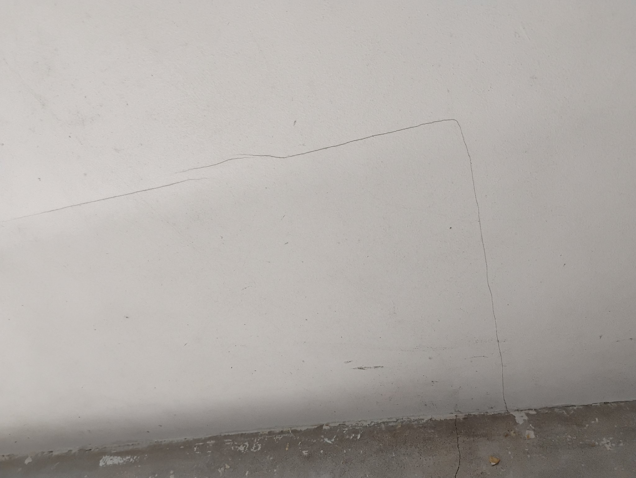

Any idea what's caused these cracks?
5 Feb 2012
318
17
Salisbury

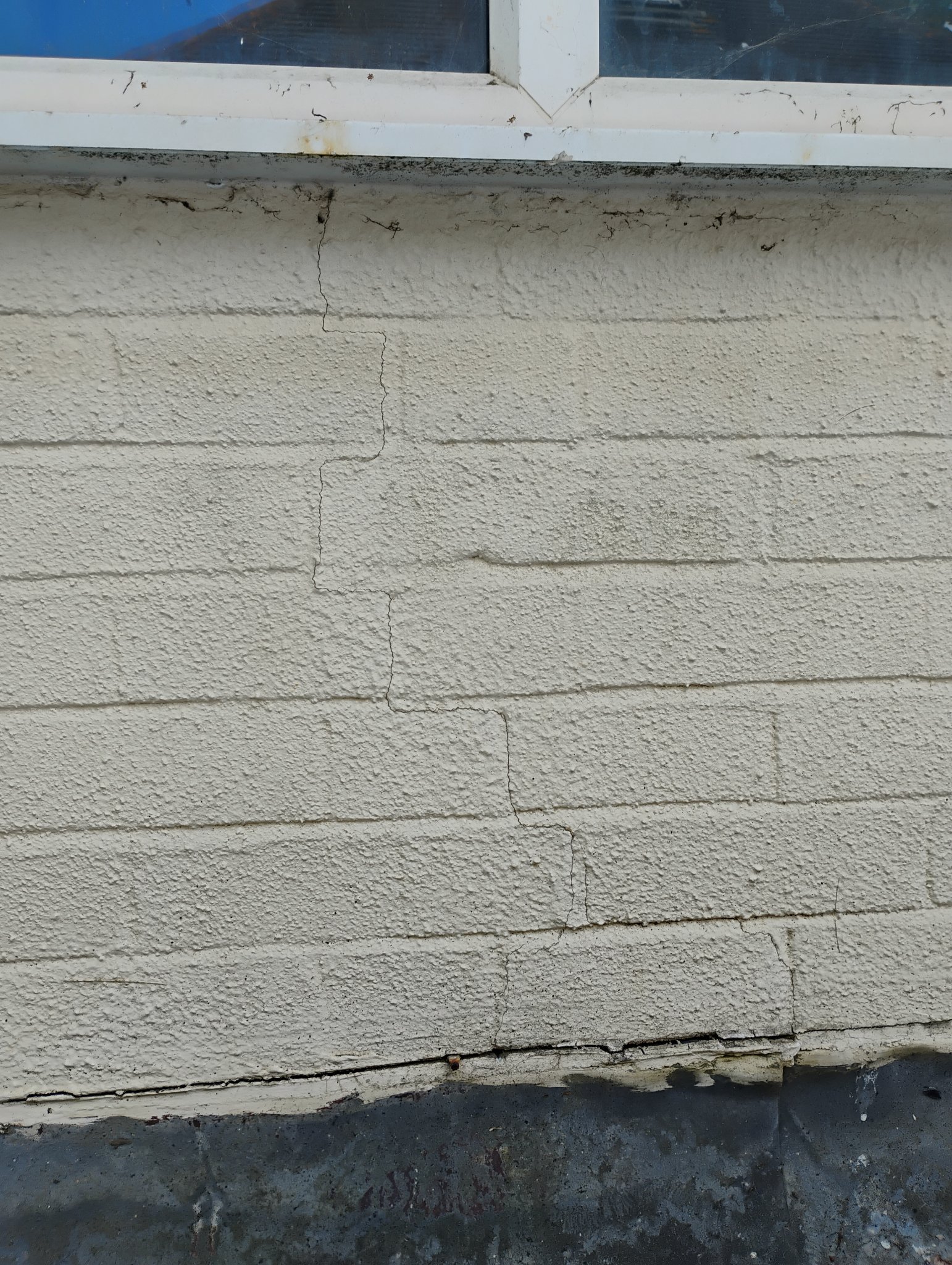

I'll include some photos of cracks we have. There's one above a window that's on a side wall of the house. I only noticed it when stripping wallpaper off. There's also a fine crack on the ceiling just above which I'll hopefully show. And there's another fine one which is on the outside wall just below that window
I don't think I'd have been too bothered by any of them normally but the thing that's giving me runny stools is in a few days there's a side extension being built on that side and there's a padstone going into the wall and the new roof will be sitting onto the wall and the roof above this side of the house. And the plan is to remove the outside skin on that side to get some much needed extra space in the extension.
Any advice what to do please?

When ground swells it moves and there is no weight under the window so it's first to move. Normal.
Dig out the loose above window and have a look

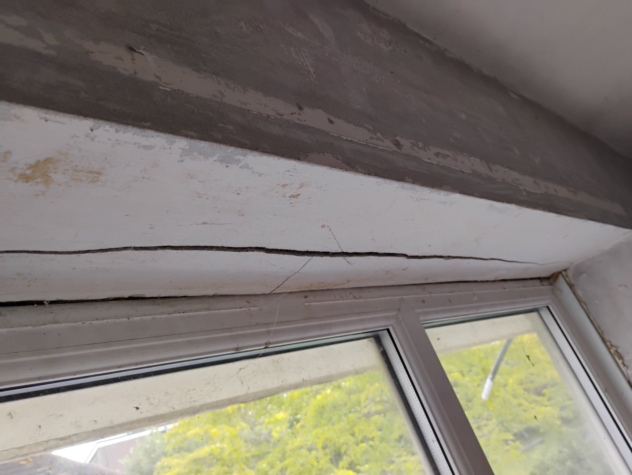

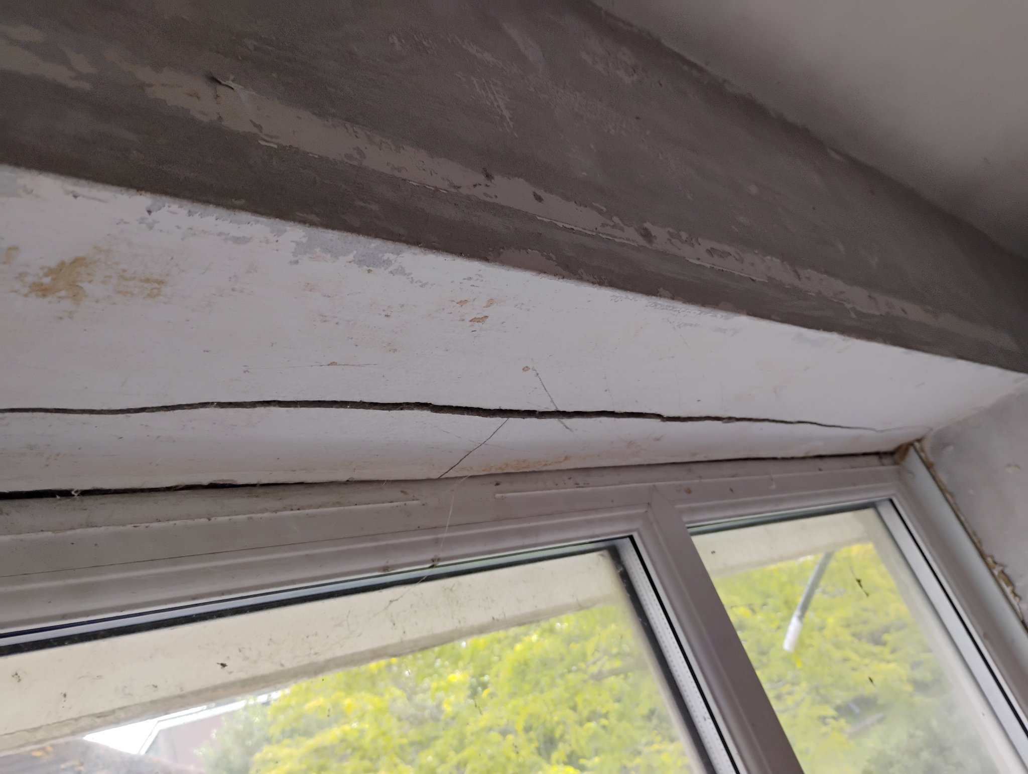

Any advice what to do please?View attachment 416321
Window flexes - lintel doesn't - window fitter adhesive pulls on plaster.
Its common and related to different materials (lintels, cavity fill) and ever so slight different natural movement. Not a structural issue

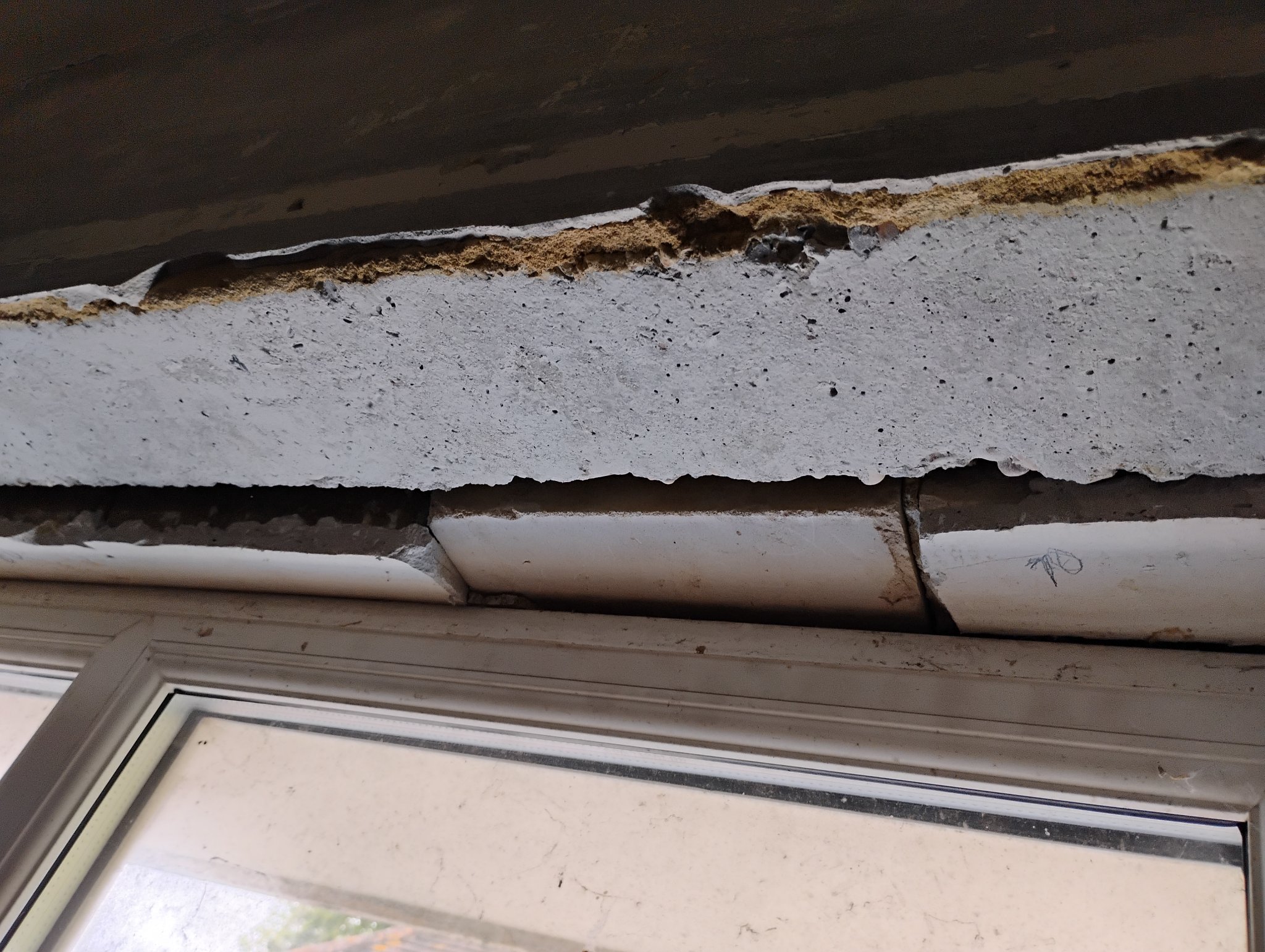

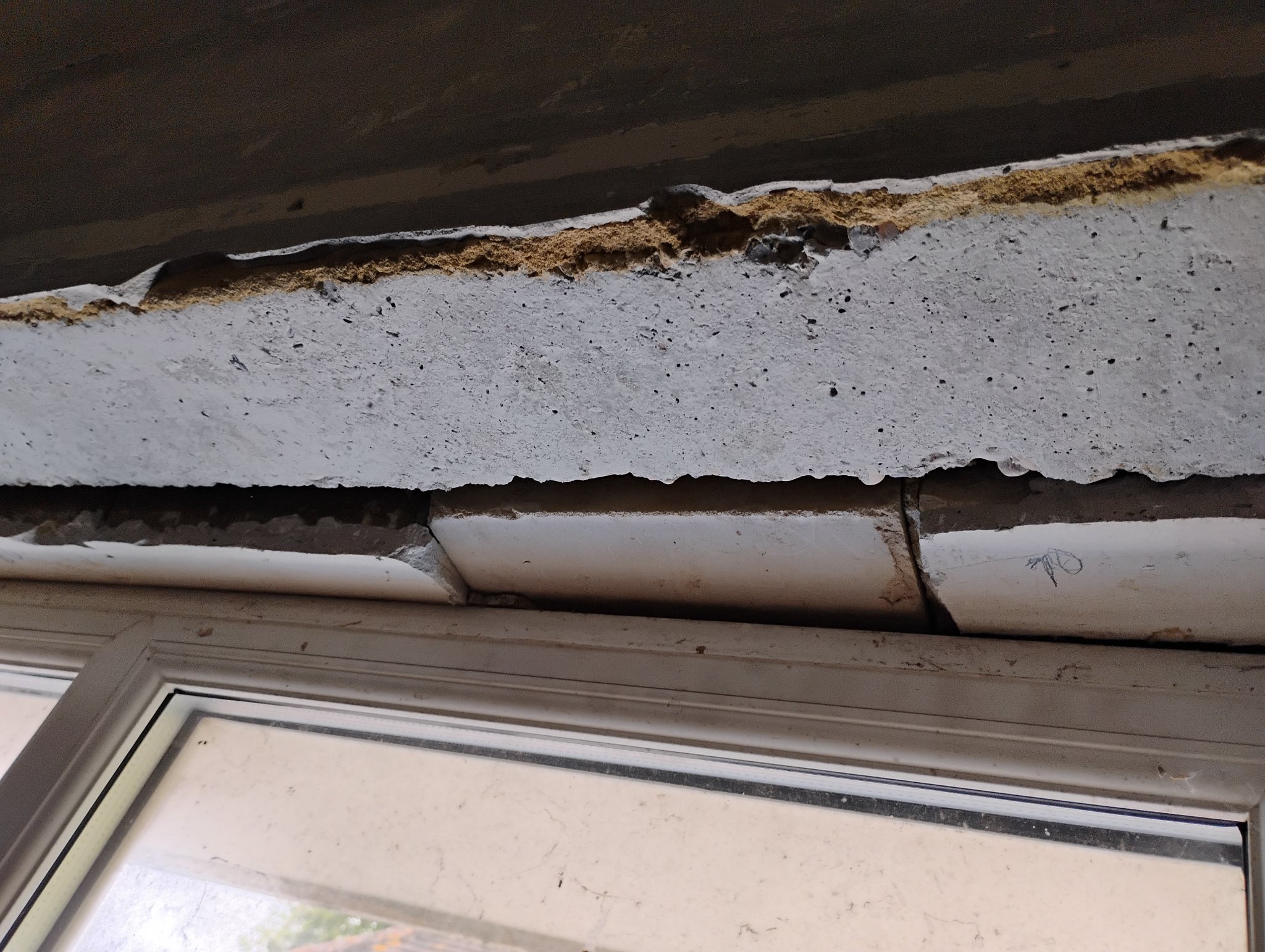

Thanks gents. I removed some plaster above the window and there was a course of bricks layed on the window frame overhanging to bridge the cavity with I assume just the soffit sitting on top of them. Not surprised the plaster couldn't cope. Thanks for your help.
Thanks gents. I removed some plaster above the window and there was a course of bricks layed on the window frame overhanging to bridge the cavity with I assume just the soffit sitting on top of them. Not surprised the plaster couldn't cope. Thanks for your help.View attachment 416402
No outside lintel. Even though it's only one course, it should still have a lintel. Are the bricks actually visible from outside?
No the soffit touches the top of the window frame so hides it.
It seems to have been common practice in this area. My last place had no lintels over the outside skin on all windows even ground floor ones. Just had expanded metal above the first course .
The bricks serve no purpose.
I've seen this problem a few times. When first built, instead of using a 6 inch lintel to bridge the cavity they often used a 4 inch lintel and stuck a course of bricks over the timber window. When new plastic windows were installed the brickwork fell out. The window fitters used to just balance them back on top of the frame and then it was made good.
