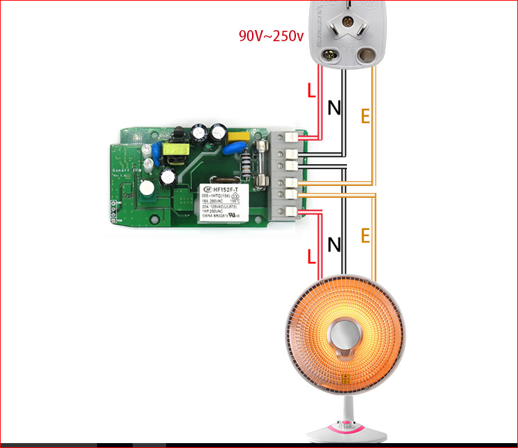

So I've moved into a house that doesn't have a thermostat wired in to the boiler. I have a Voker Linea HE Combi boiler. All we do at the moment is turn the boiler from summer mode (ie no heat) to winter mode. Is there any reason I can't leave it on winter mode and wire in a Sonoff POW to complete the circuit and turn this mode on and off?

I plan to wire it in place of the thermostat, like this.

no reason why you cant the thermostat connections from the boiler are just a switch
That's pretty much my understanding. I can't see that the connection would be more than the 3500w the Sonoff POW can handle as well.
As far as I can tell the sonoff needs 240vac to work so you cant interrupt the thermostat (its not carrying 240vac) and you cant use it on the mains as it would kill the boiler ie no hot water, save up and buy a nest or hive.
The site states it ranges from 90 - 240, and there are live and neutrals I can use. Am I just being really thick here (please feel free to say so).
What live and neutrals do you intend to use ?
Right, after some reading I get you. Could I not use a battery power RF switch then for Volt-Free switching?

Sorry just looked at the wiring diagram , no you cant use this, all it does is switch N&L you need something that has a 240 supply but voltage free switching
