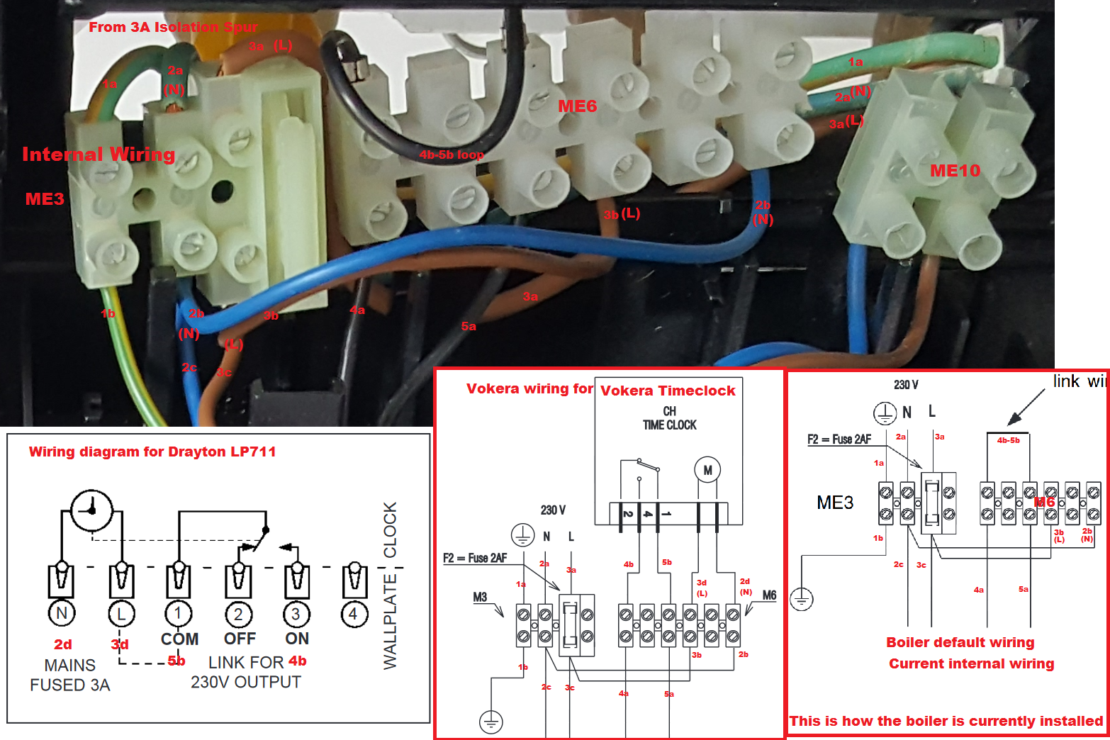

Hi all,
I was hoping someone could just confirm that I have the right wiring setup to let me install a Drayton LP711.
My boiler is a combi Vokera Linea 28HE. It currently does not have a time clock. To turn the heating on I select Winter in the mode selector. Hot water is on demand always on, so single channel.
I just wanted to confirm that I have worked out the correct wiring from the diagrams from both manufactures. In my image I have labelled all the wires to make it easier for me to understand.
I want to check that from LP711
N connects to 2b/d
L connects to 3b/d
1 (COM) connects to 5a/b
3 (ON) connects to 4a/b
L & 1 (COM) lopped/linked together

OK
You need two cables
One 3- core cable with live, neutral and earth from the boiler's mains input (1a, 1b and 1c). This connects to the L and N at teh LP711. You'll need a terminal block to 'park' the earth.
Then you need another 3-core cable from 4b and 5b on the boiler (remove the link!) to connect to 1 and 3 on the LP711
Do not install a link between L and 1 on the LP711.
You must earth this cable at both ends
EDIT. A proper heating engineer would use a single 5-core flex, but I expect you don't have a length of that in your garage?....so two lengths of 3 core flex will do you.
if the timer backplate is fixed to the boiler panel, I suppose it could be wired in single cores.
Does that mean 1b, 2c and 3c are disconnected? Or that I conenct to 2b & 3b?
Sorry I'm struggling to visulise.
If you disconnect them you will not have any power to the boiler!
Leave them connected and add the new wire to take power also to the new timer.
Why don't you fit a timer/thermostat instead of just a timer ?
Hi Picasso, I live in a small studio flat so effectly a single box. All the rads have TRVs on them so I just set the temp at the boiler and on the values. So I didnt really feel the need for a thermostat.
Okay cool, so I need to get another cord them for the earth as I currently only have 4 cores. Thanks.
You would be better fitting a stat rather than a timer, trvs are not a good way of controlling a boiler.

Excllent. Thanks for the info.
I have my 4 core for my L N E, and have been given a 2 core for my COM and ON, so that'll be my evening project.
