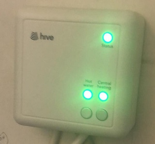

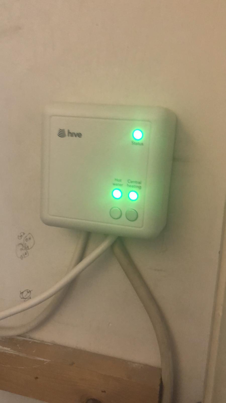

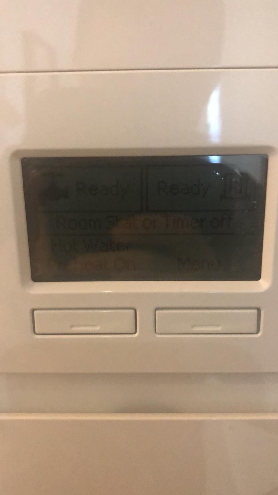

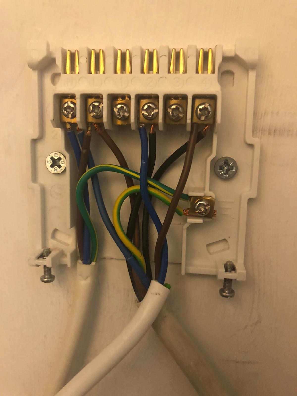

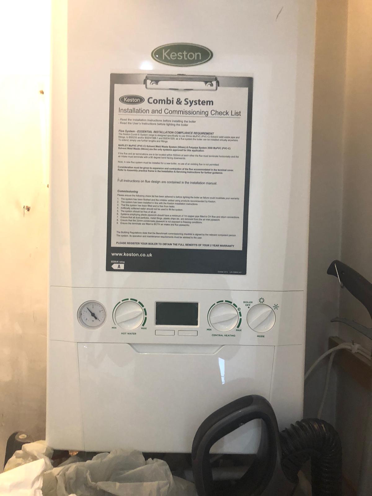

Hi everyone
I recently had a new boiler installed (Keston C30 Combi) with the Hive Active Heating Thermostat. I haven't used the heating till today as it was summer so I switched my boiler from summer mode to winter mode.
When I turn my heating up on my thermostat it says its turn on and heating but the boiler hasn't fired up. Clueless on what seems to be the problem.
I've attached reference images of the wiring and thermostat. Please help!

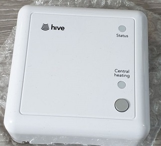

Most combi boilers provide instantaneous hot water when a tap is opened, so they don't have a hot water cylinder. In this case the single channel Hive as per below is used just for the central heating.
Your photo below shows a dual channel Hive with central heating and hot water which is used for systems with a hot water cylinder. Whilst it's not impossible to have a hot water cylinder connected to a combi, it would be very unusual. Do you?
Then we come to the wiring, for a combi with a single channel Hive terminals 1 and 3 would be used, for a dual channel Hive with stored hot water terminals 3 and 4 would be used, your wiring is connected to 2 and 4 so corresponds to neither, and terminal 2 (heating off) is never used in any UK boiler installation.
Time to get the installer back to sort out his mess. How did he manage to commission the boiler?
Hi, no I don't just standard combi boiler! Ouch, so if I change the wiring will the CH work? Or is it absolutely required for me to go out and get a new single-channel receiver?
It is possible to configure the wiring to work, but you will have to forget any HW control settings on your Hive, get your installer back they have messed up
As @ianmcd says, you can use a dual channel Hive with a combi, it will work, but it's a bit of a bodge as the hot water control facility will be visible on the app and receiver but won't actually be doing anything, so you should get the installer back.
Because this is a new boiler installation you shouldn't have to do anything. Insist that the installer change the Hive for the correct version and rectify their appalling workmanship. Even if the Hive was changed for a Single Channel version the wiring is still wrong and needs to be rectified, and the quality is poor on so many levels. There's a blue wire (blue wire indicates neutral) being used as a live in terminal 2, those flexible cables don't look as if there are any cable clamps or clips to hold them in place and prevent strain on the terminals, there is too much copper exposed, and the sheath should extend into the backplate so the cores aren't visible when the hive receiver is in place.
I assume the boiler was installed legally by a Registered Gas Installer (Gas Safe) in which case if they don't comply with your request, show them this thread and inform them that you will inform Gas Safe of their terrible work. Apart from it being the wrong device and incorrectly installed, there is no way that the heating could be tested and the boiler properly commissioned.

For a combi the number of wires here is also a puzzle. If the fused spur supplied the mains supply directly to the boiler, I would use only 3 wires for 230V switching and 4 wires if using 24v switching, yet here we have 8 wires!! Something just isn't adding up....and the OP's has gone a bit quiet.....
It's also a puzzle why they've used a crappy on/off Hive on an OpenTherm boiler...
