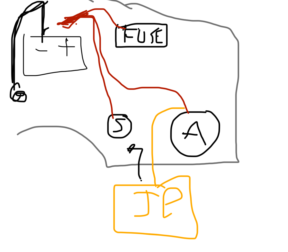

Any suggestions how to break in to my own car?
At a guess, I'd say he had opened the bonnet, locked the doors, disconnected the battery and then shut the bonnet.
Edit: Snap! :ROFLMAO:
If you have a tow socket, you can power it up through that as long as your disconnected live battery terminal is not touching earth!
Jack the car up, put on axle stands and get a jump pack connected to the live wire to the starter and an earth. This will give power to the car battery and you should be able to use the remote.
Andy
Unfortunately the battery isn't connected.
Good call! Or, if the OP could gain access to the alternator, or starter motor terminals, apply +12 to the main terminal of either of those..
It doesn't matter. The jump pack will cause voltage to be applied at all the same points as the "proper" battery normally does
In essence by connecting a jump pack to the thick wire on the starter, or the thick wire on the alternator, the jump pack will become the "proper" battery of the car, which allows you to unlock the doors, open the bonnet and reconnect the proper battery. Any easily accessible point that is directly connected to the positive terminal of the battery will work for this; the starter and alternator are typically lower down in the engine bay and more easily accessible from underneath by jacking the car
The wire you use on the jump pack doesn't need to be thick; you aren't going to start the car with it. It may thus be easier for you to clamp the jump pack negative to somewhere metal on the engine, clamp the jump pack positive to a small flexible wire say a metre long, and then just hold the other end of the thin wire against the starter/alternator big terminal while you push on the central locking fob

Thanks for that. Hopefully I can see the alternator/starter from underneath, and see the wires leading to them.
I've got some twin and earth I presume would be ok.
Would a car battery charger work in place of a jump pack? I mean the ones you would leave them charging for hours.
No, use a proper battery, or a jump pack - but make absolutely sure you get the polarity correct. Negative to body/engine.
A charger, can be of two types, neither much use. The older type, will put anything up to 20v volts out, and could wreck the car's electronics. The more modern type, will not output any current, unless they see a battery connected.
Honestly, 8 AA batteries in series would probably provide enough juice to open the central locking, but perhaps you have a mate who would call round so you can connect a length of twin and earth up to his battery
