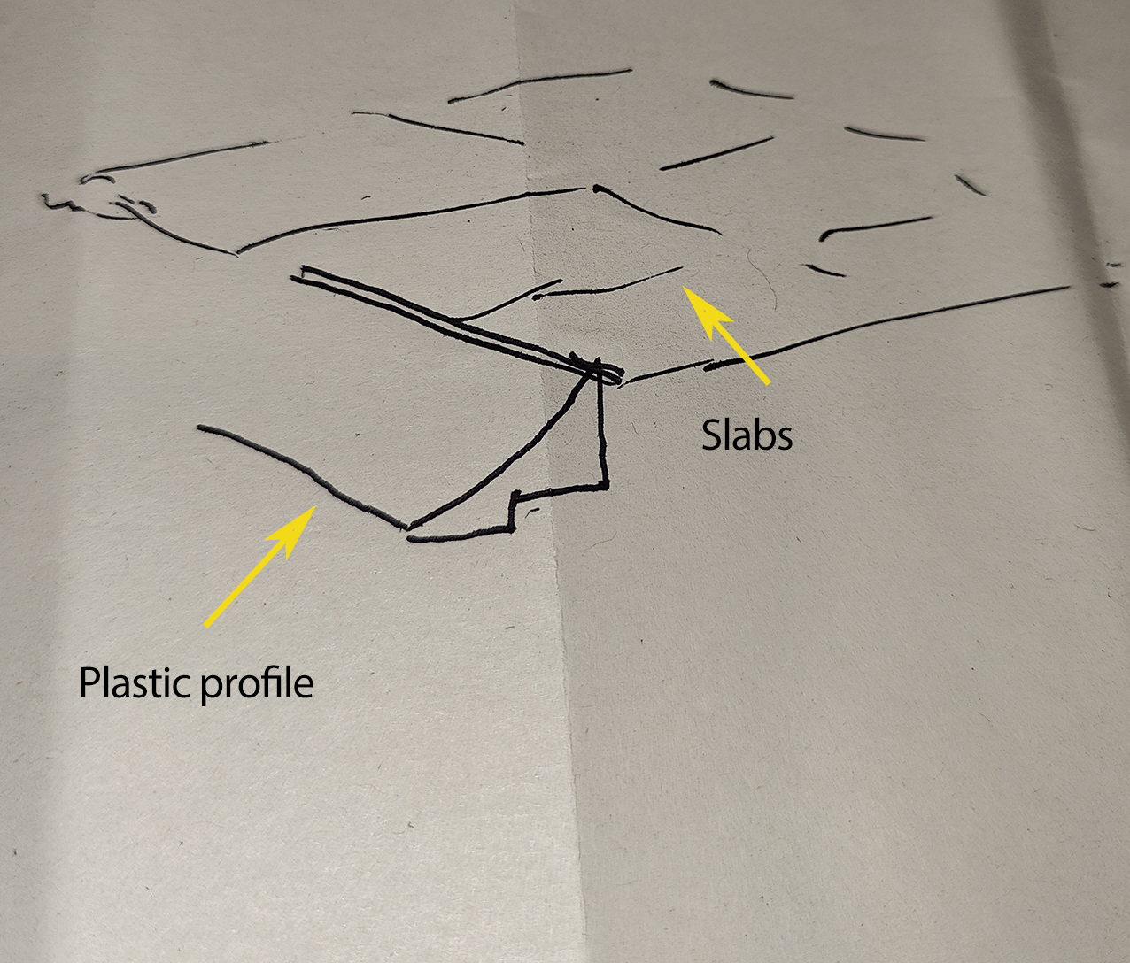

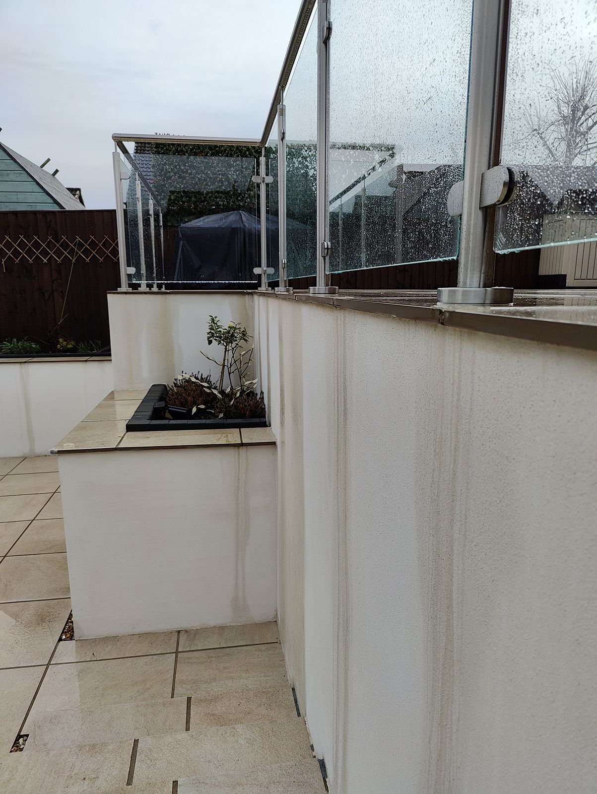

Hi all,
When we got our garden done last year we had major issues with the porcelain slabs. I won't bore you with the details but, basically, they needed lifting and re-laying which has resulted in us only having a small over-hang. Also the water runs through the gaps between the tiles. This leads to dirty run-off water leaving stains on the walls.
I wondered if there was any solutions that anyone had heard of to fix this?
I was thinking of something profiled that I could glue (or screw) on to the wall, underneath the current slab over-hang - like this?
Anyone heard of anything like that? Or anyone have any other suggestions for how I can sort this?
Thanks :)
You could look at aluminium profiles?
Or even Hardwood strips?
Good idea! I'll look into it and see if I can find anything suitable
You might be able to use this .
uPVC Gutter Drip Trim for EPDM​
Thanks! I've just Googled them but I'm not sure they are the right profile. Will keep looking for something similar though.

Paint the wall the same colour as the water stains? Unless the wall has been constructed so as to not let water through from the rear, the render/paint/both will likely fail a some point anway. Any flashing or trim you add will likely look a bit rubbish. I'd just repaint the wall once a year instead if it really bothers you.
I'd ideally like white trim. I don't think it would look too bad. Certainly happy to live with the trim rather than the dirt/staining on the wall. The water in the photo isn't really an issue - that wall has already been cleaned - it's crap from the trees at the back that runs down the wall. Thanks :)
What about an aluminum U channel, in it's raw state it would just go a dull grey, bonded to the render I guess with some clear silicone. I think anything that sticks out beyond the edge of the slabs will look awful. The gaps in the slabs need re-pointing.
eg https://www.metals4u.co.uk/materials/aluminium/aluminium-channel
Yep, that's not a bad idea. I originally thought of some white plastic trunking. I think if I mounted the U-channel upside down and deformed it slightly so it was sloping downwards from the wall then the furthest face would act to make sure the water/etc dripped off the end.... thanks :)
It would be a waste of time. But if you must do it, try this - black:tile, blue:something plastic or wood, red:hybrid polymer sealant
@uptown47 There are cheaper suppliers than that no doubt btw. I can't see you being able to deform the channel very easily but why would you need to?
I was just thinking of mounting the U-channel upside down and deforming it so it sloped away from the slabs (in black) and the water/crap would run down the back of the U-channel and drip off the end at a safe distance away from the wall :)
