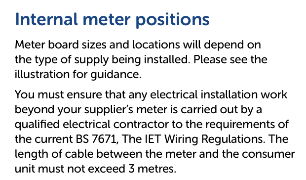

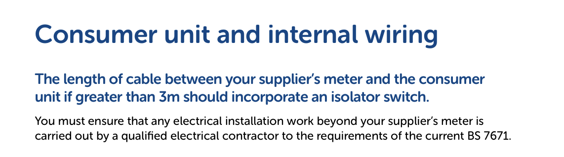

Interesting meter tail stuff. i've been having a look at some documents. My DNO is SSEN. The supply agreement has no mention of any length restriction. But some other documents do. eg the Service alterations guide
mentions it twice
and (very interesting)
Note, this specifies an isolator SWITCH, no mention of a fuse!
